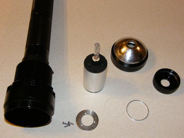

I’ll take some pictures of the sacer and the very thin one that goes inside the outer aluminum spacer.
Here’s a few photos.
Those 2 spacers are directly in front of the reflector and bezel.
That silver washer with the 3 screws by it is what holds the bulb and ballast in the head of the tube. That washer with the 3 screws sits inside of the cutout lip on the 2nd picture of the inside of head. You screw the 3 screw into the top of ballast where the holes are on it.
If I understand this right, have you tried placing the spacer before the washer with 3 screws?
Yes.
The washer(s) will actually fit on the inside of the tube before the ballast and come to a stop at the tip of tube just underneath coutout lip. There is a cutout section on the inside of tube directly underneath the cutout for the 3 holed washer. I have tried leaving the washer out. That don’t work. I have tried leaving the very thin washer ring out. I put the washer directly undeneath the 3 hole spacer on top of the cutout in the head and that don’t work. I put the spacer at the end of battery before the tailcap. Nothing seems to work. I guess I’m gonna have to try something else or buy another light altogether which totally sucks. I have no place to send this light back to. No address was in the manual that came with it. I guess I’m gonna have to eat this one.

Ok I finally fixed it. I took the 85watt bulb/ballast 6000k bul and put it in the YEZL with the washer and then put the 8700mah battery and it worked like a charm. So now all I got to do is get another 8700mah battery pack. I have one on order already. That’ if I don’t get scammed. So now I will have 2 85watt HID’s.
Glad/Sad to hear you got it working again. ;)
I did have to put the aluminum washer before the ballast. Now all 3 modes work on it. I’m ecstatic. Finally.
