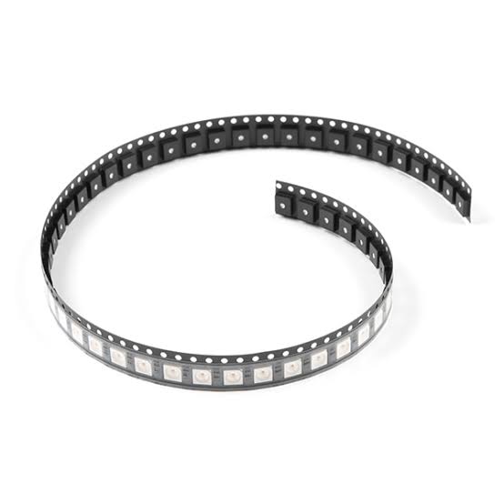

when it arrived home, it only has “Lot Number” info.
yes literally from the same reel because they come in a package like the one shown below

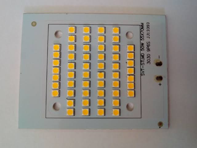

make a high cri floodlight/high bay lighting. i will just desolder these and replace them with Sunlike. I need the LEDs that I ordered to have at least the same forward voltage since the PCB is series-parallel connected :grin: (picture for reference only)
