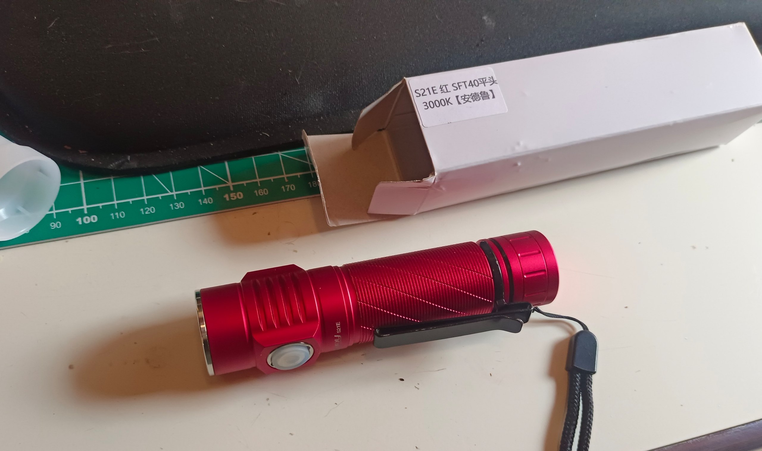

Thanks everyone, I’ve just ordered an S21E in red (his favorite color) with SFT40 in 3000k and a big a$$ battery with 6500mAh.

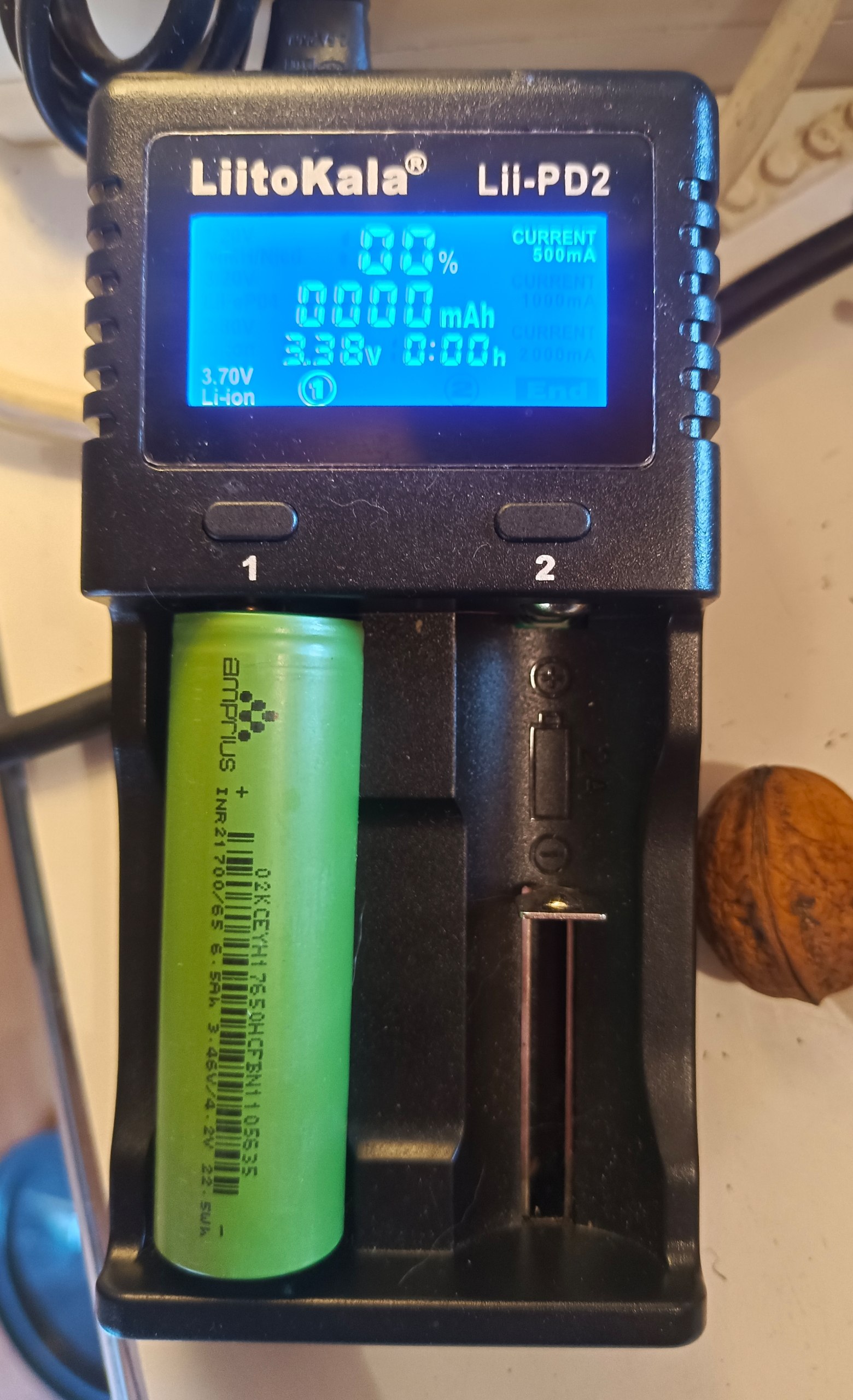

It arrived now, it’s beautiful!
However, the battery…
Will it be fine? I know you shouldn’t fully drain LI-Ion cells, hence I ask.
I’ve already contacted Simon asking the same, but I would like to know it earlier
Edit: Simon was faster than the forum! He made me notice that 0% is incorrect as it has 3.38V.
From my RC experience, 18650 cells shouldn’t go lower than 3.2V to maintain good health, so here we are good.
I think those Amprius cells can be discharged down to 2,5V and their nominal voltage is 3,46V which is lower than typical 3,6-3,7V. 3,38V is perfectly fine.

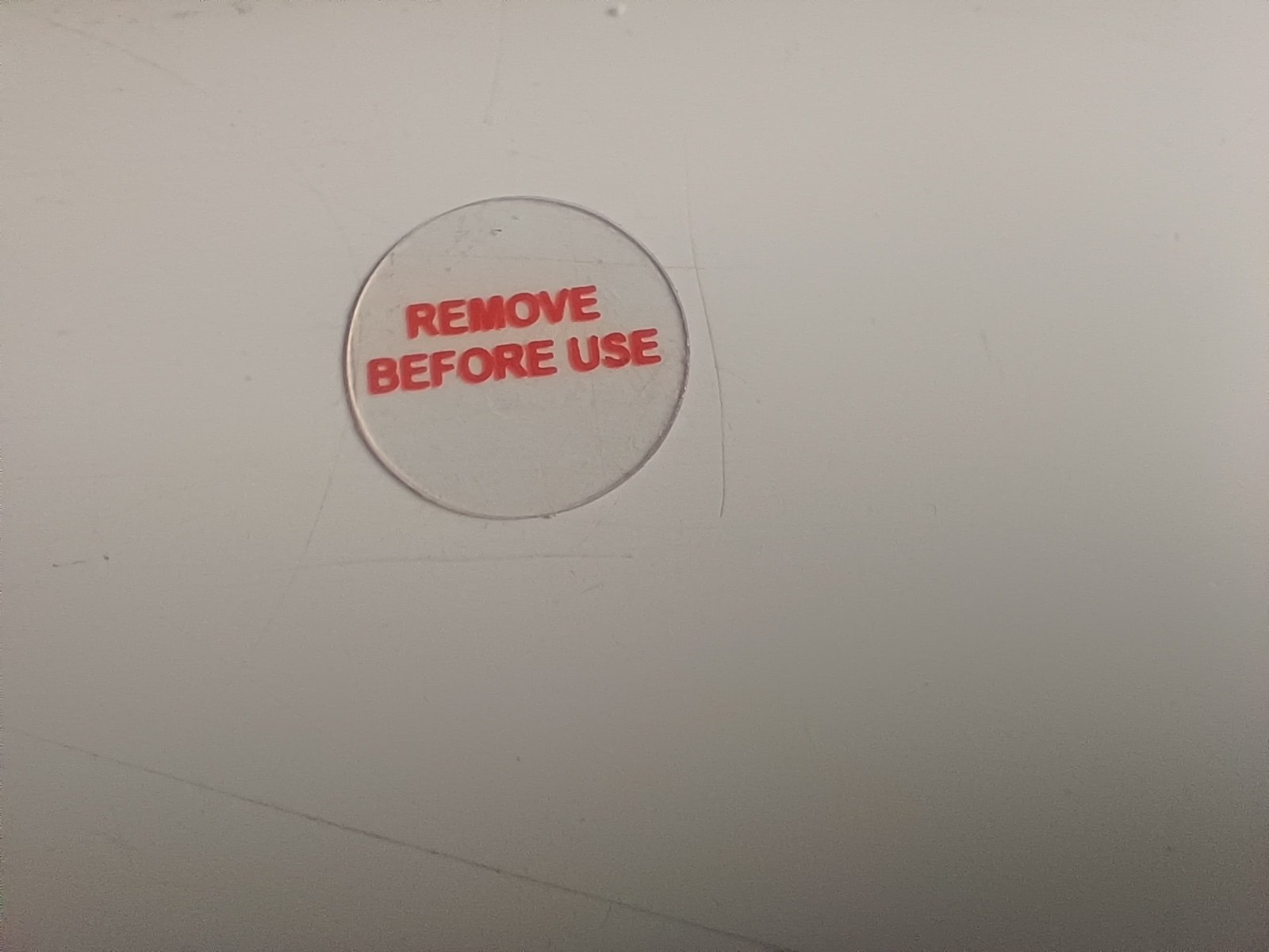

Thanks! Well, at 3.38V the light wasn’t firing up, though. So I guess it is rather useless to go down that much :grinning_face_with_smiling_eyes:
Convoy and many other manufacturers put a little clear plastic disc between the tail end of the battery and the rear spring. (For shipping purposes). That’s why it wasn’t working. If you look in the area where you took the battery out you’ll probably find that disc on the table or floor.
You may have to use your son’s new flashlight to find it.
With a new light it doesn’t hurt to go into battery voltages that low just to see what the light does but in normal use you should definitely consider charging at 3.7v.
This guy? It was on the table and thought it came off the lens :grinning_face_with_smiling_eyes:

If I’m not mistaken, you get a 3.0V warning by blink and the light cuts the power at 2.8V.
