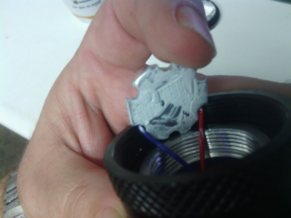

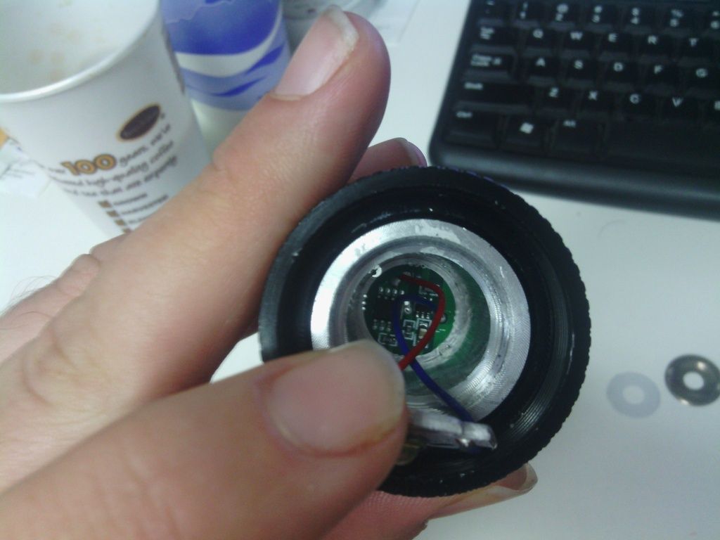

There's not many people owning or even modding Surefire's over here at BLF (the price/performance ratio is generally considered way too high), out of curiosity, would you mind posting a few pictures of how it looks inside while modding it?

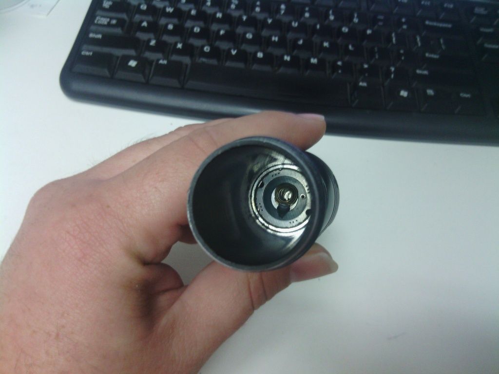

I lied, its an xml U2. This light’s been opened before. The threads on the LED retaining ring were damaged and you can see the piece of solder that dripped onto the led board. You can also see the thermal adhesive left on the back of the LED board. I compared the LED to the photos in the fake Cree awareness thread and it appears to be genuine. The inside is hollow with a lip that the led and driver sits on. There isn’t much contact area to draw away heat and it might benefit from an aluminum disc to lay flat against the LED board along with some thermal goop.

My guess is that it has not been modified before, what you see is the sloppy work of the manufacturer. And even though the board says it is an U2, I give you 99% that it is not a U2 but lower bin. It looks like a real Cree led though.
