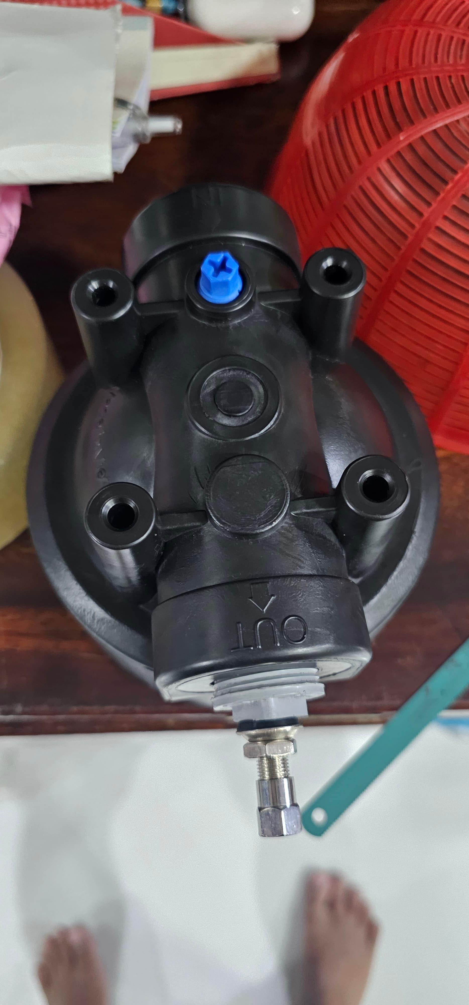

tks Oli i bought the 20 inch filter housing, will test soon

It looks like that Schrader valve is screwed in that pipe plug crooked. Did you drill your own hole in there? I would have used threaded bushings rather than making your own holes. If you’re going to start messing with over 100 PSI and air pressure you don’t want fittings blowing out.
yeah i did drill the hole myself, will test low pressure first to see how it goes. regrading the flashlight i think i will use some kind of hook attach to magnet inside and outside to move the flashlight up and down
also i dont think can fit the valve to the threaded bushings as the valve need some kind of “wall” to attach to. or did i miss anything?
Schrader valves are used for more than just wheels or tubes. Any auto parts store or online you should be able to find threaded Schrader valves. 1/4 inch pipe thread is probably the most common. Again I don’t know the size in metric. And you’ll need a threaded gauge for the other side also. You will be able to relieve pressure with the button on the top of the filter head. NPT is national pipe thread. Your kilometers may vary.
https://www.amazon.com/Anti-Corrosion-Schrader-Thread-Compressor-Sealing/dp/B09YQB8JRN
nice, tks for the info, i’ll check it out
