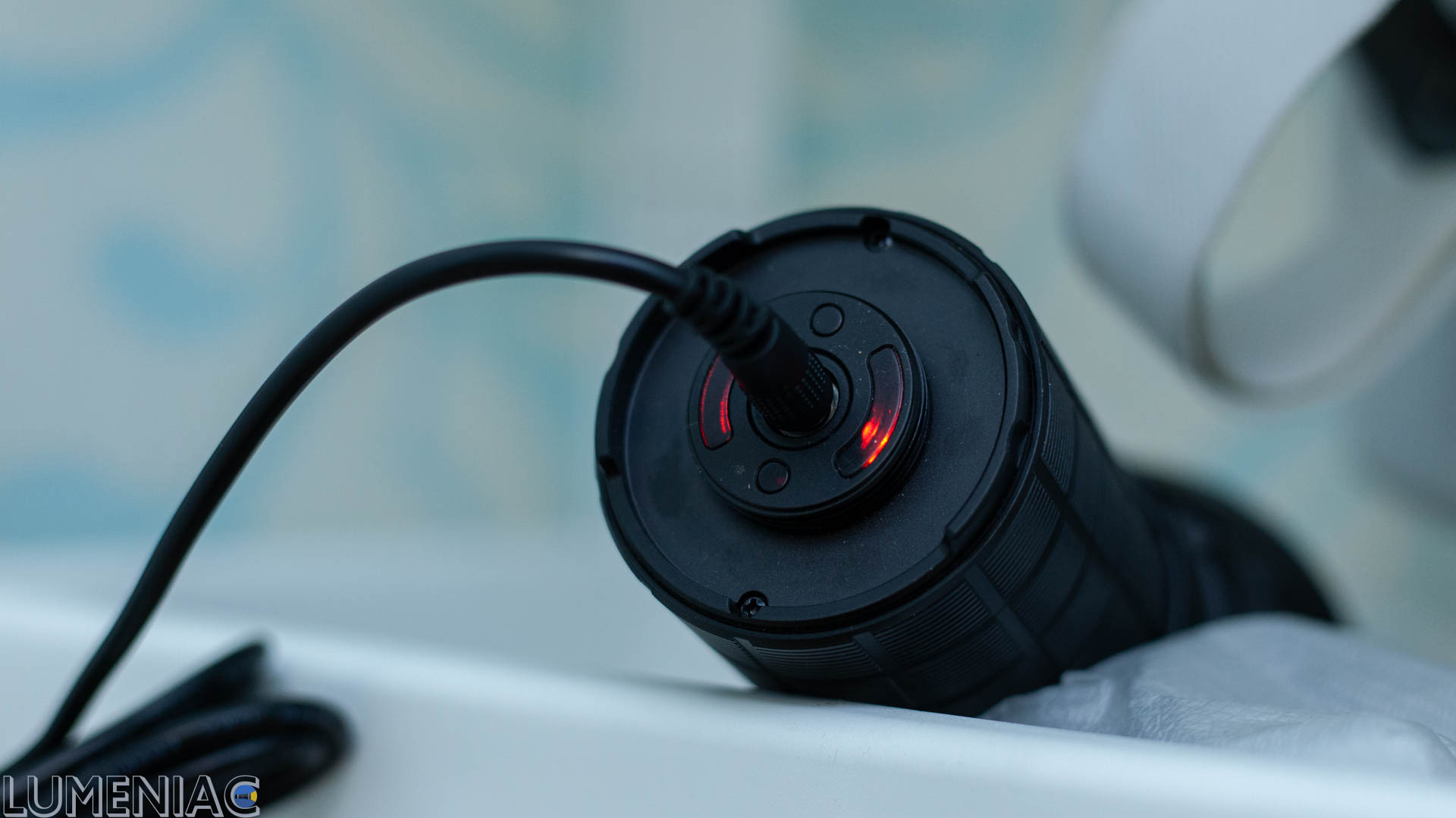

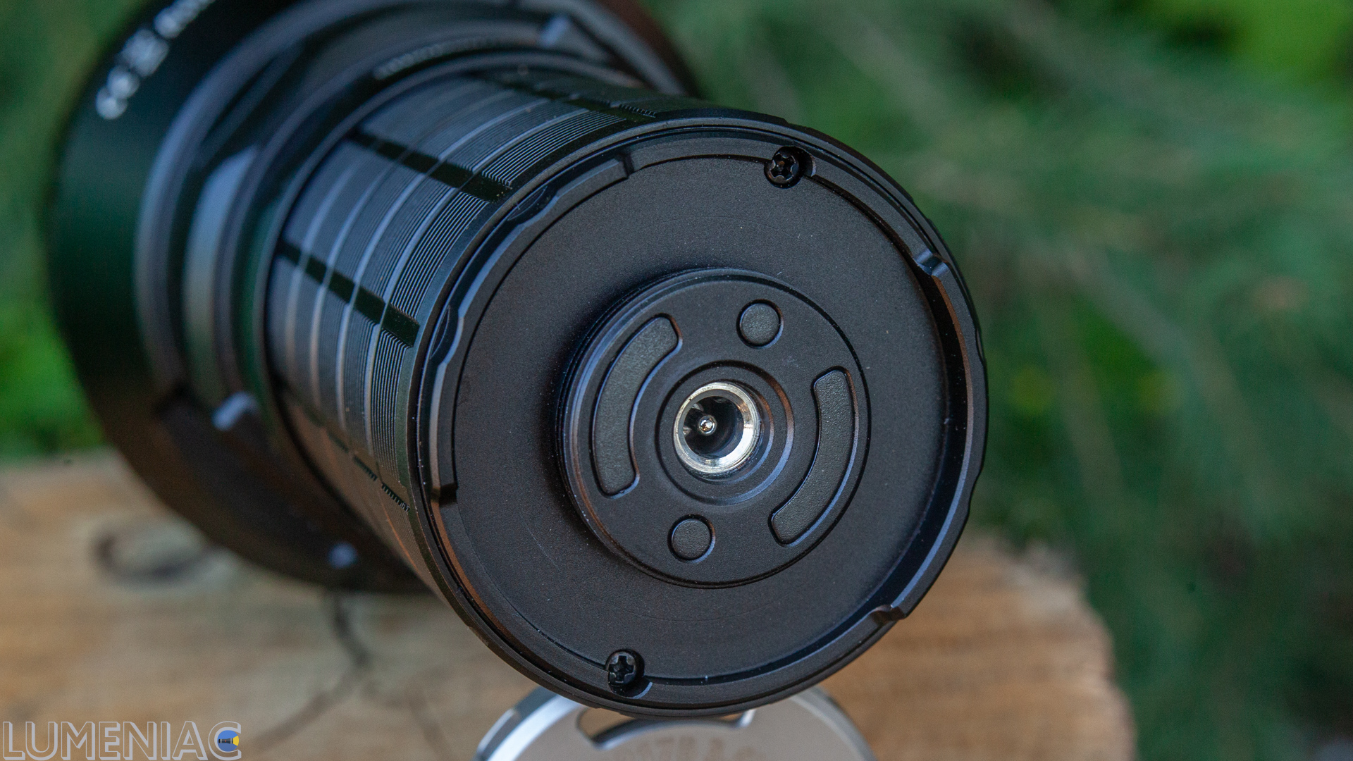

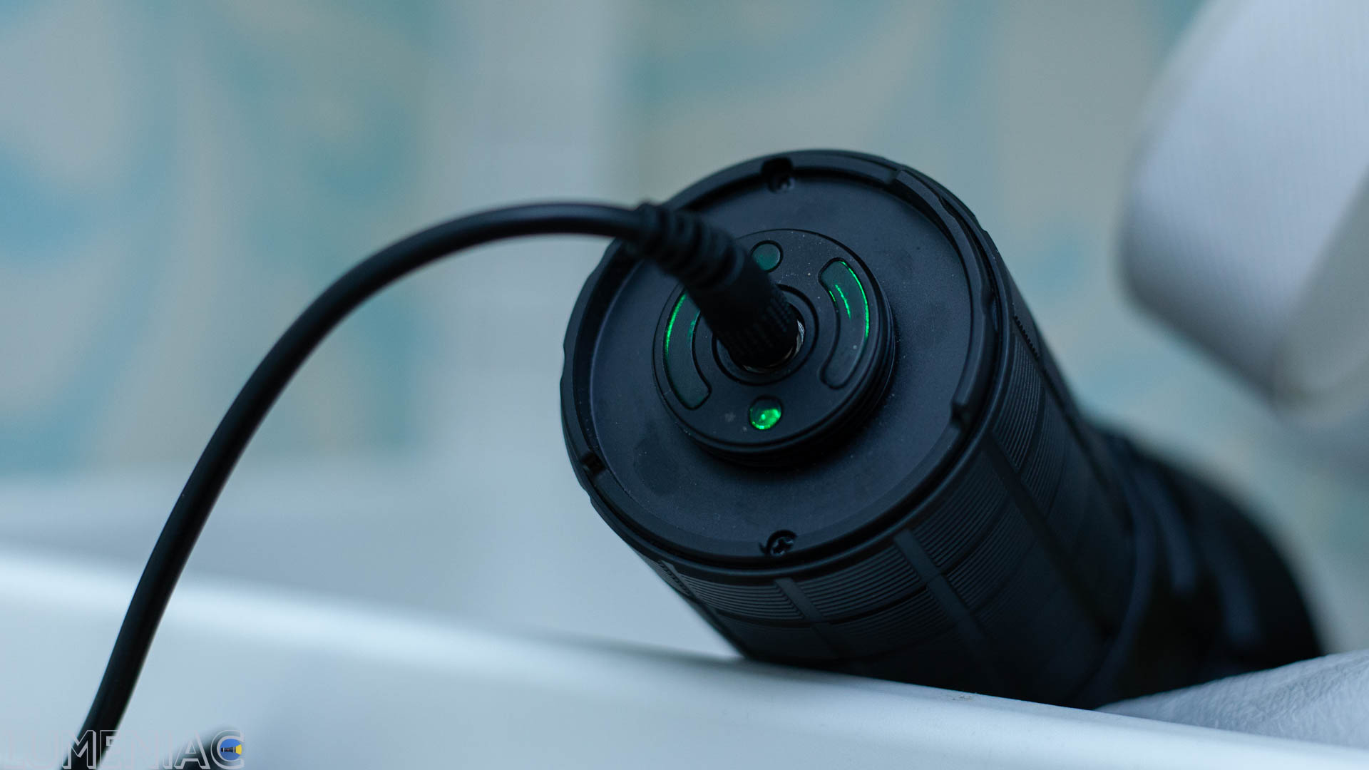

Oh. Barrel charger.I`m not happy with any proprietary charger, but, at least, usually you can plug them into USB-A \ USB-C port. Here you have goode olde barrel plug. Yeah, charge speed is really good, 2 and 1\3 hours is fast. i mean * really fast* for 4* 4000mah 21700 used here. But you are tied to this wall charge unit.
Powerbank? Charging in car while driving? Of course…if you have powerbank with AC output (like this one). Or car invertor. This is so easy, anyone has it. Type-C is for suckers.

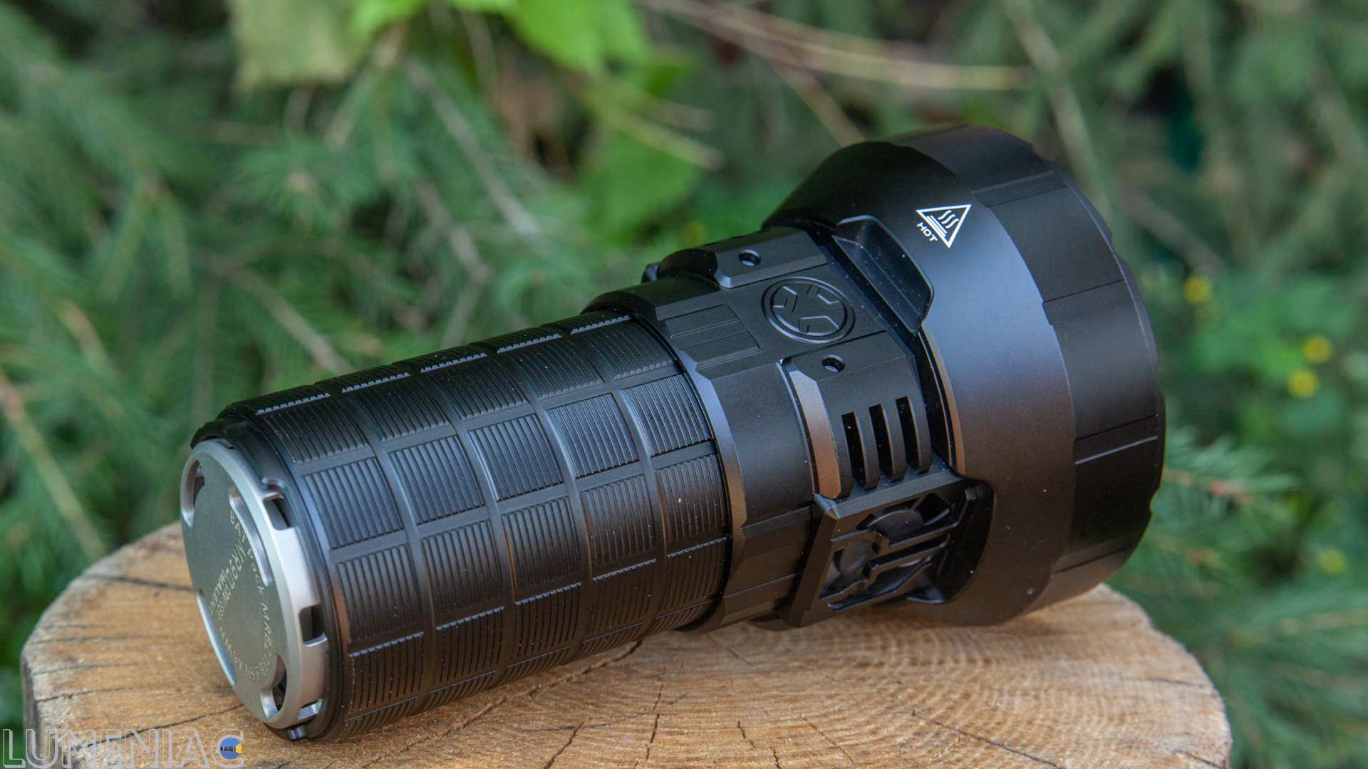

Knurling is OK, grippy. Flashlight diameter allows it to be kept comfortably. However, I am convinced handle will perfectly fit such a powerfull model like Imalent MR90.
During countless tests for this Imalent MR90 review, i figure out that in most cases my fingers didn reach hot head. And this had may be really hot sometimes. So there are less chances to get them burned. Good.
The flashlight can be disassembled into two parts: the head and battery compartment that contains 4 * 4000 mAh 21700 batteries.
Of course, no spring, usual spring. Currents are sooo high, contact area should be wide, contact should be tight.

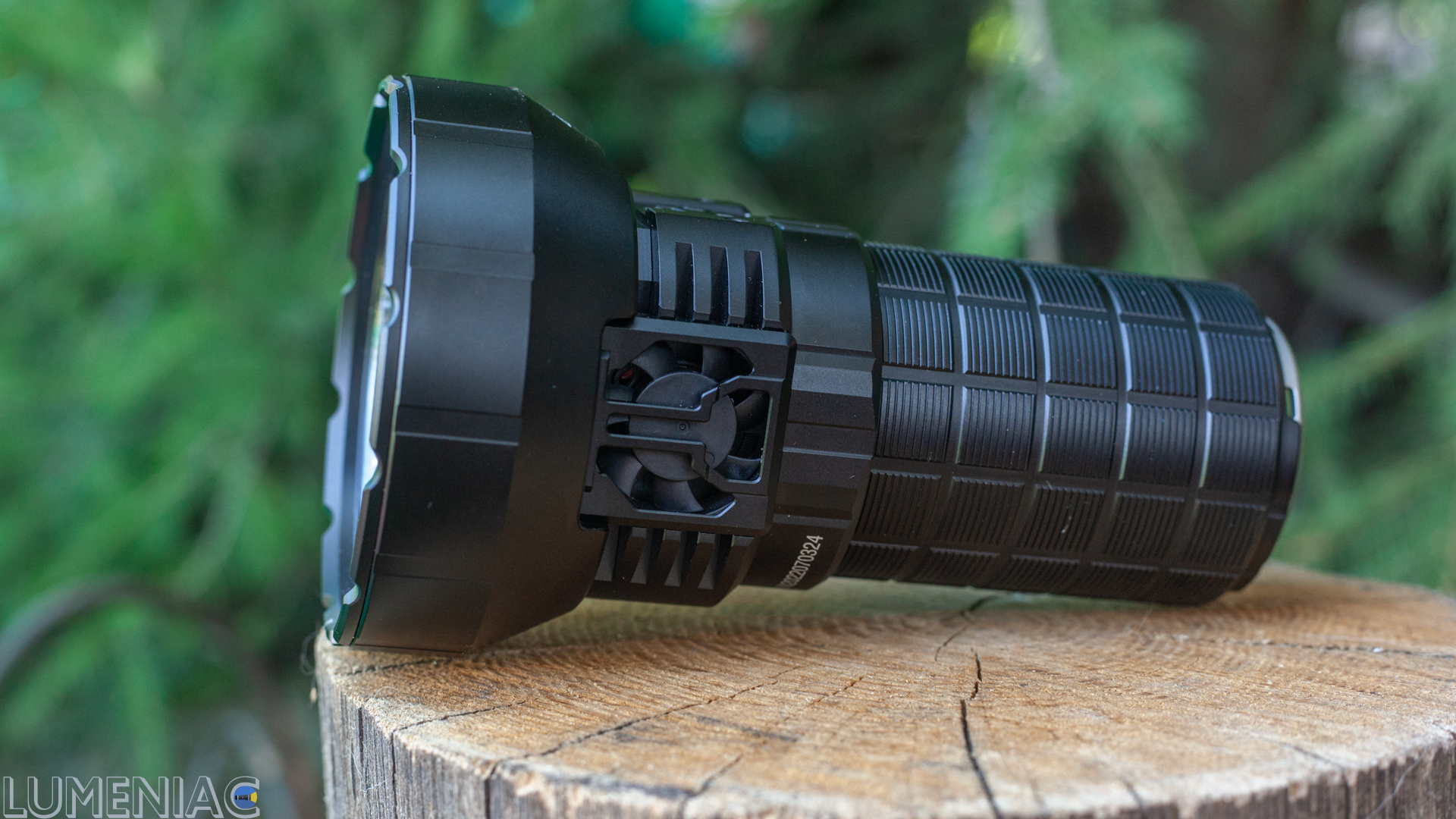

Imalent, I think, made the right step in the implementation of cooling. MS08 also has fans built-in outer plastic shell. It is to the right of the flashlight itself on pic below.
Now the fans are built into the body of the flashlight itself. And, believe me, they do a very good job of cooling flashlight down.

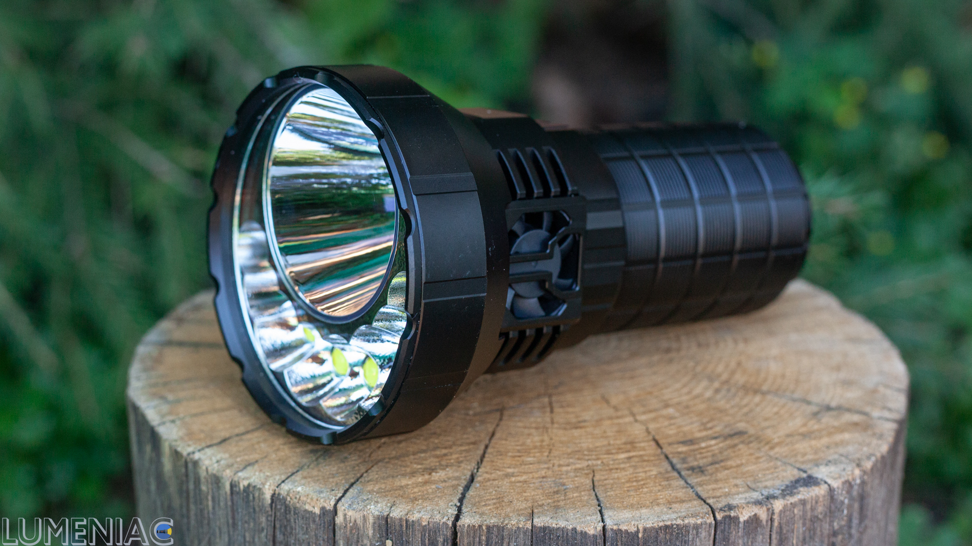

There are of 8 medium-sized reflectors with a Cree XHP70.2 for FLOOD light and deep reflector with Luminus SBT90.2 for SPOT light. This reflector is bigger than some pure long thrower have, so you can expect that Imalent MR90 will have a serious throw. Spoiler. It definetely does.

Barrel charger You do not have the opportunity to go somewhere with a flashlight and when charge it at least in a car or using a power bank. You are literally tied to an outlet. Type-C? Are you kidding? It would make use too easy, are you man or what, buy extra battery pack!

Hello, great review of the MR90. I just purchased one of these and it arrived today. I seem to be having charging issues though. The red and green LEDs are both blinking when plugged in, not staying either solid red for charging, or solid green for charged.
The charger I received is a European 2 pin, but I am using an adaptor to 3 pin as I am in Ireland.
Anyone know why it is blinking red / green, I cannot see anything in the manual, or on the Imalent website.
