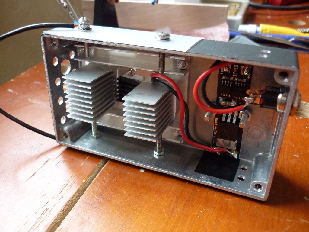

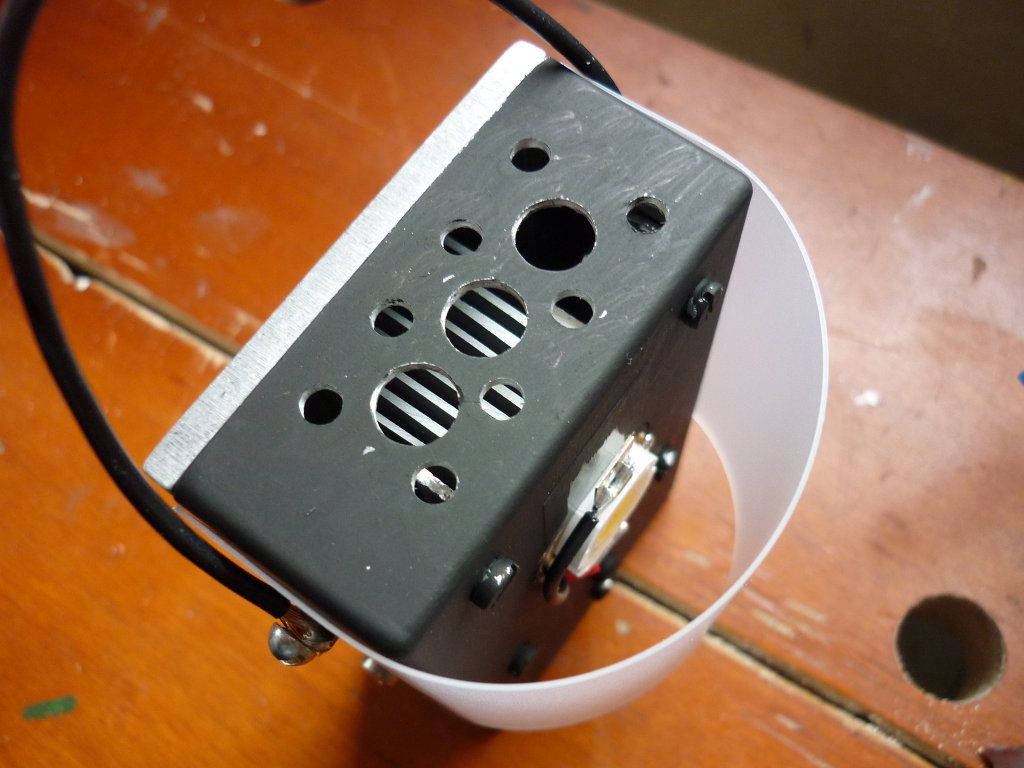

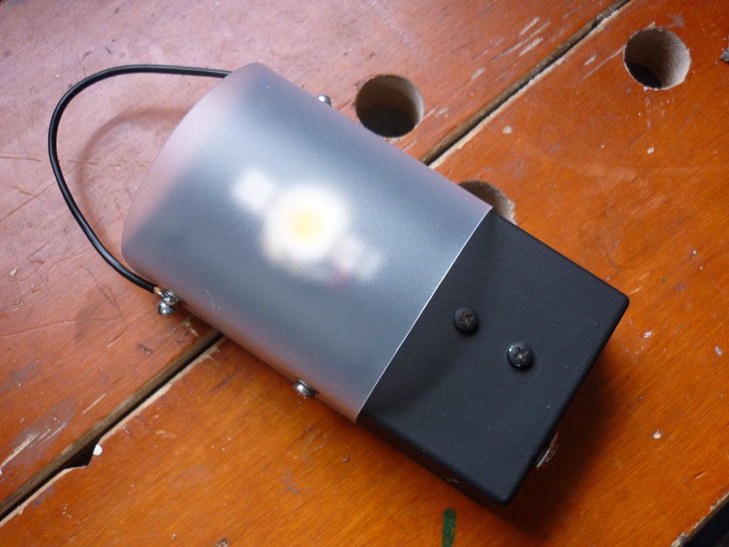

Here are some pictures of the abomination I built.
I drilled holes in the top and bottom, so air can travel through it like in a chimney. But still the emitter produces a lot of heat... The black paint really helped. I kind of suspect that three XM-Ls would produce more light with less heat, but I had that LED flying around and didn't really know what to do with it.
I know it's as ugly as it can be, but it works :bigsmile:
Maybe I just have bad taste, but it looks pretty good to me from the front view (top pic).
