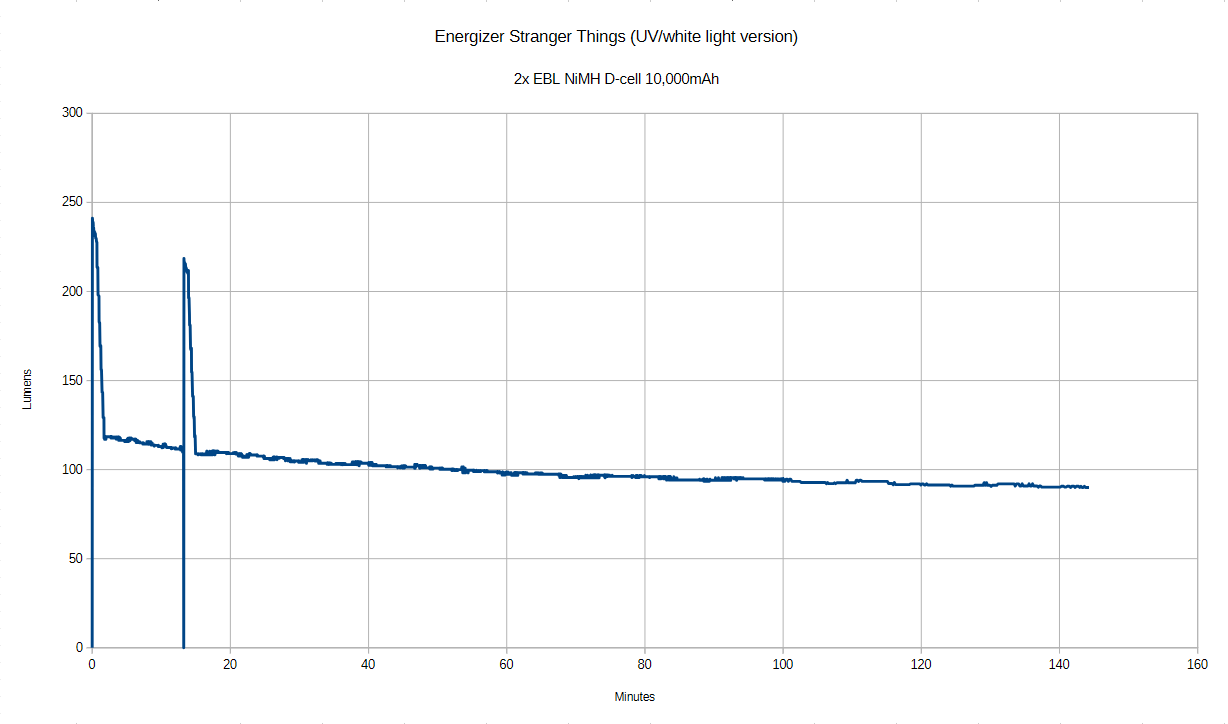

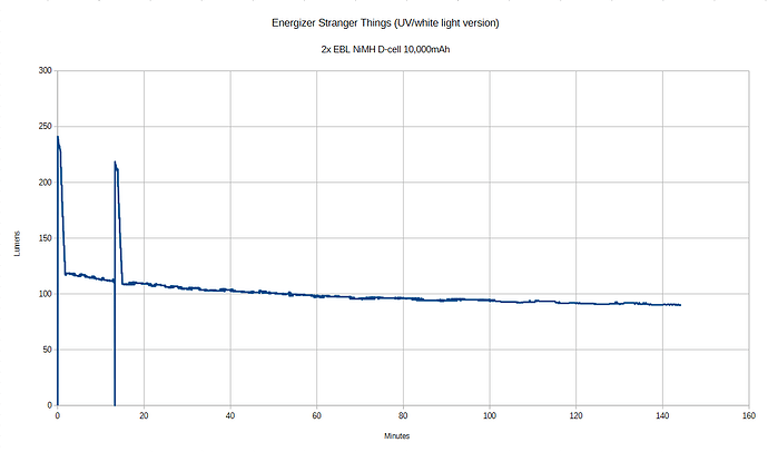

To get the rest of the annoying aspects out of the way, I was prepared to do a reasonably long runtime test, I was thinking like 6h maybe (Energizer claims 7h, but often alkaline run longer because they drop in output so much sooner). When I saw that in under 2 minutes, the output was cut in half, I knew it would be a long test that I was unlikely to have the patience for. So I didn’t feel too bad when I had to stop the test early. And given the pain of recharging I doubt I will attempt it again. I might try it with two Eneloops since it will be shorter.
It takes about 90 seconds for the drop, and turning the light off and back on starts the timer again. What was also interesting to me is it seems to have several steps. Like the fall from ~240 to ~230 lumens seems to be steady. But then it drops to 213 for a few seconds, then 197 for a few seconds, and so on until it is at the bottom of the drop.

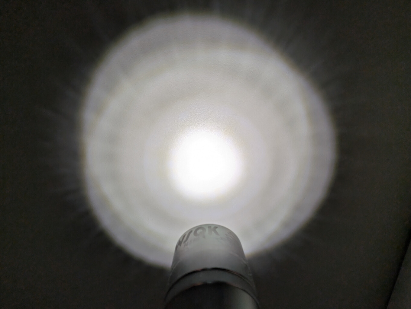

The beam has a lot of tint shift and rings. It looks better further from a wall, giving more of an old-school ringy look to it. Closer to the wall you can see the petals from the offset emitters. I’ve no idea if this setup was chosen carefully for an old-school look or what:

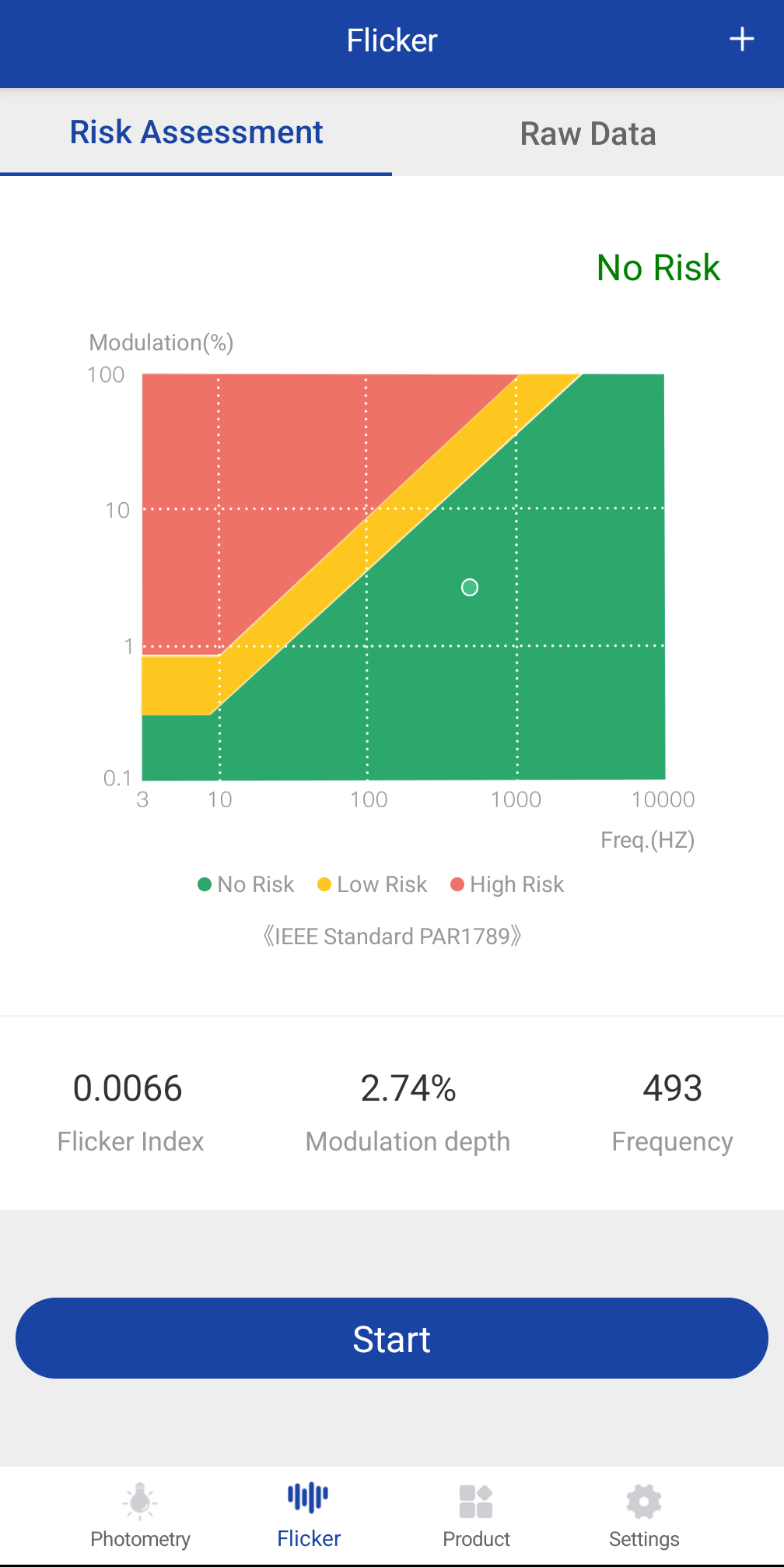

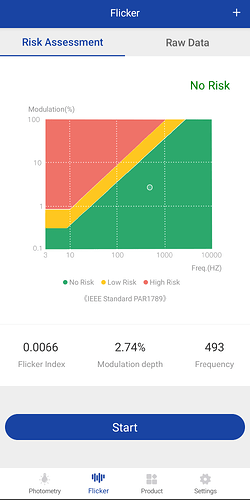

There is no flicker in the first 90 seconds to speak of. After the stepdown there is, but the LM3 says it is not objectionable, and it doesn’t seem strong enough to account for a 50% reduction of lumens:

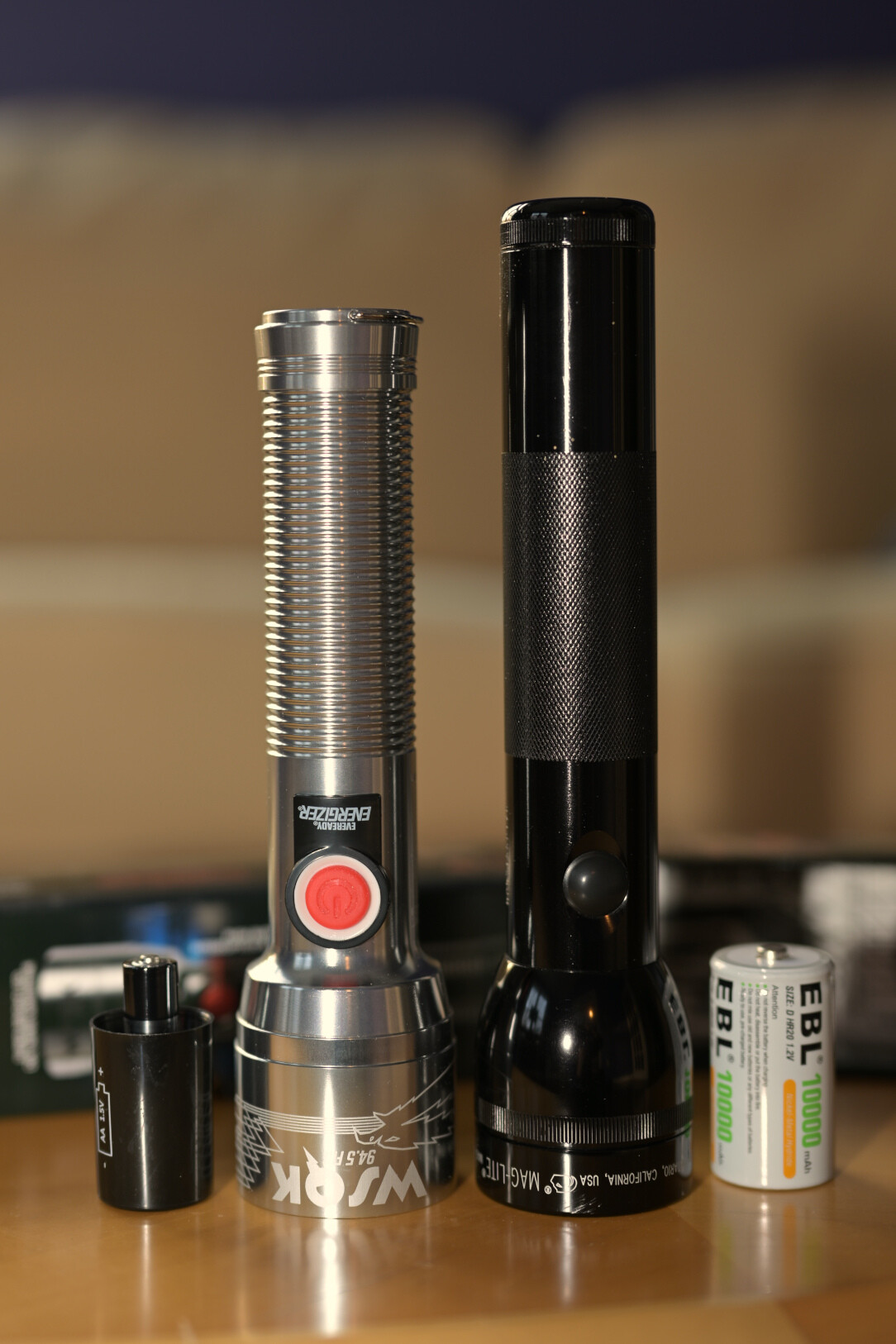

The light includes a single AA adapter, you can see it in the photo of the light and Maglite for comparison. There’s an EBL D-cell on one side and the included adapter and alkaline AA on the other. I’ll keep it in mind if the EBL’s annoy me again. It’s a nitpick, but the light feels pretty chintzy without the weight of D-cells in it.

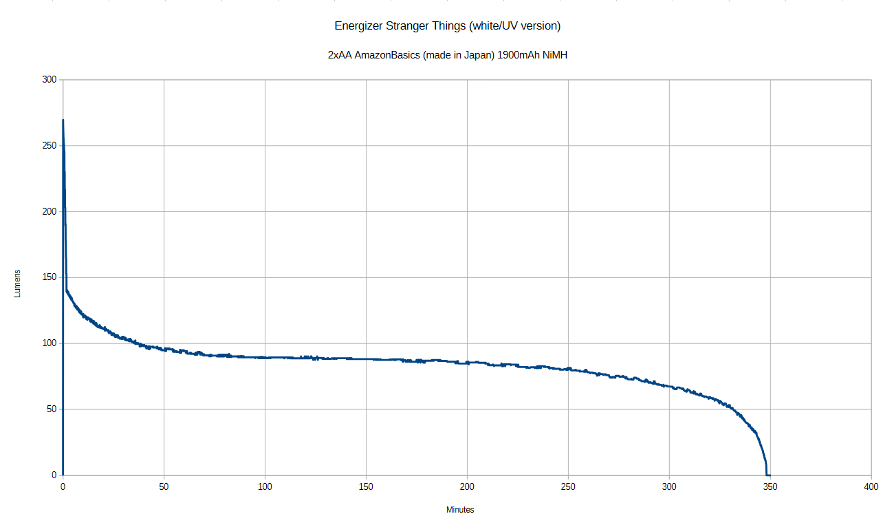

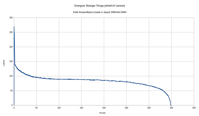

Runtime test with NiMH AA’s. And this has pretty much solidified my disinterest in a full runtime with the D-cells, as it would likely take half a day or more. These AmazonBasics perform just like Eneloops in my experience:
The light was actually off at the end, not just so dim it didn’t register. And I could turn it back on, it came on at ~80 lumens and I did not see how much longer it would run. But it does suggest some amount of LVP.
