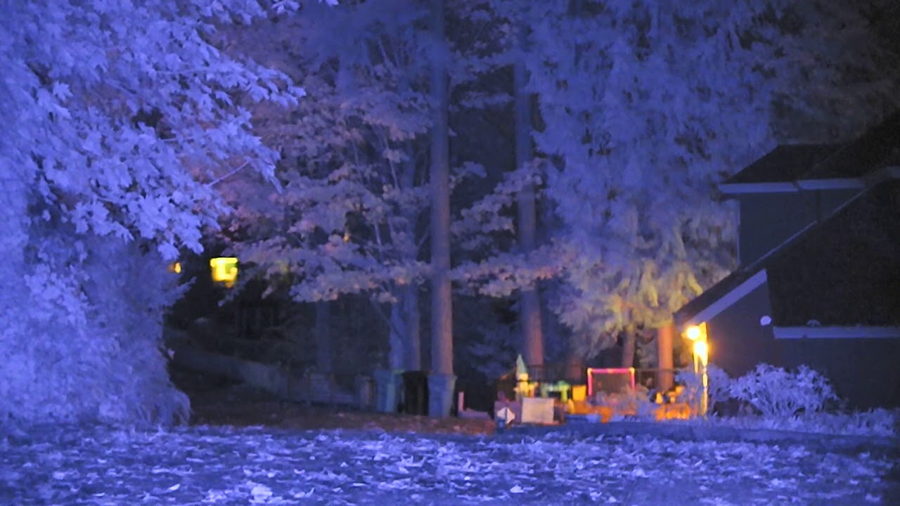

For less than $20 you can buy a FandyFire zoomable 940nm IR 18650 flashlight. It will reach out to well ovr 100 yards since it is zoomable, and has a very wide spill when zoomed back in. I have run two of these for several years without any problems. I highly recommend the 940nm version, as the 850nm is fairly visible to the naked eye. You see that wavelength on most home security camera systems, and the red glow is pretty obvious. Here is a video I shot a few years back that was a demo for the IR light and the SiOnyx IR video camera.
