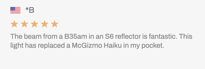

I was checking on the S6 because of this thread and I saw this: I lol’d
