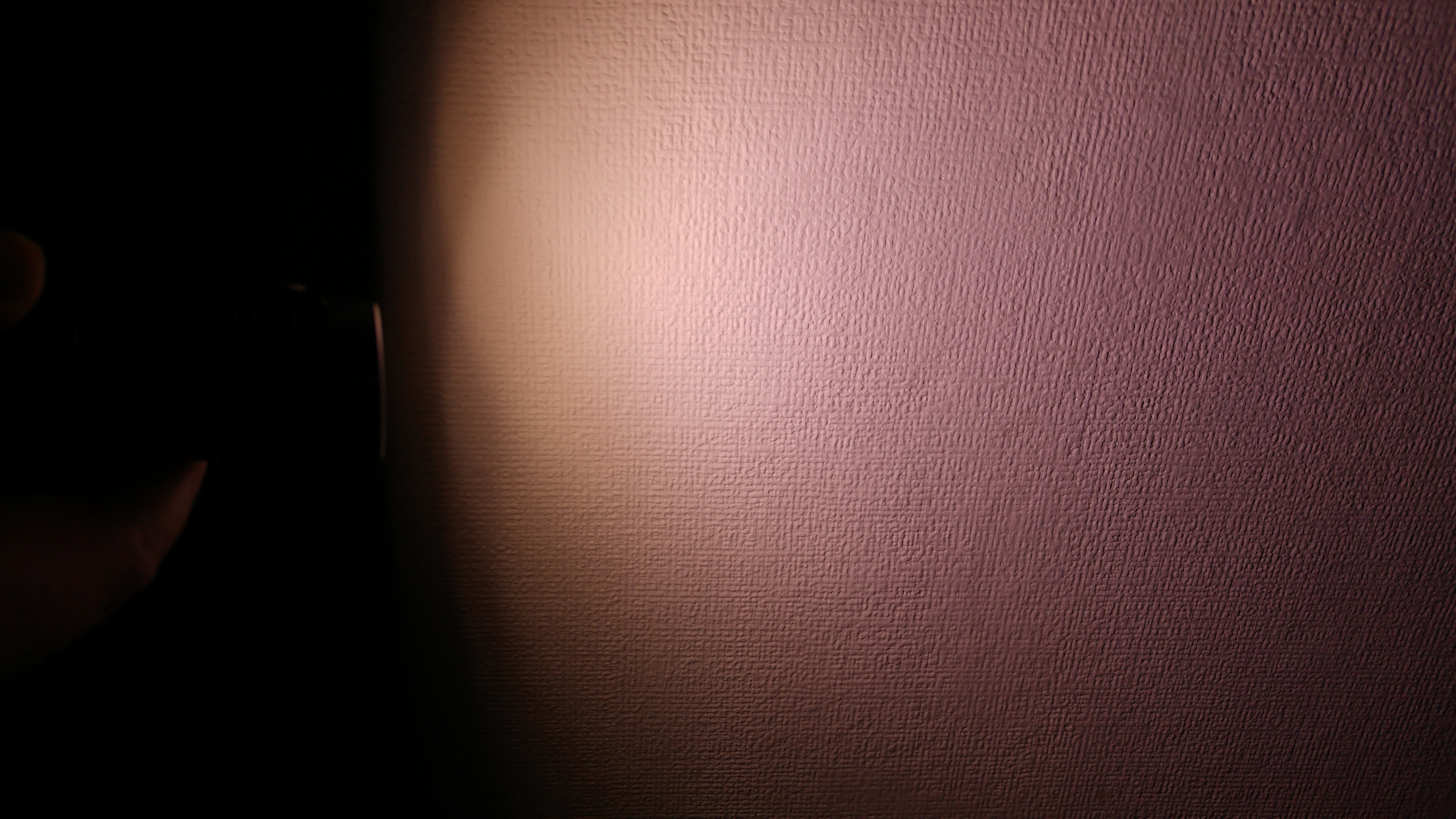

Just bought this Emisar D4v2 SST-20 5k mule flashlight and I noticed that even though the center tint looks very neutral white the edge looks ridiculously yellow... This is my first mule light so I wonder if without a reflector they do be like that....
SST-20 5000 K is a pretty bad choice because they tend to be green and ugly. But the tint shift you are experiencing might come from reflections on the bezel / inside of the head or from the domes (or both).
Thanks for the info. I just did an experiment by using a black tape to mask the interior of the bazel tube to avoid any possible reflection and the tint is still ungodly sounds like I lost the tint lottery or something.
In fact I think even the center is no where near 5k and quite more yellow compared to my nichia 219c 5k
btw, sorry for a dumb question: reflection on the dome can also be yellowish if looking from side?

your photo from the side, makes the beam look worse than it really is, in actual use
if you aim the light straight at the wall, like this: .
you may feel better, seeing that the middle of the beam, the part you actually use, is not the same color as the outer perimeter of the beam in your side photo

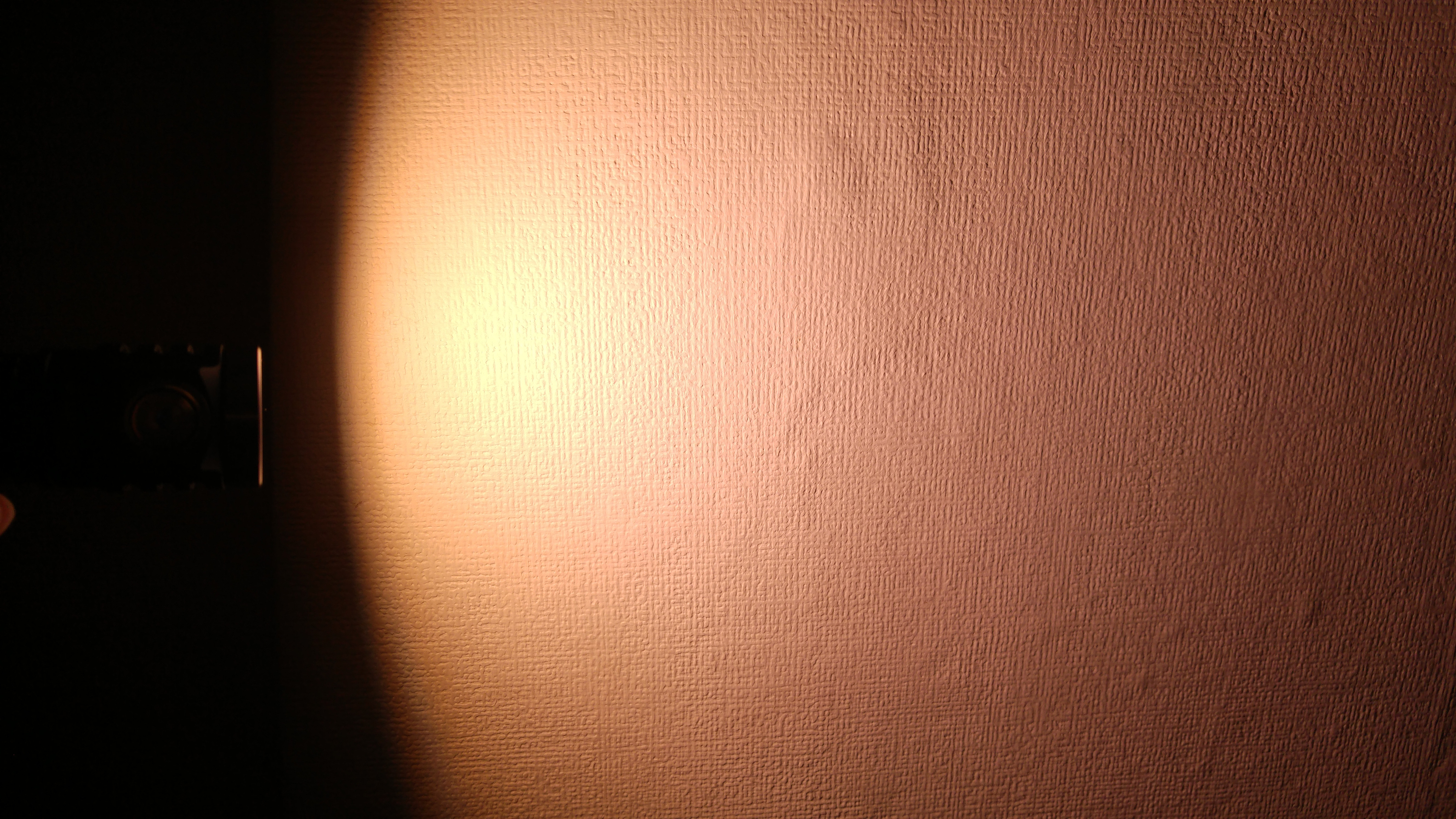

Also… where were you when I ordered my E21A light? My note on the LED a few months ago:
Emisar D4V2 w/ E21a 4500k
I’ve come across post where someone waxed poetic about this E21a LED like it’s the second coming, and I’ve come across post where it was the worst LED the person had ever seen. Based on my pictures and of course live view observation, IMHO this LED is extremely close in beam color of the 219b 4500k, but very slightly more yellow. Of note Emisar needs to use frosted optic Carlo 10623 for the E21e to smooth out the beam, but this frosted optic results in a dim hotspot, too dim for me. I’ve tried the clear optic Carlo 10622 with this light, but then the beam has a yellow greenish ring at corona (see pictures later in this thread HERE). 219b has no such problem using the same optic. Unless you see something that you really like, personally I would pass on this LED and get the 219b instead.
