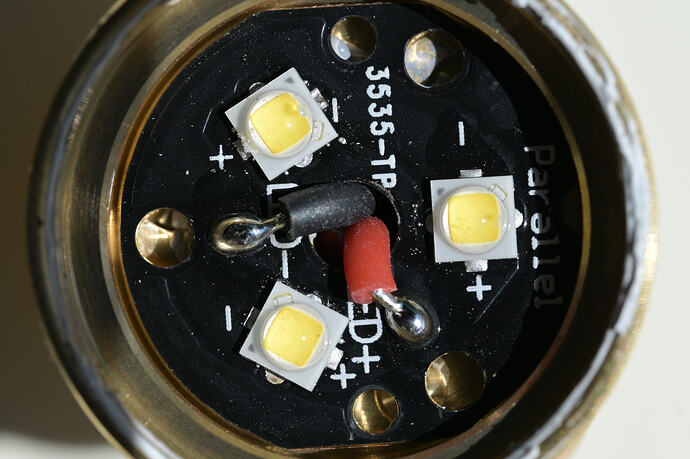

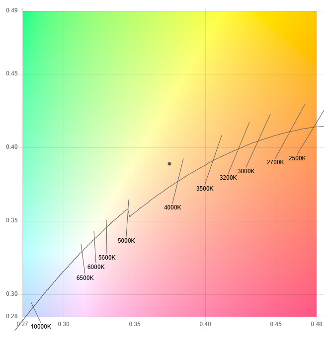

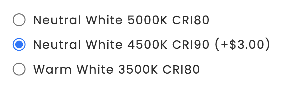

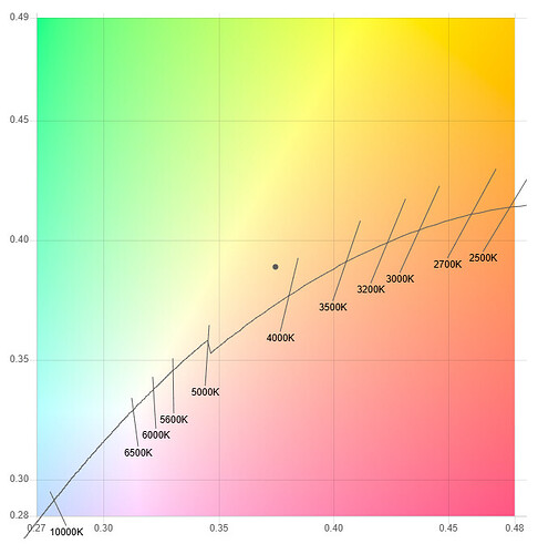

I ordered a 219b (listed as “219BT”) triple drop-in, and specified the 4500K 90 CRI variant. What showed up was noticeably ugly. The Opple LM3 says it is ~4200K and 70 CRI with a horrible +0.0076 Duv. I disassembled the drop-in, and the emitters certainly look to me like 219b’s. So now I’m at a bit of a loss. I have reached out to the vendor but haven’t heard back yet.
Any thoughts or opinions? Am I wrong that they look like 219b’s? Nichia doesn’t seem to still host the datasheet to see if there were low-CRI versions available.
Kaidomain is notorious for shipping incorrect LEDs. I’ve personally received the wrong CCT and CRI several times. I don’t believe they have any R9080 or R9050 4500K 219B in stock, since the bare LED listing shows they only have R8000. 219B-V1 was previously available in the sw45 (non-k) chromaticity bin that can have positive Duv. If these aren’t even reaching CRI 80 then you basically got doubly screwed by KD.
For reference, none of the usual sources have 219B sw45k available in R9080 anymore.
yes
sorry to see they are not the 90 CRI posted in the listing:
hopefully they will refund your purchase
maybe suggest they update their posted CRI in the listing

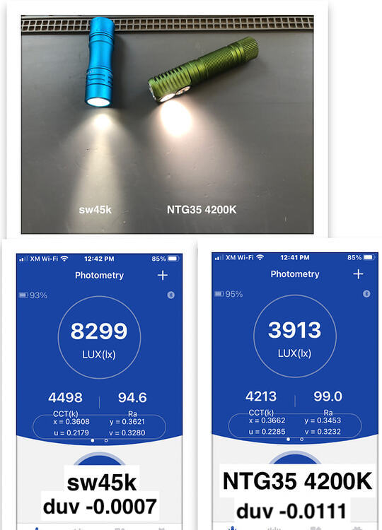

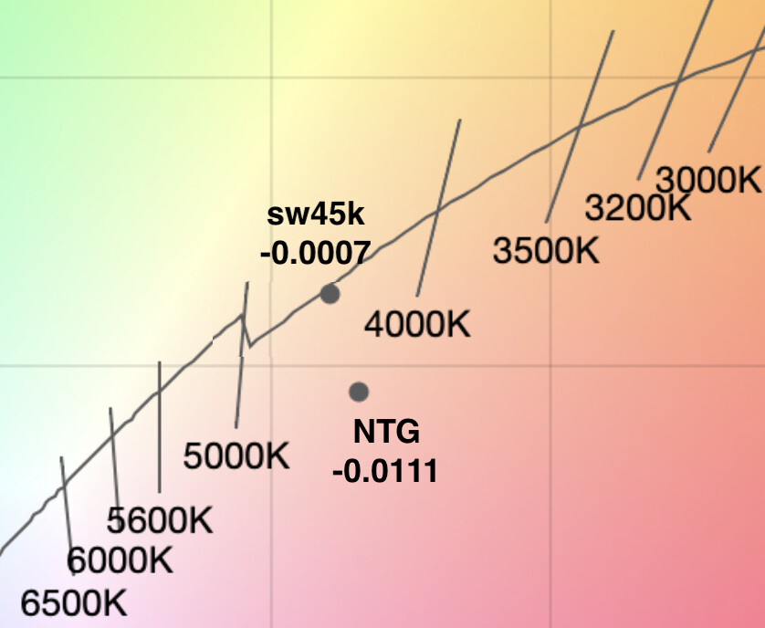

fwiw, there are a lot of different Tint Duv of sw45k.. here is one with particularly low amount of rosy tint (a D220 from Convoy on left):
(measured on Opple 3, the lights are both set to 30 lumens)
I have come to prefer the NTG over the latest sw45k (older sw45k were more rosy)
