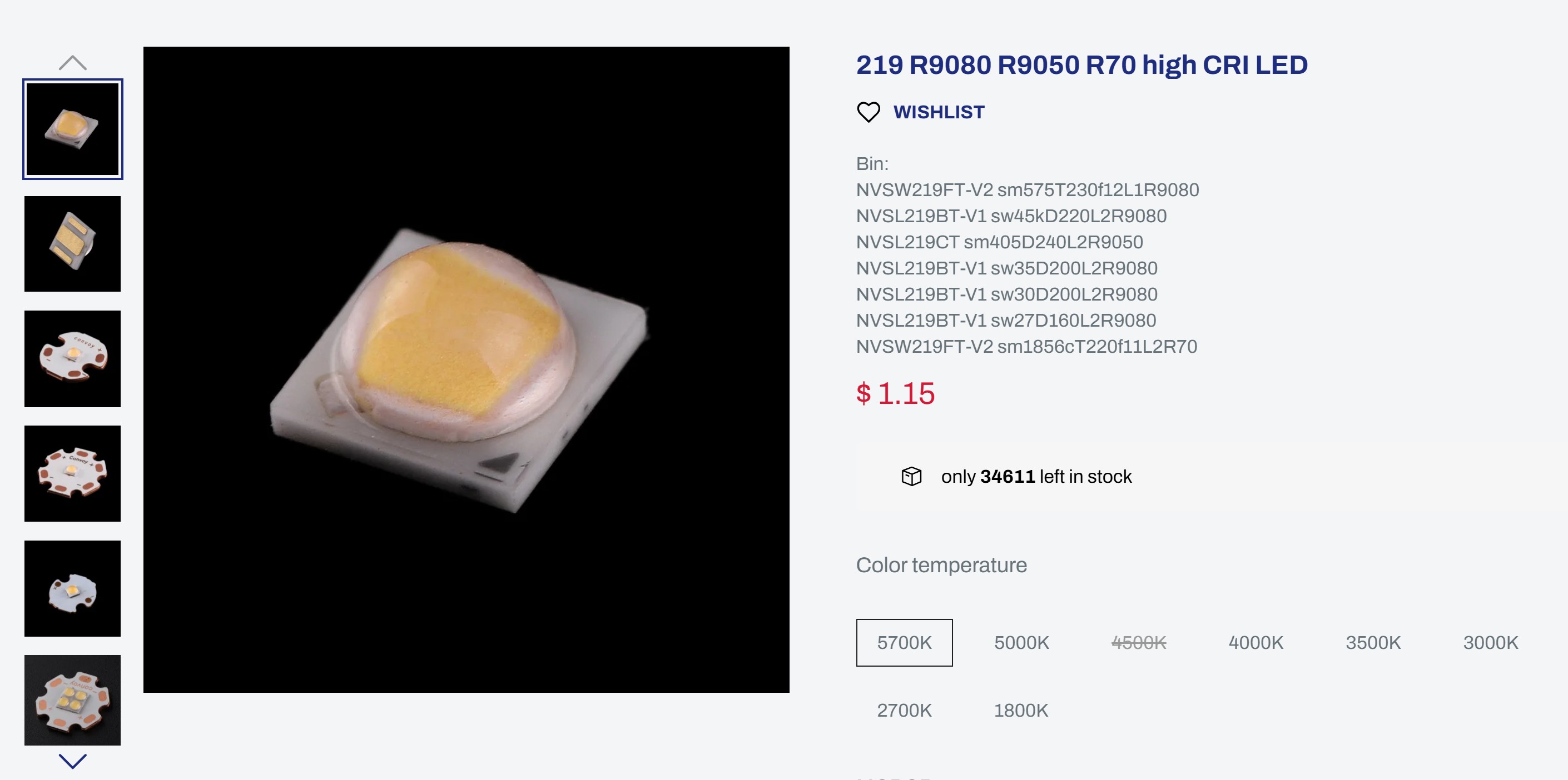

(Sorry deleted above post by accident.) You’re welcome. AFAIK Simon uses the same LED for his flashlights and the bare LED he sells.
You could see in the listing of the bare LED the bin is sw45kD220, so I would think you’re safe. Out of curiosity I’ll check with him. I have multiple lights with this LED so I hope it is.

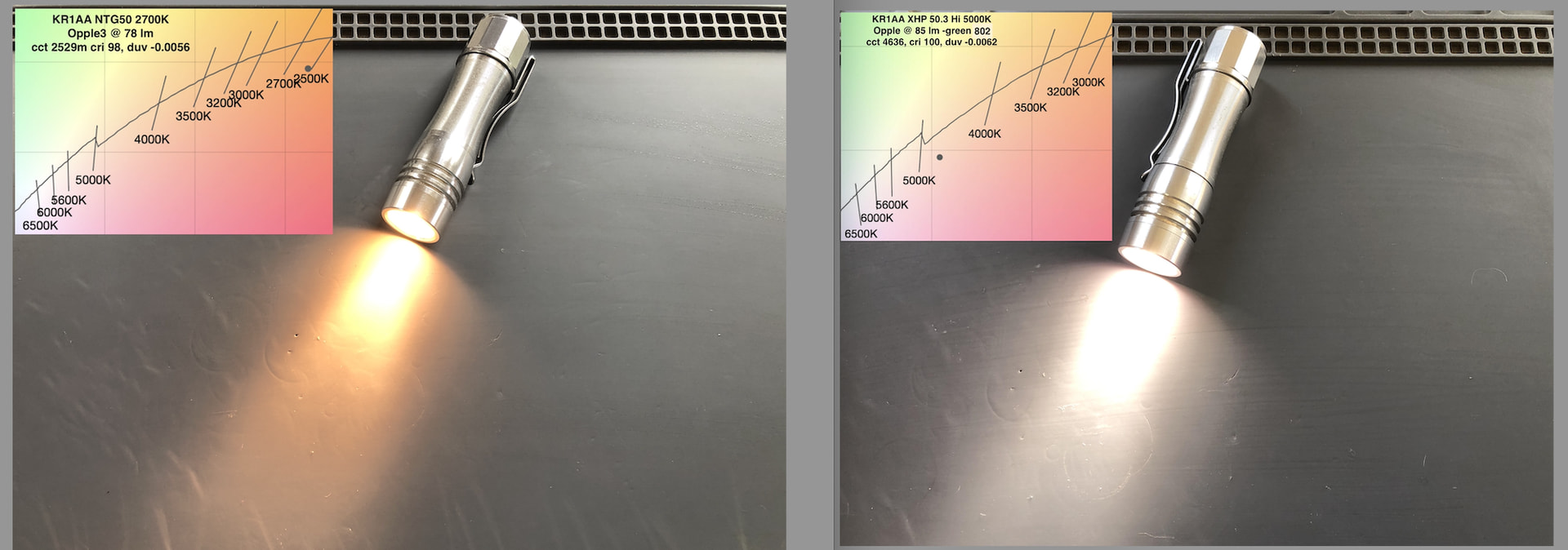

I seem to prefer duv between about -0.0050 to -0.0080
its great you have reference measurements to help quantify your experience
when waking in the dark of night I like warmer light than during daytime adapted use
here are a couple of my favorites for each of those scenarios:
In the middle of the night the warm light does not look so orange, while the cooler light looks more blue than during the day.
during the day the warm light looks more orange than necessary, while the cooler light does not look blueish, it seems white to my daylight adapted eyes
