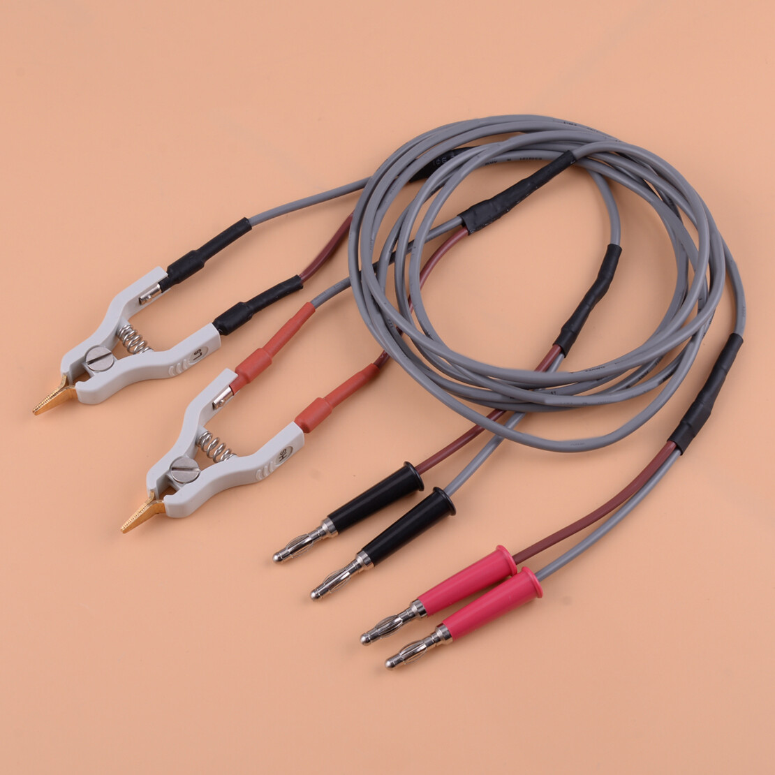

any good desktop meter has it
also specific low resistance Multimeters
used mostly with this type of Kelvin clamps
Sirstinky
(Sirstinky)
42
Thanks! I don’t have that kind of equipment lying around, but good to know
