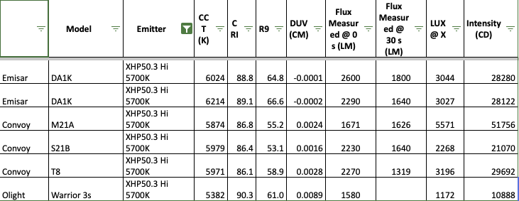

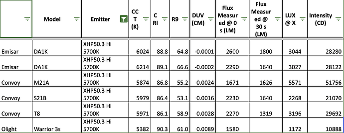

The 50.3 hi, high CRI Jackson has would be the same as what Convoy has I think which is R90. Mine have typically measured just under 90 unfortunately, with around 60’s for R9 (70.3 is the same story).

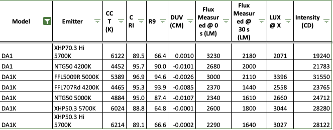

The 50.3 hi will be throwy, probably about the same maybe lightly better than SFT70. Here are my DA1/DA1k’s for some reference. Note that the DA1k with the FFL5009r 5000K, that emitter was basically the best sample I’ve received yet (it’s exceptional). Overall, the “throw” of these 5050 6V emitters will be pretty close to the same in practice. Like @ToyKeeper I def recommend the NTG50 4200K as it pretty consistently is very good.
The 50.3 and 70.3 bin to get is the 2A M2 bins. These have the closest-to-good properties.

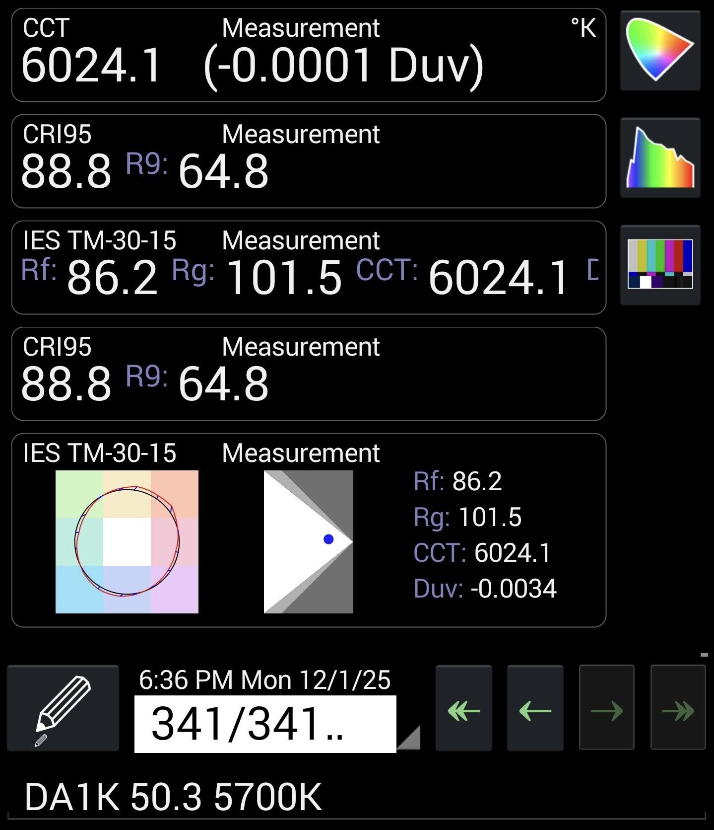

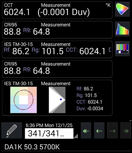

Of note, the last 50.3 5700K I got from Hank has been the most exceptional yet:
Thank You for the great details! :wink:

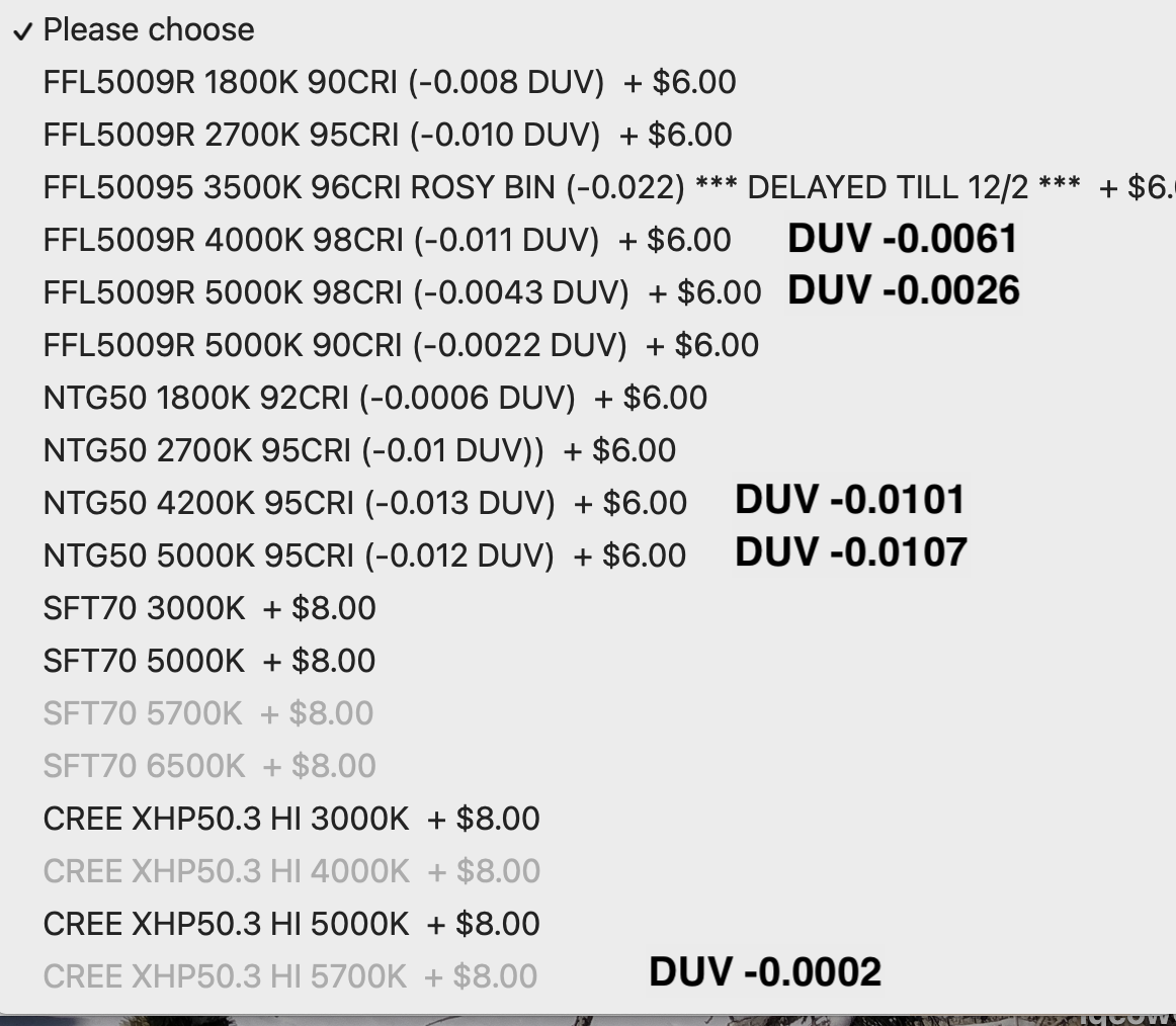

Including the info that the 50.3 are High CRI 9050
added your DUV values to Jacksons list:
Remember a key point, that 50.3 sample I have that measured -0.0002, that is rare. Average I measured is around +0.0026
