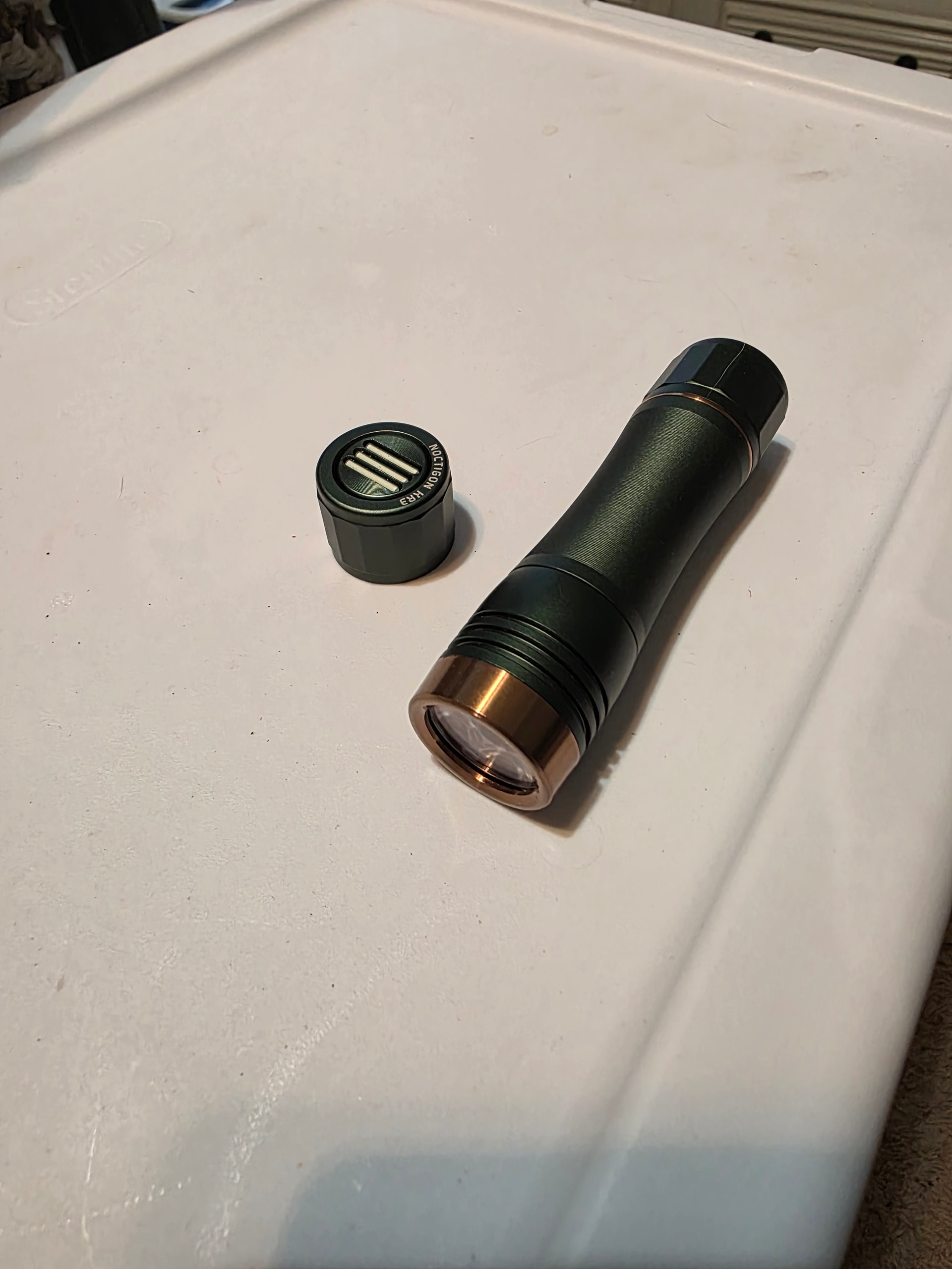

My Noctigon KR3 arrived yesterday afternoon. I added a tritium tailcap to my order.
The light works great with the normal tailcap, but when i switch to the tritium tailcap its completely dead, I dont even get the flash when anduril lights initially make connection. Are there any easy tests I can do before I reach out to Hank?

Unfortunately, after a few days of playing with it I’ve had no success. There’s no visible difference, but the normal tailcap works flawlessly and the tritium tailcap doesn’t make connection at all. I even tried disassembling the tritium tailcap to see if I could find something disconnected internally, but I can’t get the retaining ring to budge and I don’t want to mess the threads up trying to force it. I’ve reached out to Hank to see if he has any suggestions/ next steps.
