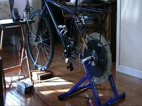

If you have and old DC, stepper, etc motor laying around you could even make it yourself. Another plus is that you can rig the motor to work in any number of ways, like using a bike for example.
Or you can just make it from scratch
