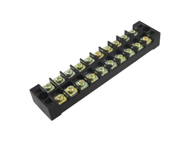

No worries. Doesn’t matter in the slightest.
Just get overall polarity right. If one doesn’t light, flip the leads.
Screw-terminals are invaluable for that kinda thing.
