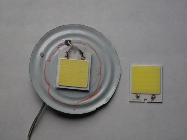

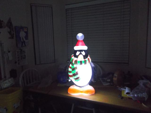

I would have suggested using the newer chip-on-board version of this light. I just bought 10 of these from an overseas seller on ebay for less than $6 and they were here in 16 days. I use them in converting Christmas decorations blow molds from the old C7 incandescent lights to LED. A 60W converter shown in post #4 above will power 12 blow molds. This is the result when I used it to replace the missing incandescent light on a Christmas penguin. It’s pretty bright.
Chip-on-board (COB) panel light:
and inside the blow mold

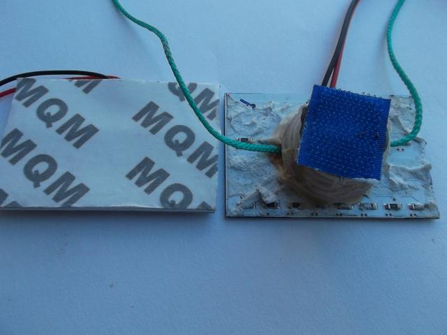

I know the panel has resistors because I used them in the past for some DIY experiments. Here’s a picture of one with the foam backing taken off so I could add a way to attach it using Velcro. You can see a row of tiny resistors at the botom edge of the circuit board.

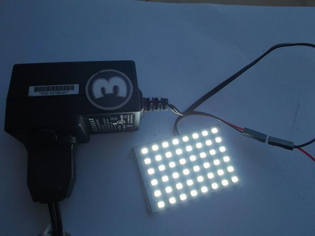

Proof that it will work directly off 12V DC? The second picture shows a surplus Netgear 12V 12W converter powering one of the lamps shown in the first picture. It was a direct plug in to the Netgear converter output. It doesn’t look very bright in the picture but it is way brighter than the picture shows.
