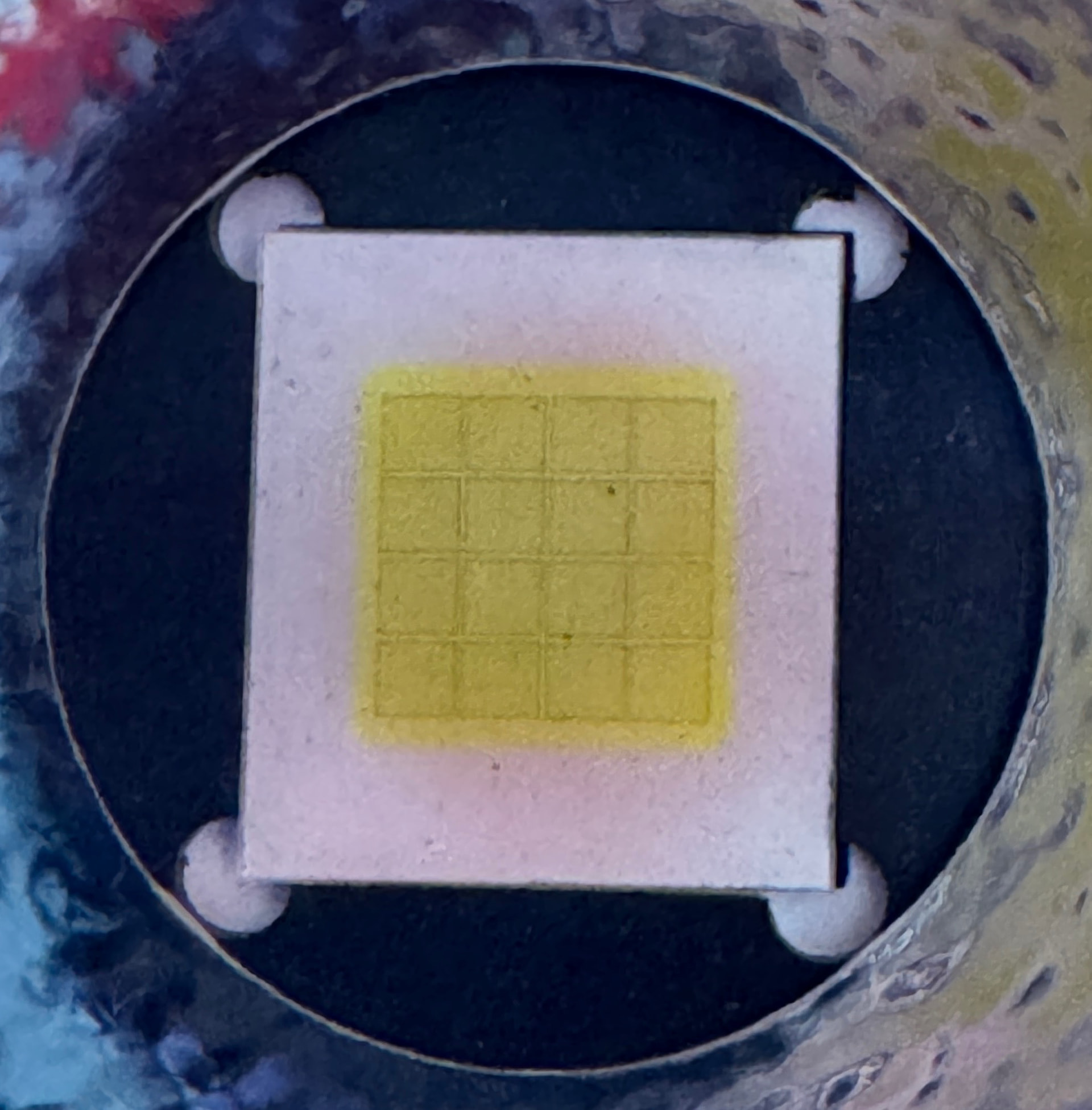

@cannga does the SFH55 in your PD90S looks the same as the one that can be seen in the 1lumen review, so with only phosphor on the chips and a white ‘border’ around it?
The reason I’m asking is that I have an Astrolux FT03S with SFH55 and since that was also made by Mateminco, it should in theory be (almost) identical to the PD90S, but the SFH55 in my FT03S has a phosphor layer on the whole ‘package’, so without the ‘white border’. (I’ve seen this on several LEDs in Mateminco lights, for example with the SFN55(.2) in the FT02 and the SFQ43 in the X6(S).)
I have no clue if those ‘versions’ of the LED perform different in any way though.

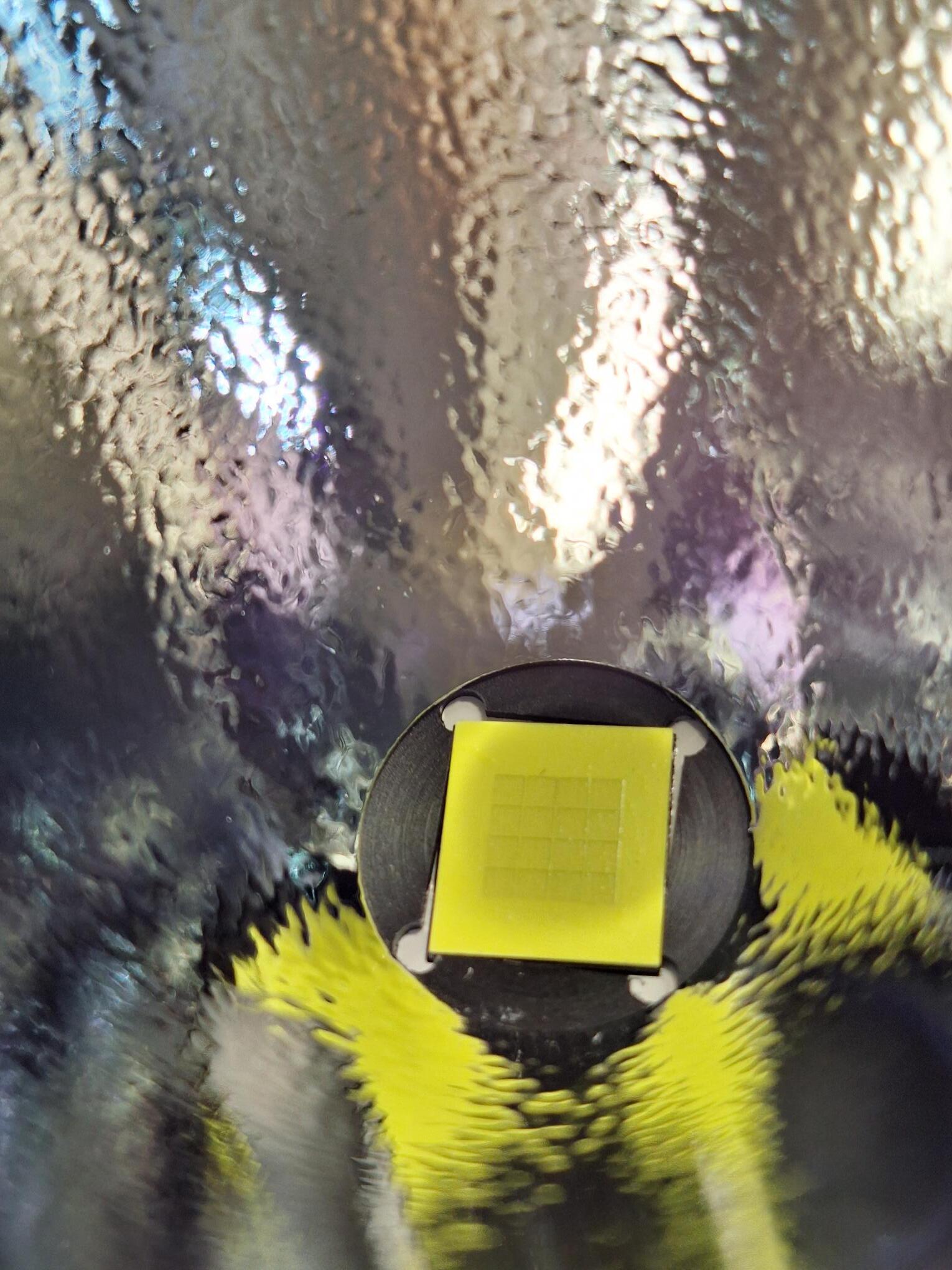

Picture of LED in my Mateminco PD90S. Hope this helps.
Thanks, that’s how it should look as far as I know.

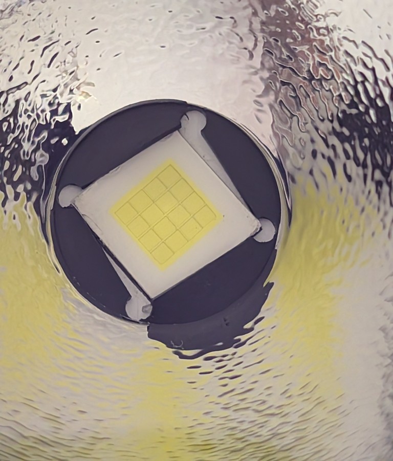

The ‘SFH55’ in my Astrolux FT03S, which is also build by Mateminco but just rebranded, has a SFH55 LED that looks like this:
So basicly no white border. I’ve seen the same with 2 other Mateminco branded lights, where the used SFN55 and SFQ43, which normally also only have phospor on the chips and therefore a ‘white border’ around the LES, both also are completely covered by phospor, looking the same as in the photo above.

My FT03S has the white border on the SFH55 .

Going by Sirstinky’s post above yours, your FT03S has an earlier version of the SFH55, while Mateminco probably had to source a new batch of SFH55 later on, resulting in a more recent version ending up in my FT03S.
