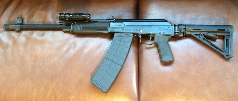

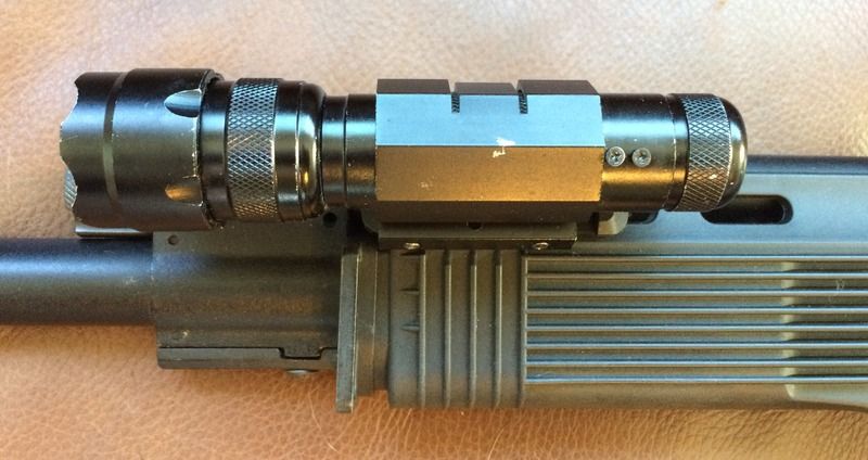

Lets build a Shotgun Flashlight!
This Saiga 12 is way over due for a purpose built light.
Time to get rid of the skanky old 502B

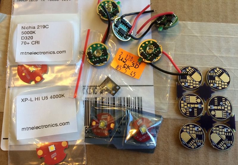

Anyways… I laid out some of the bits and pieces that I have to work with. The Nanjg 105c’s would involve the least effort. My concern is if the driver retainer ring would hit the 7135’s on the backside. These are 350ma 7135’s so I would stack on two or three more.
The next driver option would be to build one of Wight’s one sided DD boards. It’s been awhile since I read the support threads so I need to refresh my faulty memory. I have all of the parts and tools. I just need to remember how to build a single mode without the Atiny13.

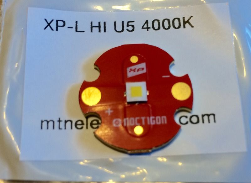

Also what emitters won’t survive direct drive?

Yes this shotty sits in the corner by my bed in case the front door ever gets kicked off its hinges. I hadn’t thought about reflective light blinding me though. The 502B that I’m currently using is at best only putting out a couple hundred lumens. It needs to be much brighter. At least bright enough to join the midnight Skeet league.

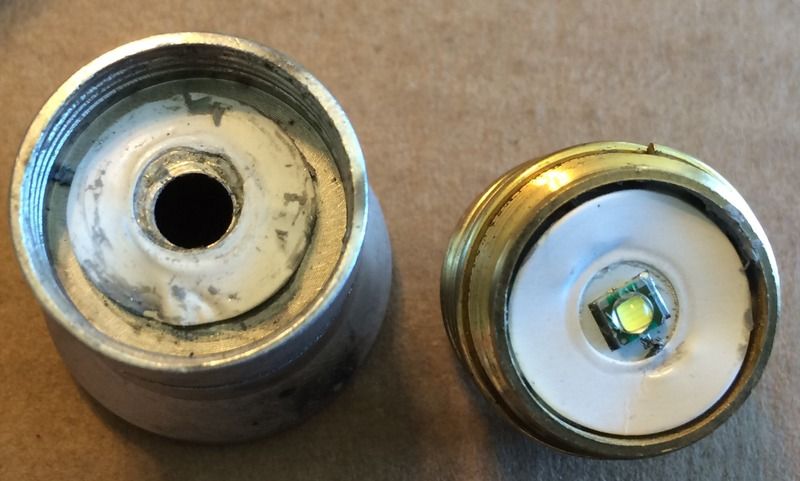

Hi Texas Shooter, I’m surprised this light even still works. It got beat up pretty badly under the reflector when the recoil started unscrewing things.

I just happen to have a XP_L Hi. I’m working the parts to flash drivers but not there yet. So yah, Mtn would have to do it for me.
Hi DB, Is there an issue with the driver retaining ring and the 7135 placement on the backside of Quite drivers?
