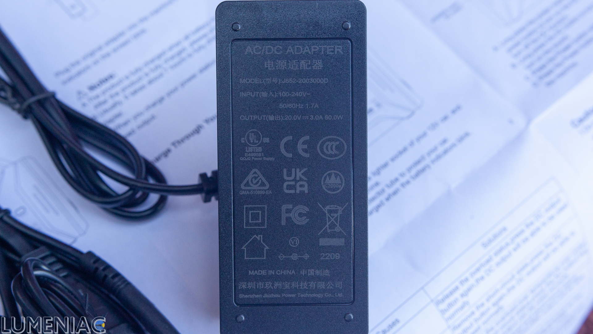

Kit includes everything you need: 60 watt PSU, Type-C cable, MC4 to solar panel adapter connectors to 5521 pin, cigarette lighter chargin cable, manual.

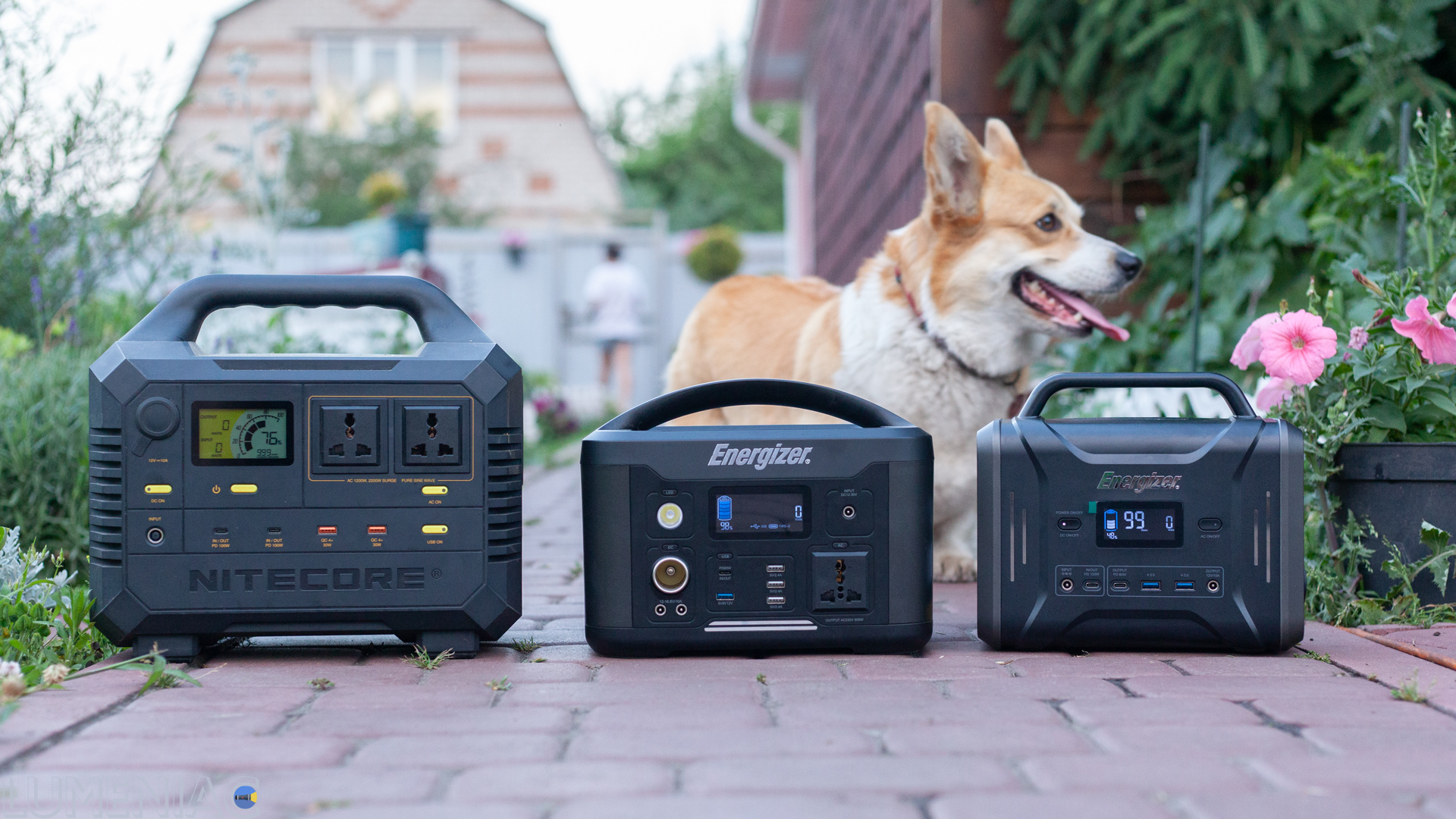

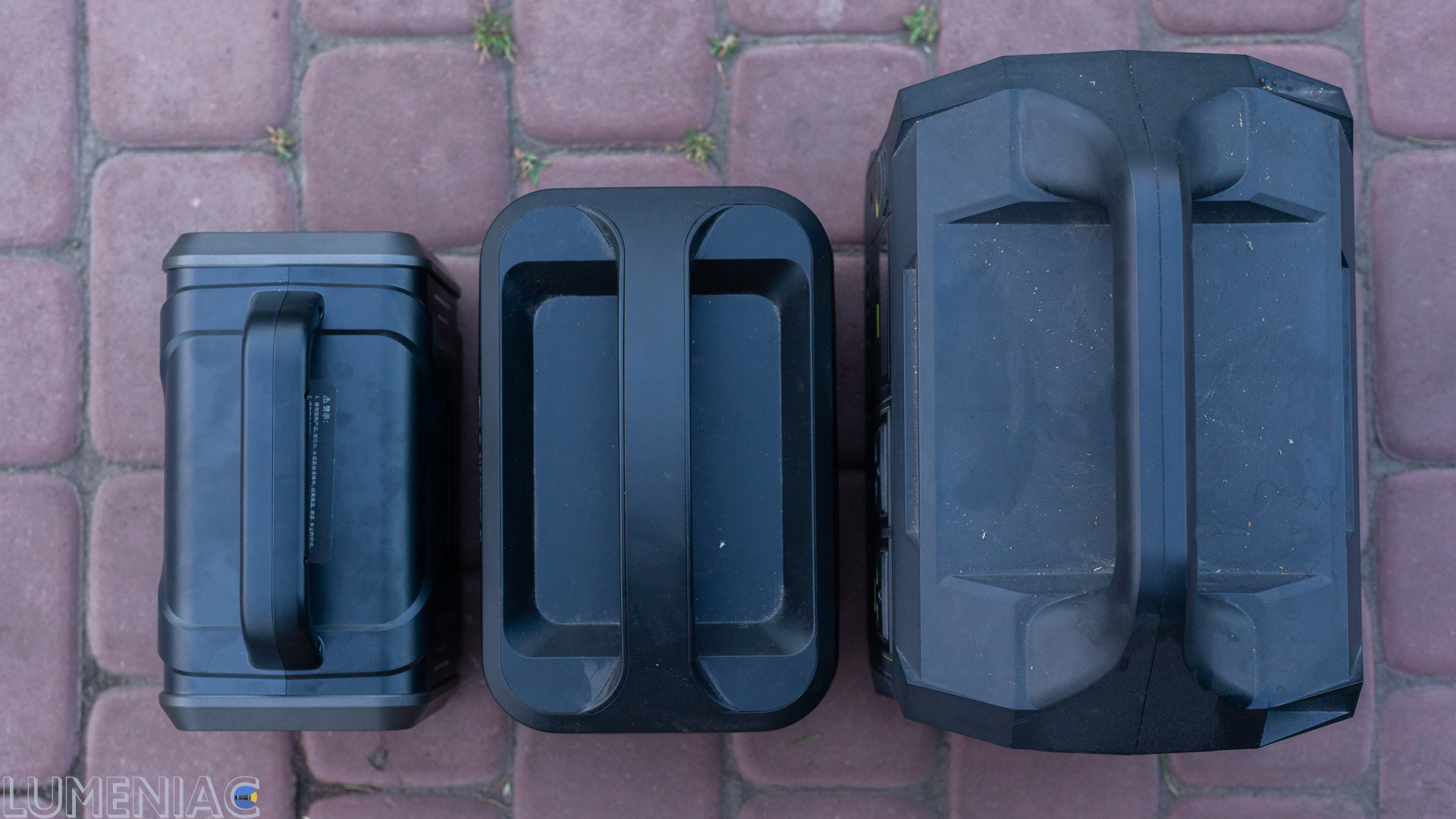

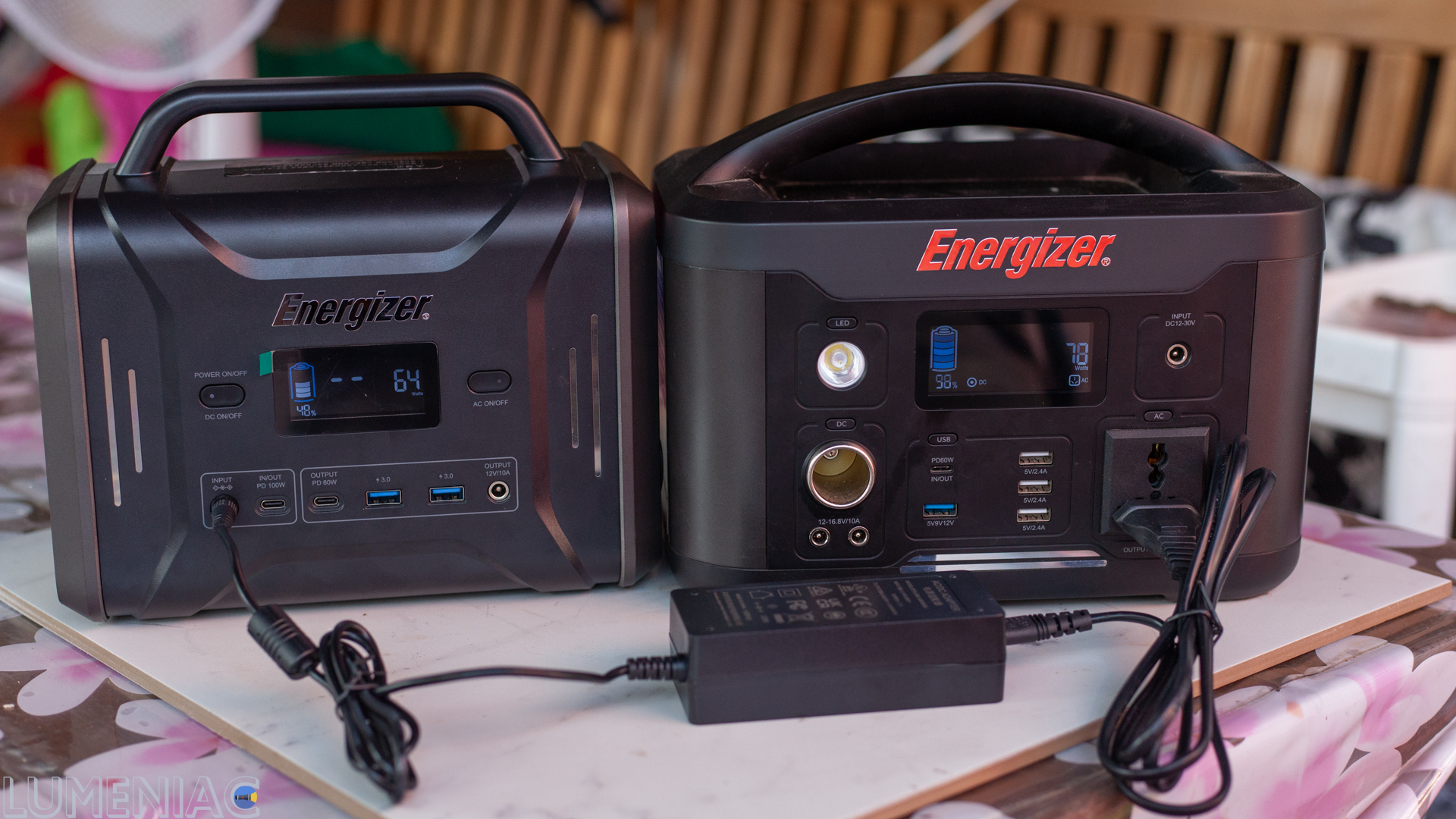

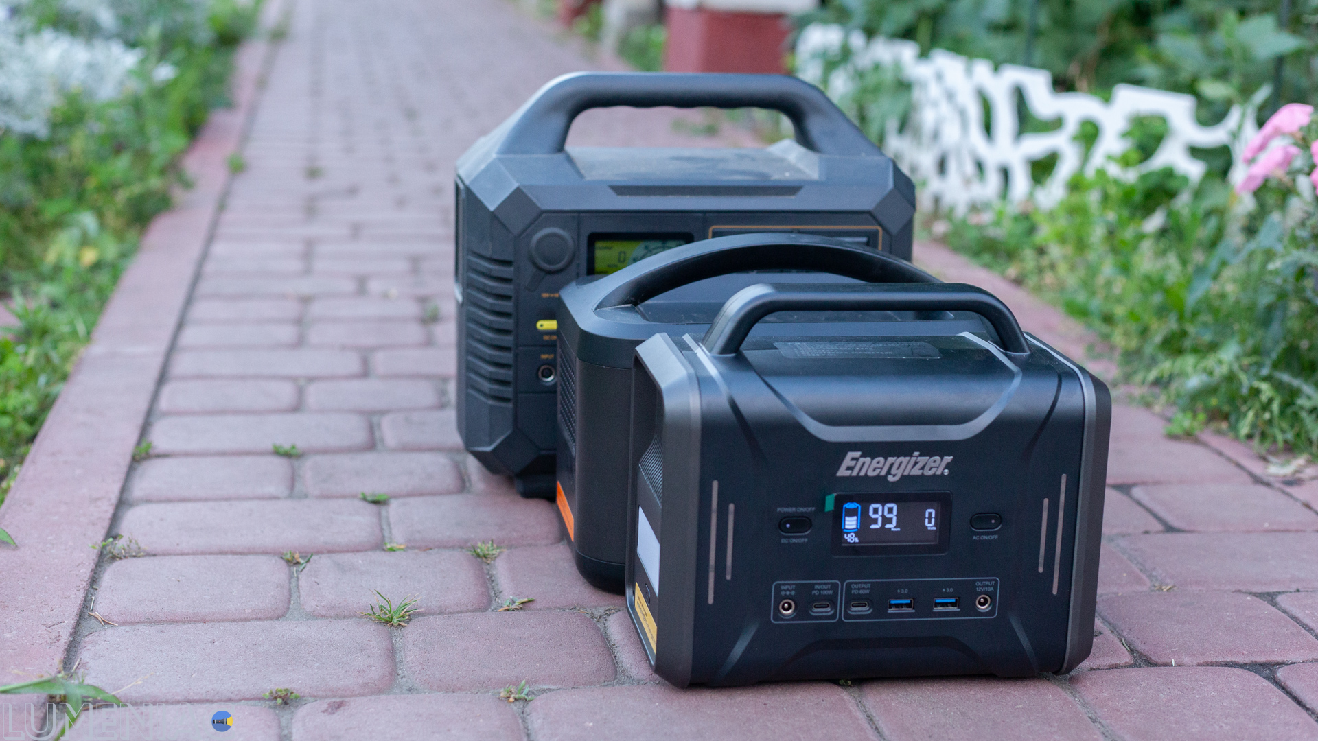

This is my 4th solar generator and they are all made in the same “suitcase” form factor. They differ slightly, only in size, number and location of connectors.
The other two in the photo are Nitecore NES1200 and Energizer PPS700
As you can see, only Energizer solar generatos have light sourse. But only PPS320 has it installed in good and useful place, where you dont need to twist your hand to illuminate path ahead of you.

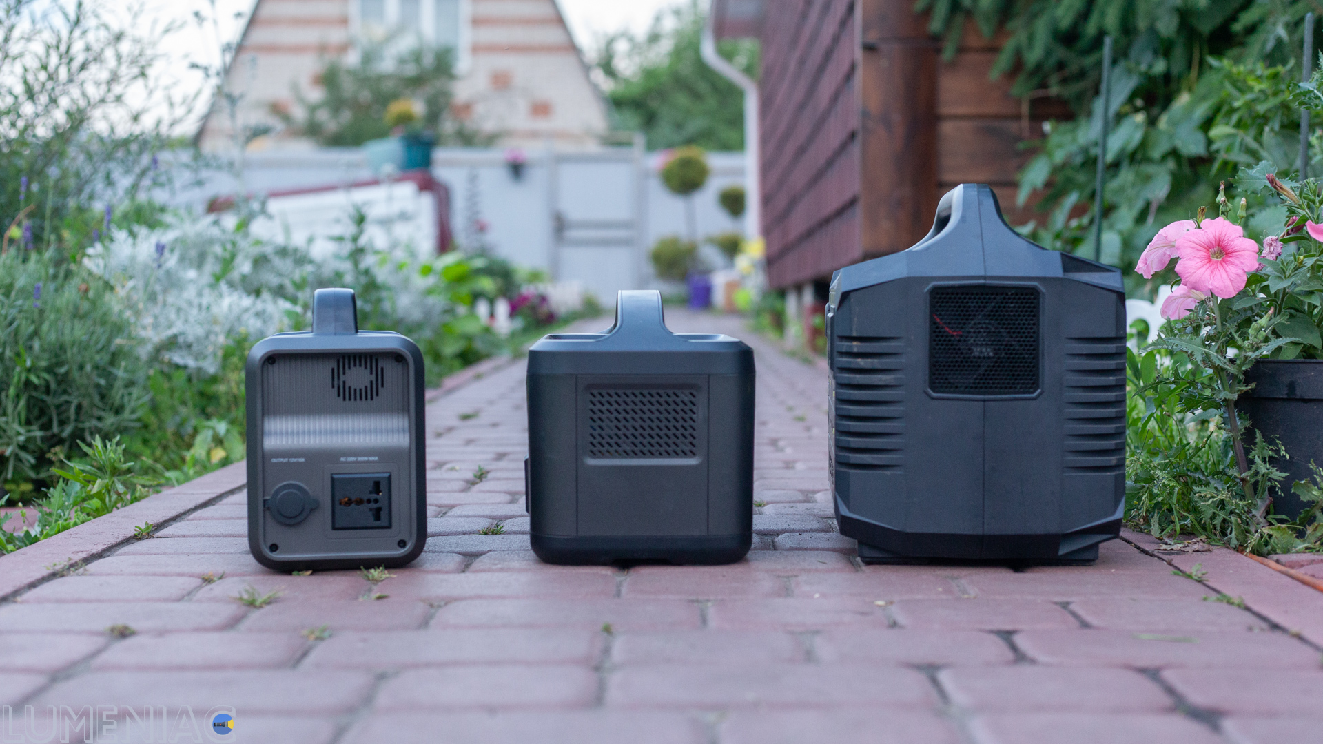

This pair of photos is best illustration of sizes difference between all these models.
What makes Energizer PPS320 remarkable ?

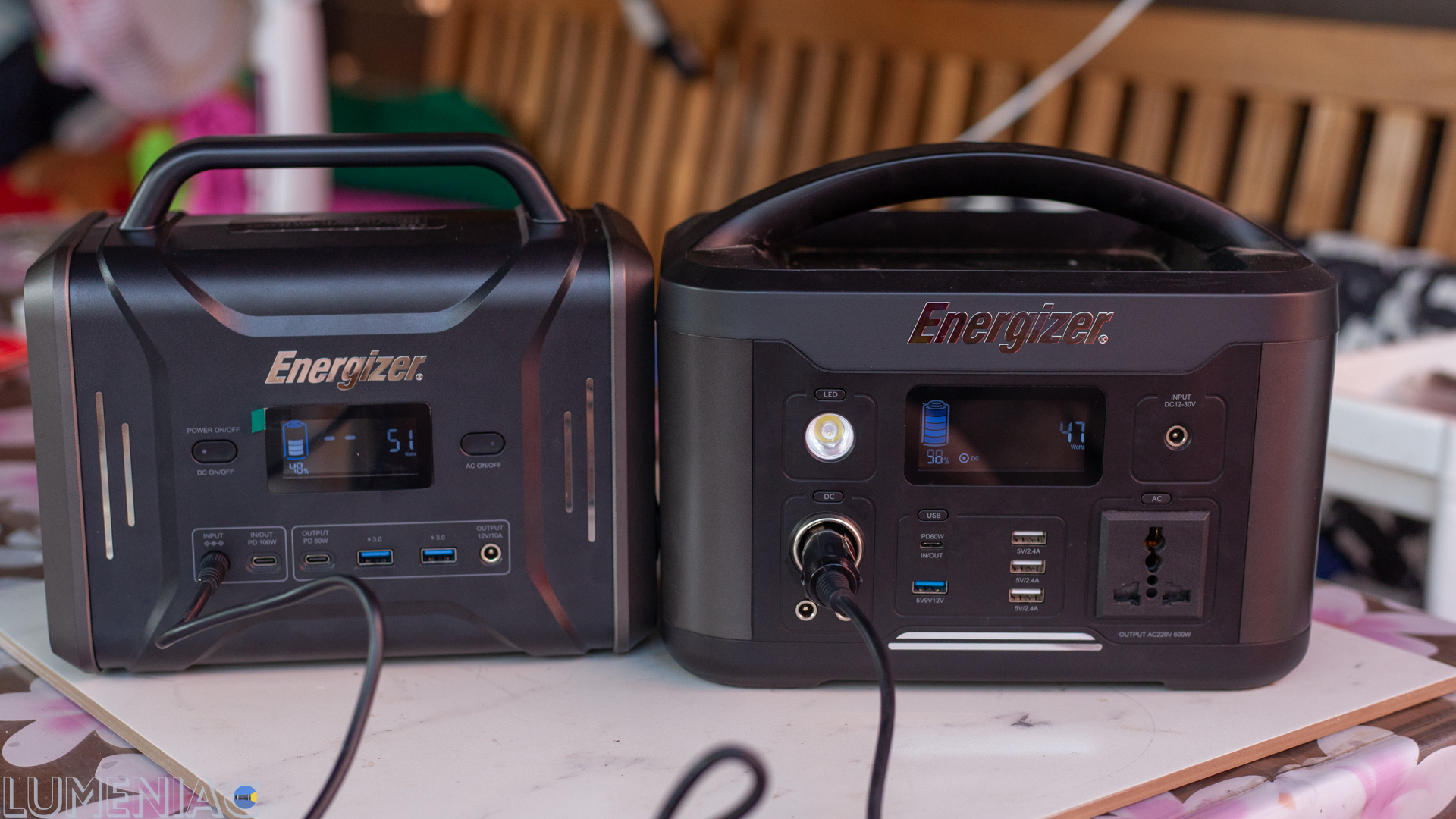

First, the size. Here 230*130*202mm and 4.1kg of weight. Its capacity, and hence the size, is significantly less compared to the more capacious, powerfull and expensvie model.
LiFePo4 has worse capacity\power ratio comparing to Li-Ion. But Energizer managed to produce real power beast, based on this chemistry. I mean Energizer PPS3200. Unbelievable capacity, power and (hell, yeah!) lifetime. You know, there are just few things that i really wanted to have (basically, camera and guitar stuff) and I own all them. So i`m not crazy about buying new gadgets, consumerism is not for me. But PPS3200 is sort of stuff that i really want to have. Hope i get it finally and tell ya what it is capable of.

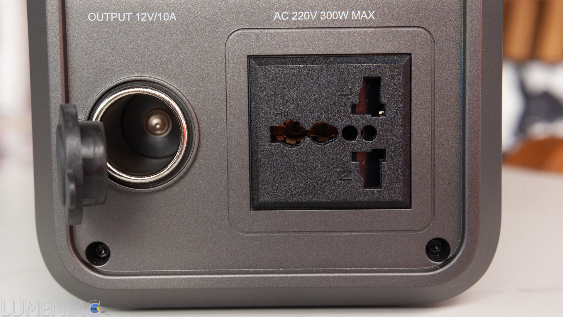

There is a cigarette lighter socket and a 220V socket (pair of 110V for US market) at the opposite side from the LED panel
And I certainly would prefer AC socket to have a rubber cover like the cigarette lighter socket does.

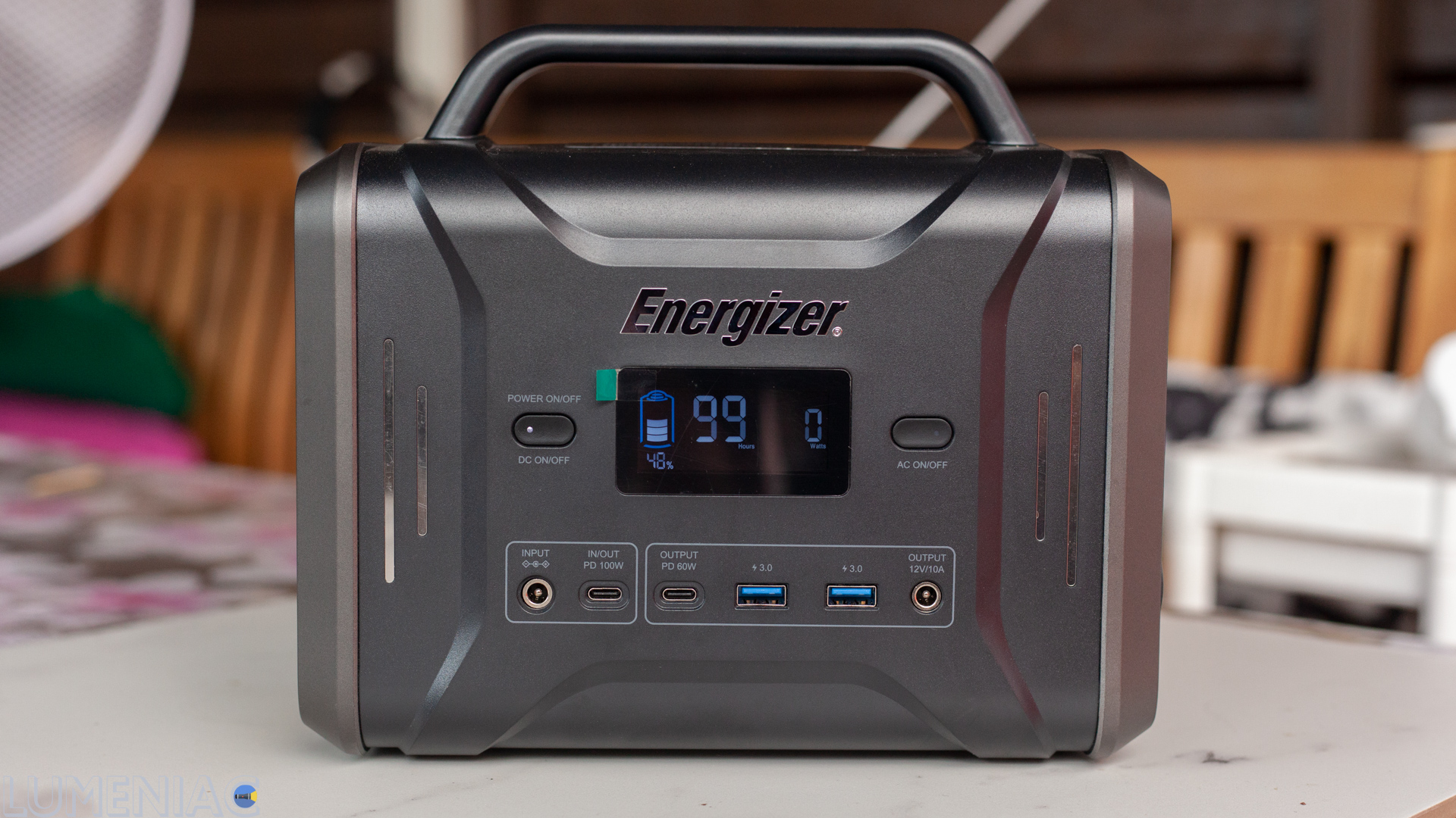

There are something like protruding “X” on the front and rear panels, with mirrored stripes located on the left and right from each “X”. I assume that these stripes are needed as light-reflective elements and to help to locate PPS320 in darkness
Good decision.

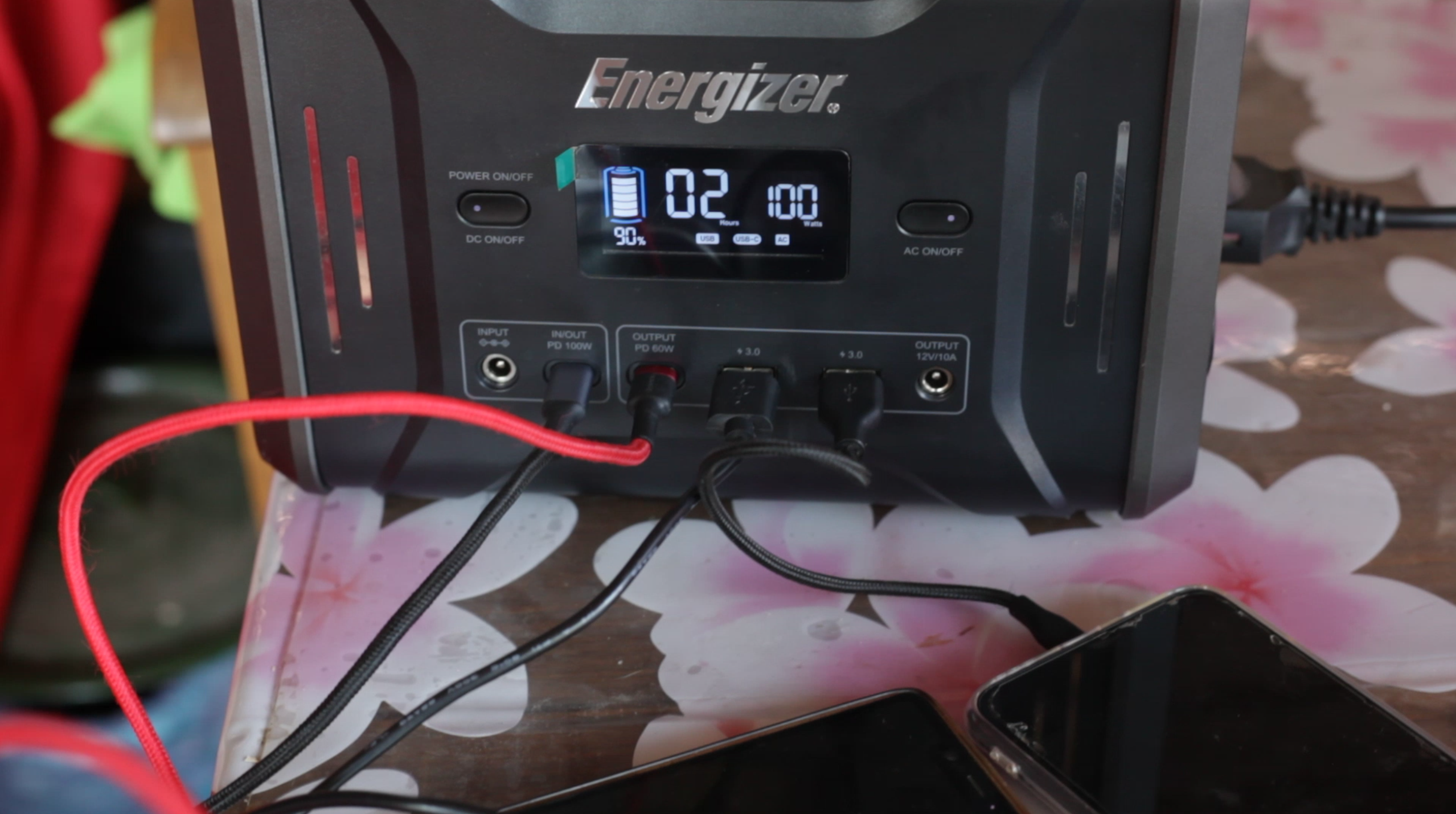

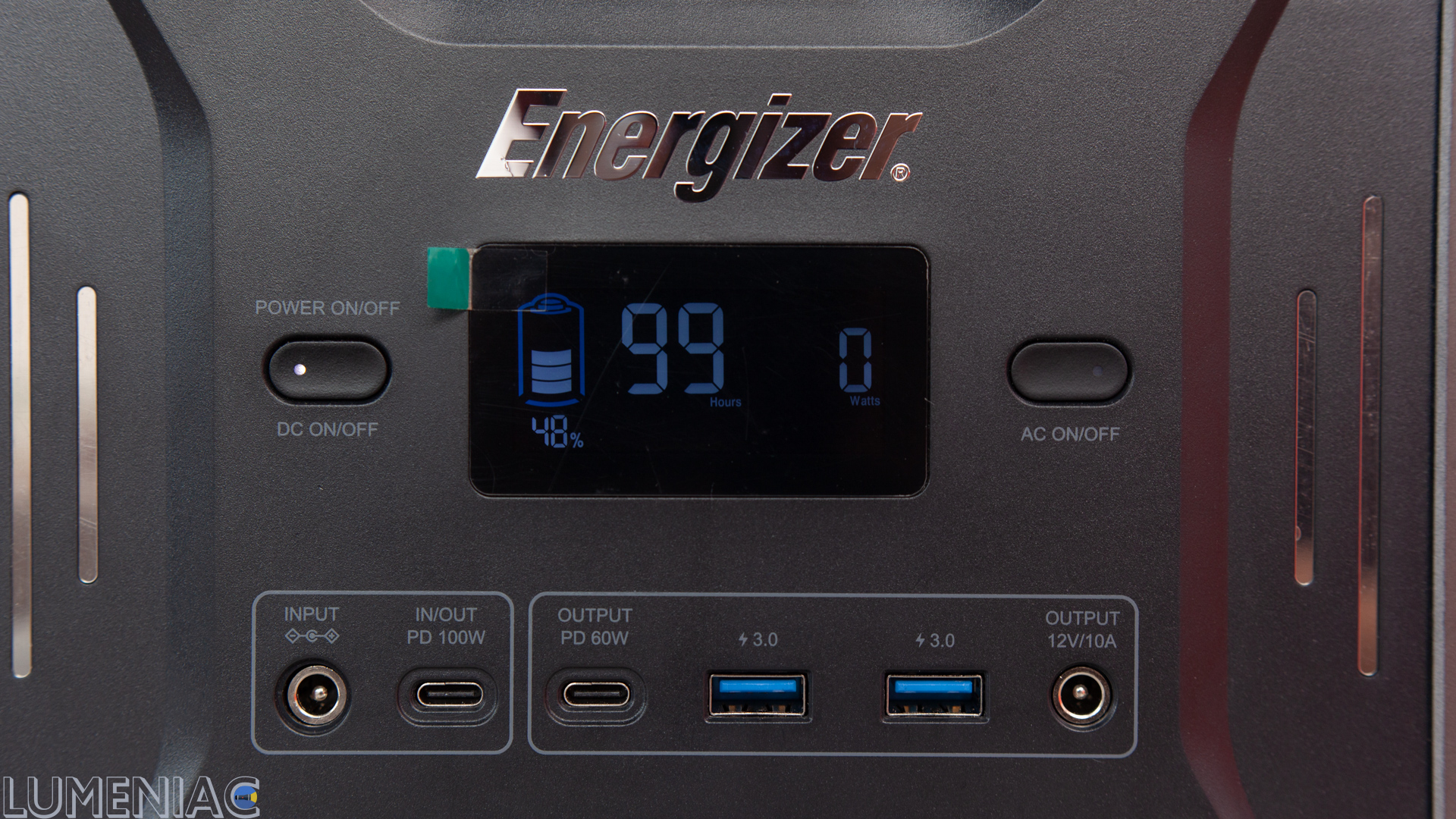

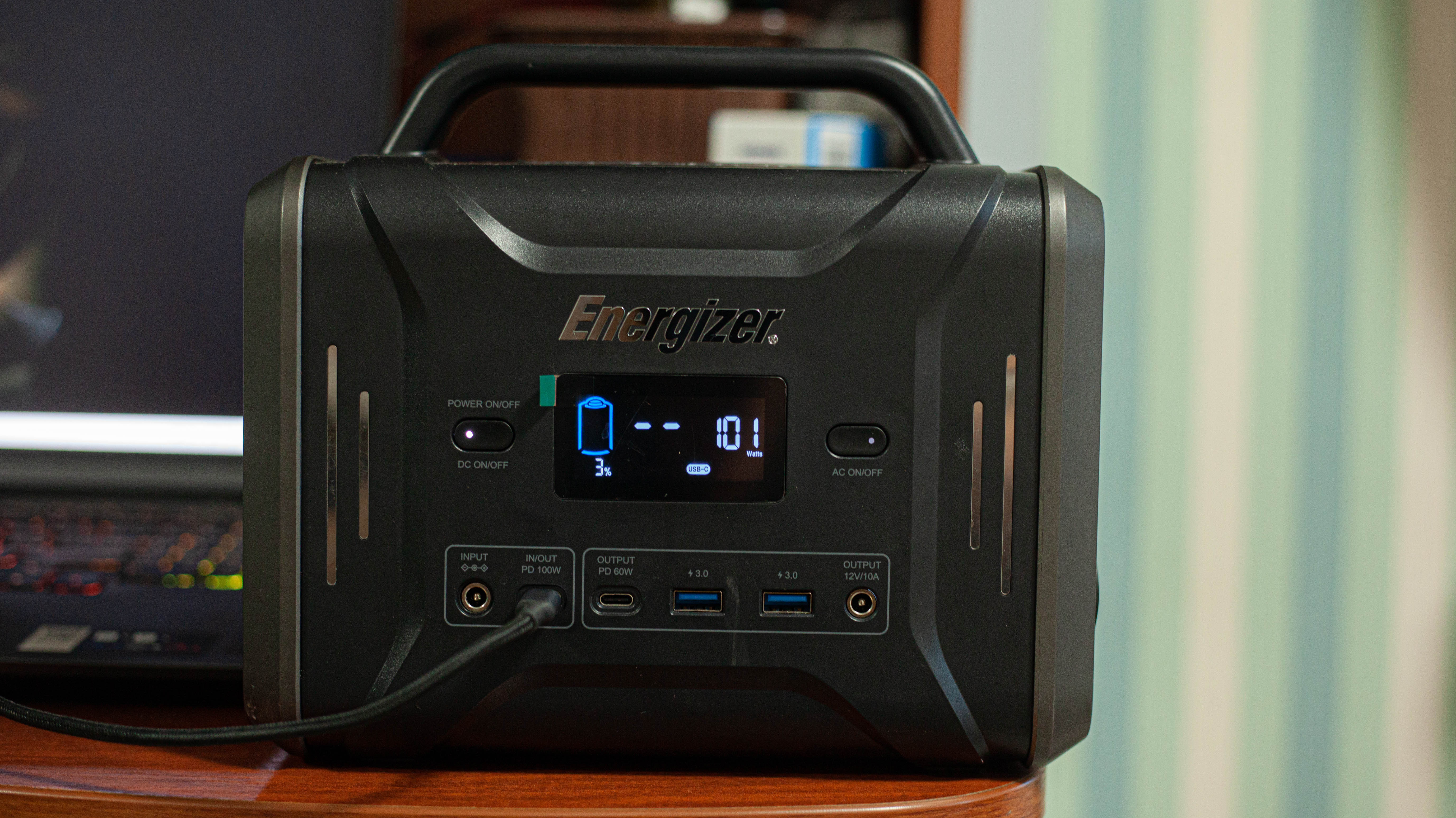

There are 2 groups on the front panel: input and output.
If you chase for ideality, then, I think that DC input pin should be placed between 100 watt Type-C input\output and 60 watt Type-C output. Why ?
Ok, it is dark, and you decide to charge Energizer PPS320, insert the cable coming out of the powerful type-c power supply not into 100W input-output connector, but into the 60W OUTPUT. Not that the solar generator will break then, no. It will just beep, reporting an error, and turn off. But if it is possible to separate the same-looking input and outputs, then it is better to do it. I also think that the outlines and letters could be printed with phosphorescent paint. However, no one bothers you to attach a couple of phosphorescent stickers yourself. I would stick one under the entrances and one above the exits.
Next to the 60w Type-C output are a pair of USB-A connectors with a total maximum power of 18 watts and a standard 11.2-14.6V/10A DC pin output.
The screen of the PPS320 is smaller than that of the PPS700, but it shows more information. The fact that it shows error codes is not so important. It is important and convenient that Energizer PPS320, like Nitecore NES1200, shows the remaining runtime and current power output
The rest is the same: the percentage of charge and the connectors used.
Nitecore NES1200 and Energizer PPS700 have their own switch for each output type: USB, 220, DC. In case of Energizer PPS320, all output connectors on the front panel are immediately available immediately after turning this solar generator on. The second button turns on only AC and cigarette lighter located on the side.
The last thing I will pay attention to. Since PPS700 is larger, it has a platform under the handle where you can put a charging smartphone. This is actually convenient. Energizer PPS320 does not have this just because it is more compact.

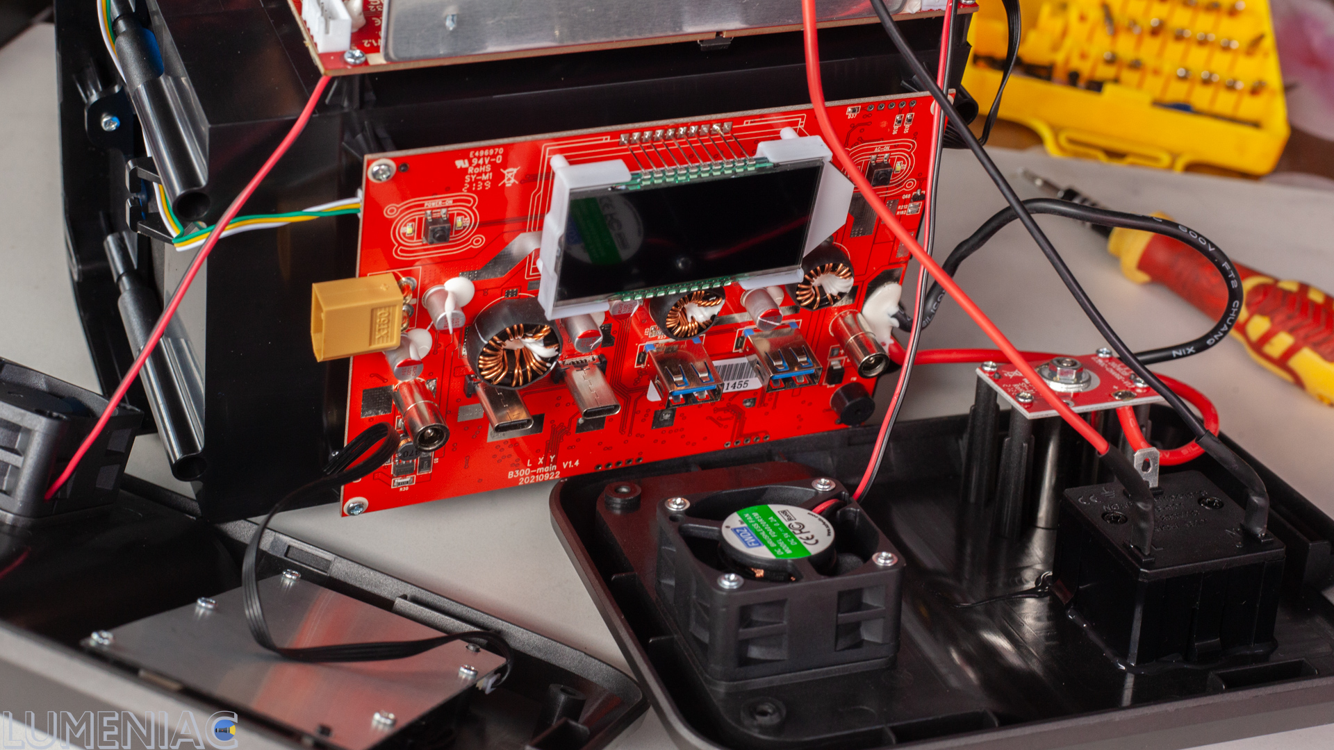

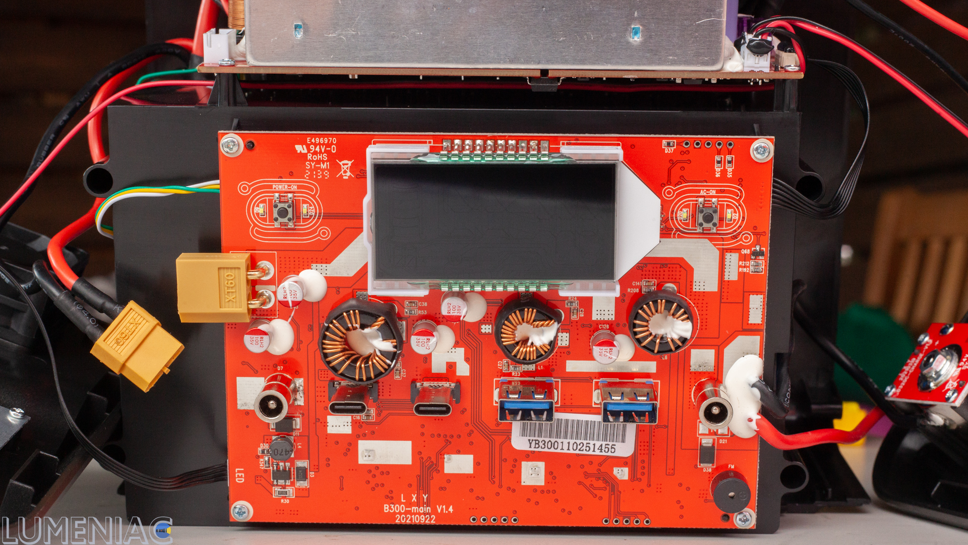

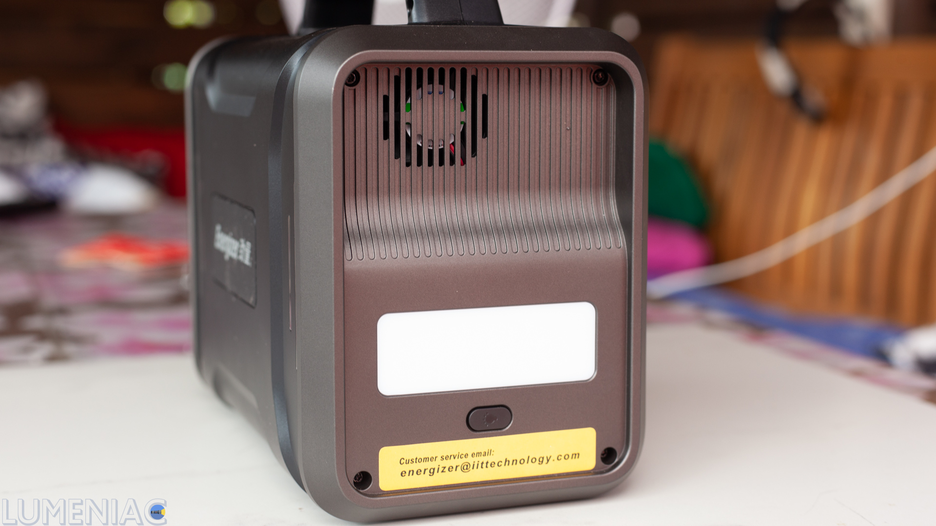

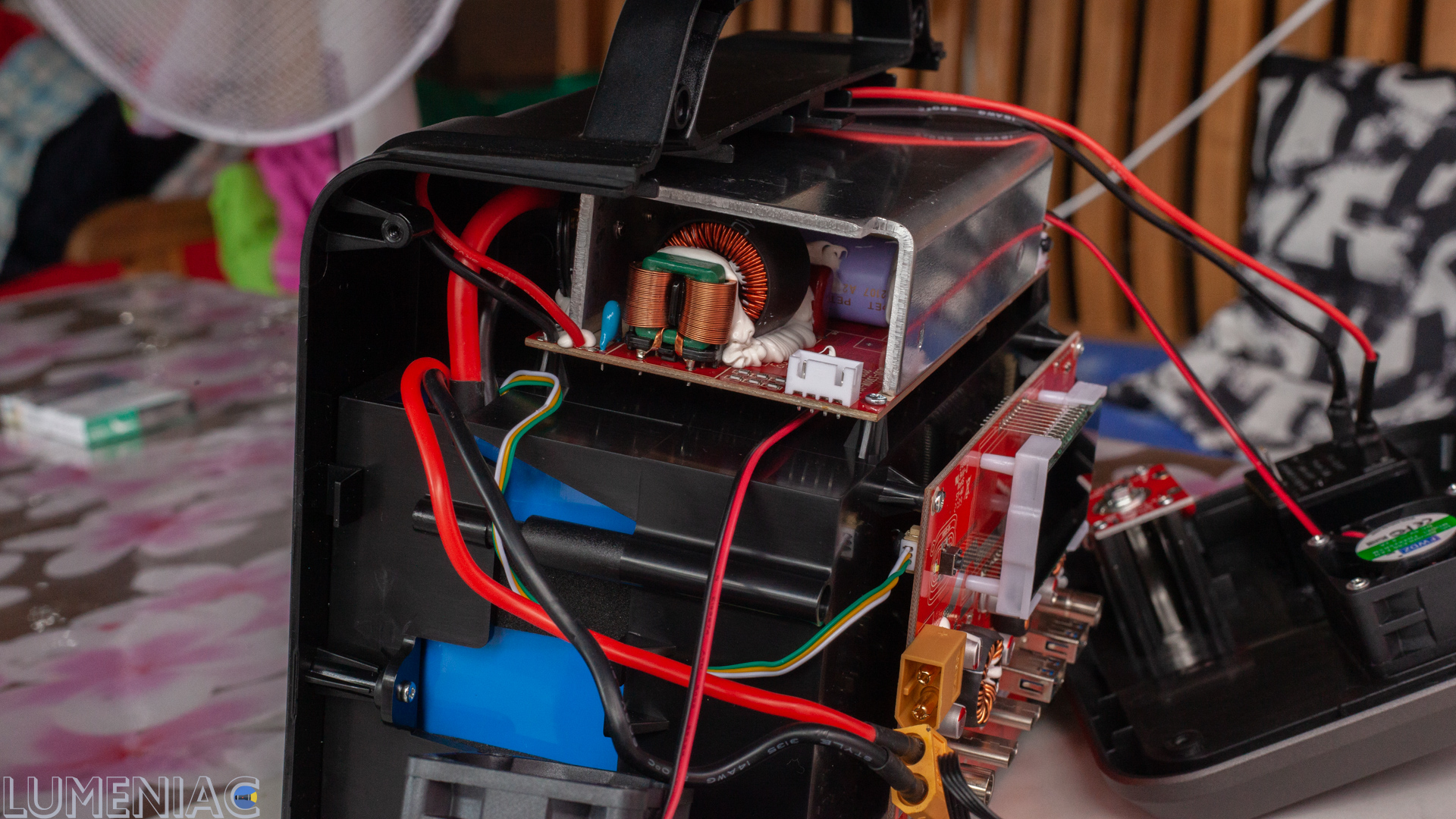

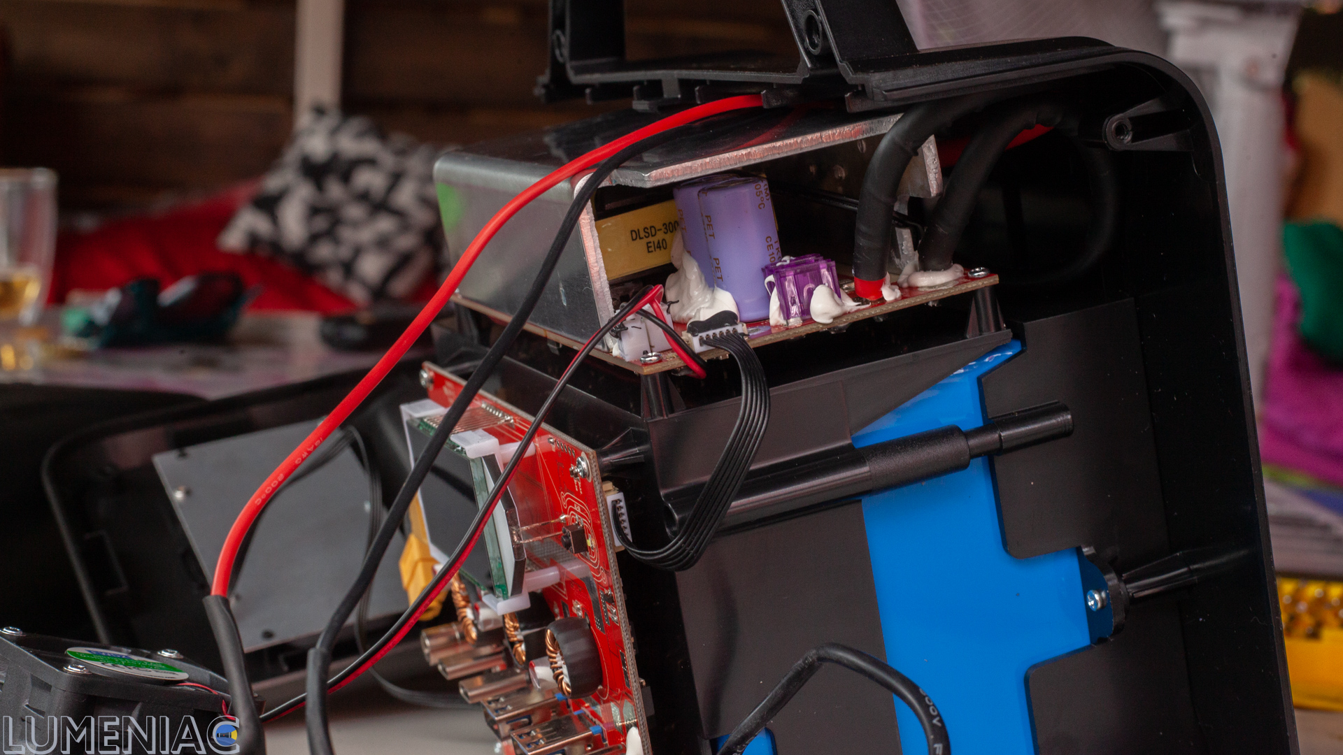

Finally, Energizer PPS320 can be disassembled. This will require a regular Phillips and torx screwdriver.
I didn’t manage to completely disassemble it, but I think that fans of electronic dismemberment will find something to say.
The LED panel is not very bright, manufacturer could have made a plastic powerboard. But no - they used metal \m/, as it should. Well done.
Unlike all my other solar generators, Energizer PPS320 does not use an set of 18650 li-ion batteries, but LiFePo4 instead.
The disadvantage of this chemistry is a lower capacity and power output comparing to Li-Ion of the same size and weight. .
But LiFePo4 has another and very significant advantage - fire safety and life-time. This battery can withstand 10 years or 2000 charge-discharge cycles before the capacity drops to 80%! A colossal advantage.
Also, LiFePo4 is not so afraid of a deep discharge.
Once again, think about it. You buy this solar generator when your kid goes to the first class in school. You start to use the generator, discharging and charging it almost every day. And after these 10 years of school your kid graduates. And battery is still in perfect working condition.
Another noteworthy point. This solar generator can be easily disassembled. And it only has a few LiFePo4 batteries. Swapping them out for new fresh ones after dozen years, when the time comes, will be a lot easier than resoldering 50-60 pieces of 18650 Li_ion batteries.

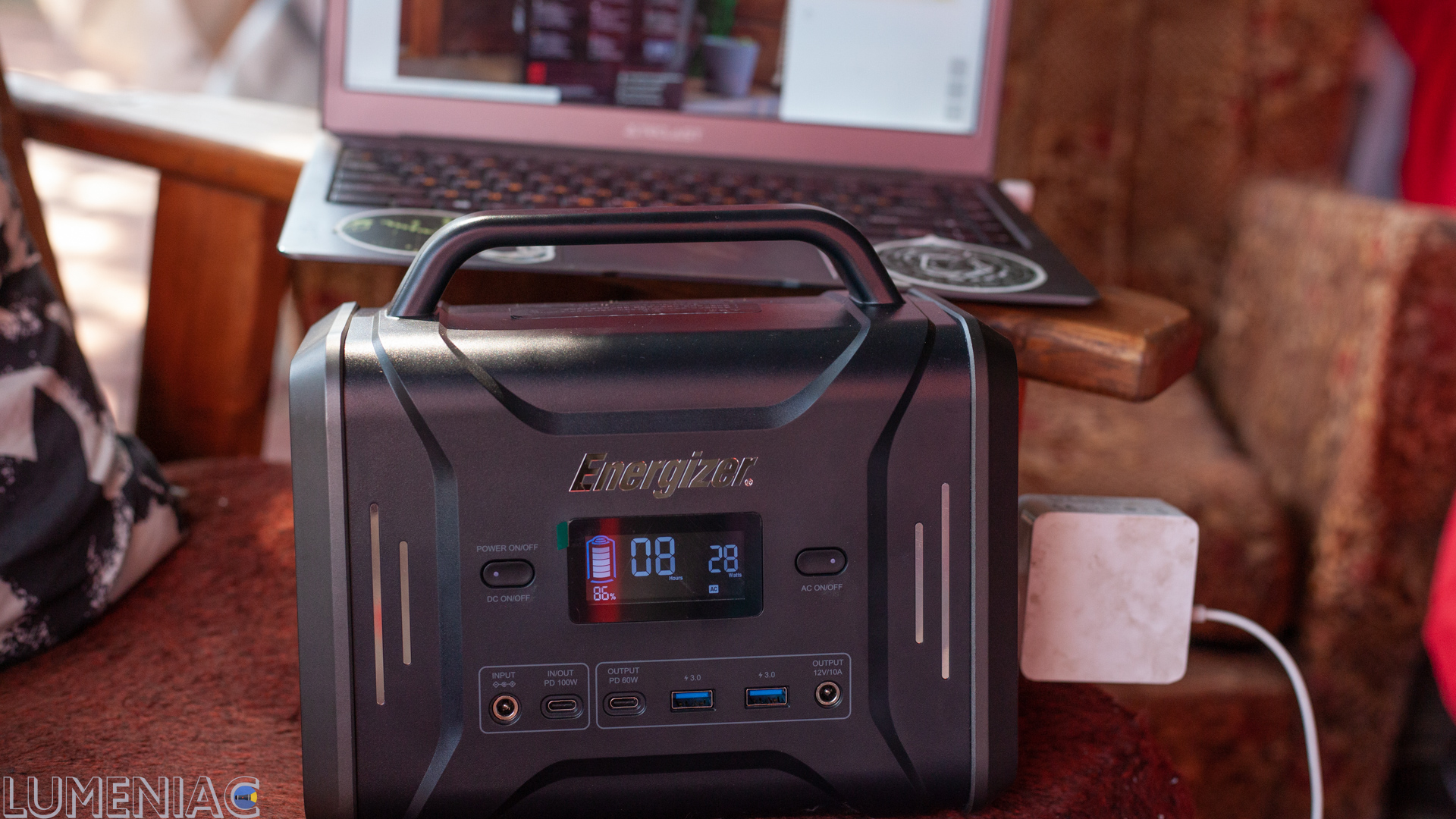

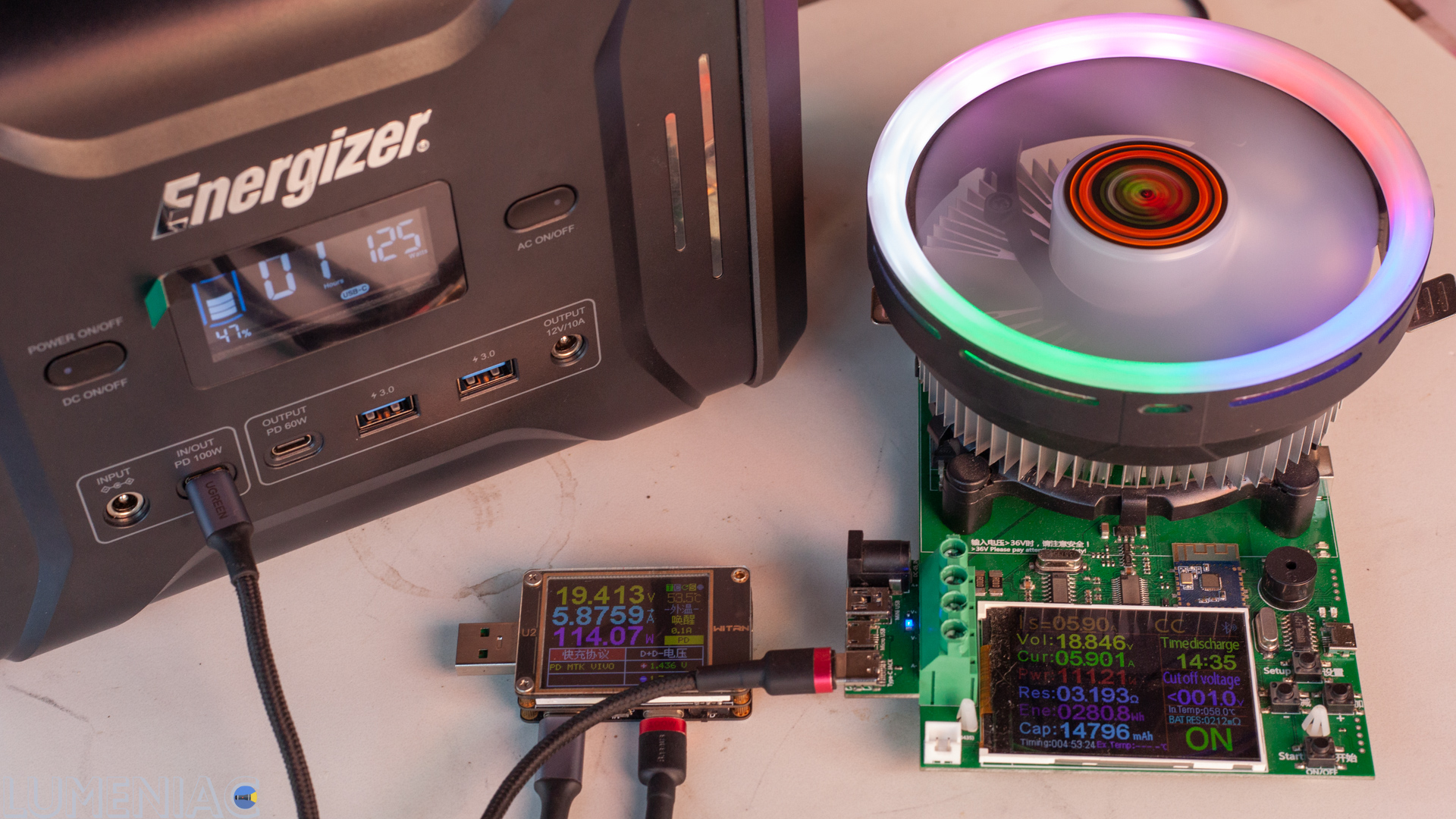

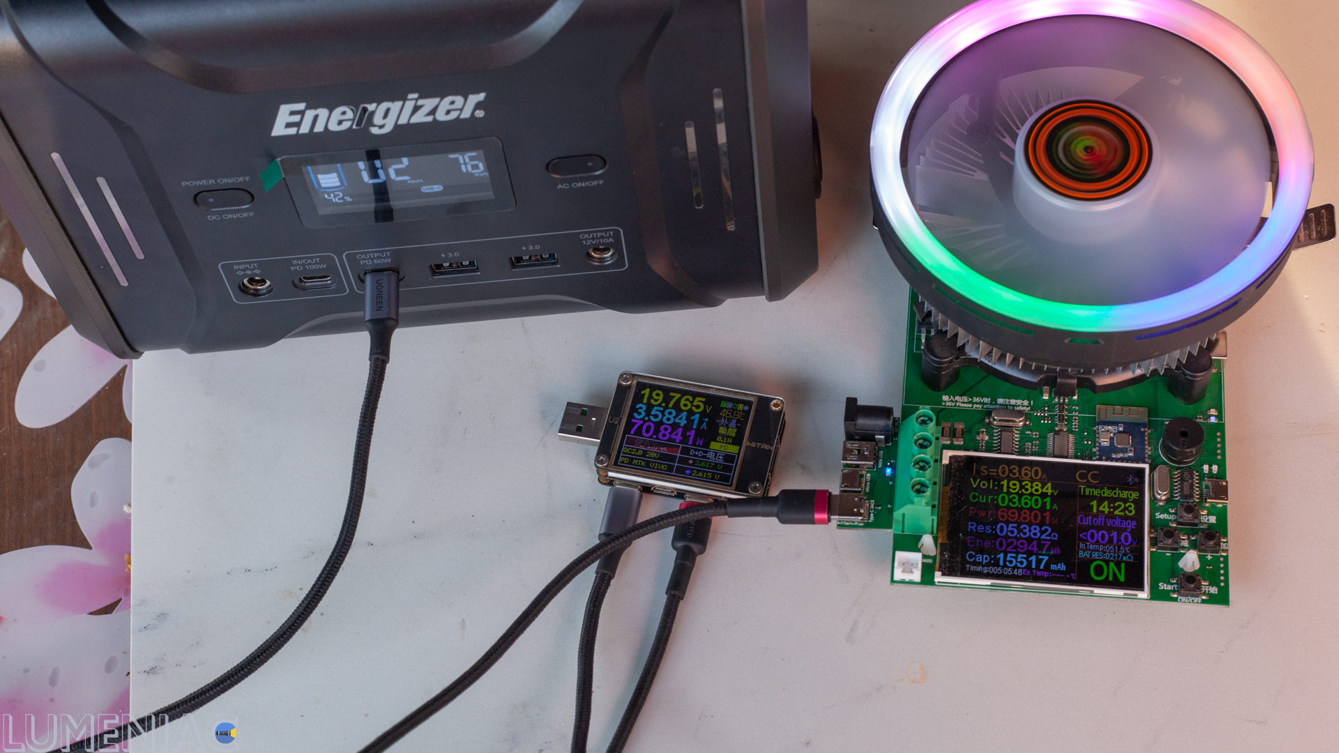

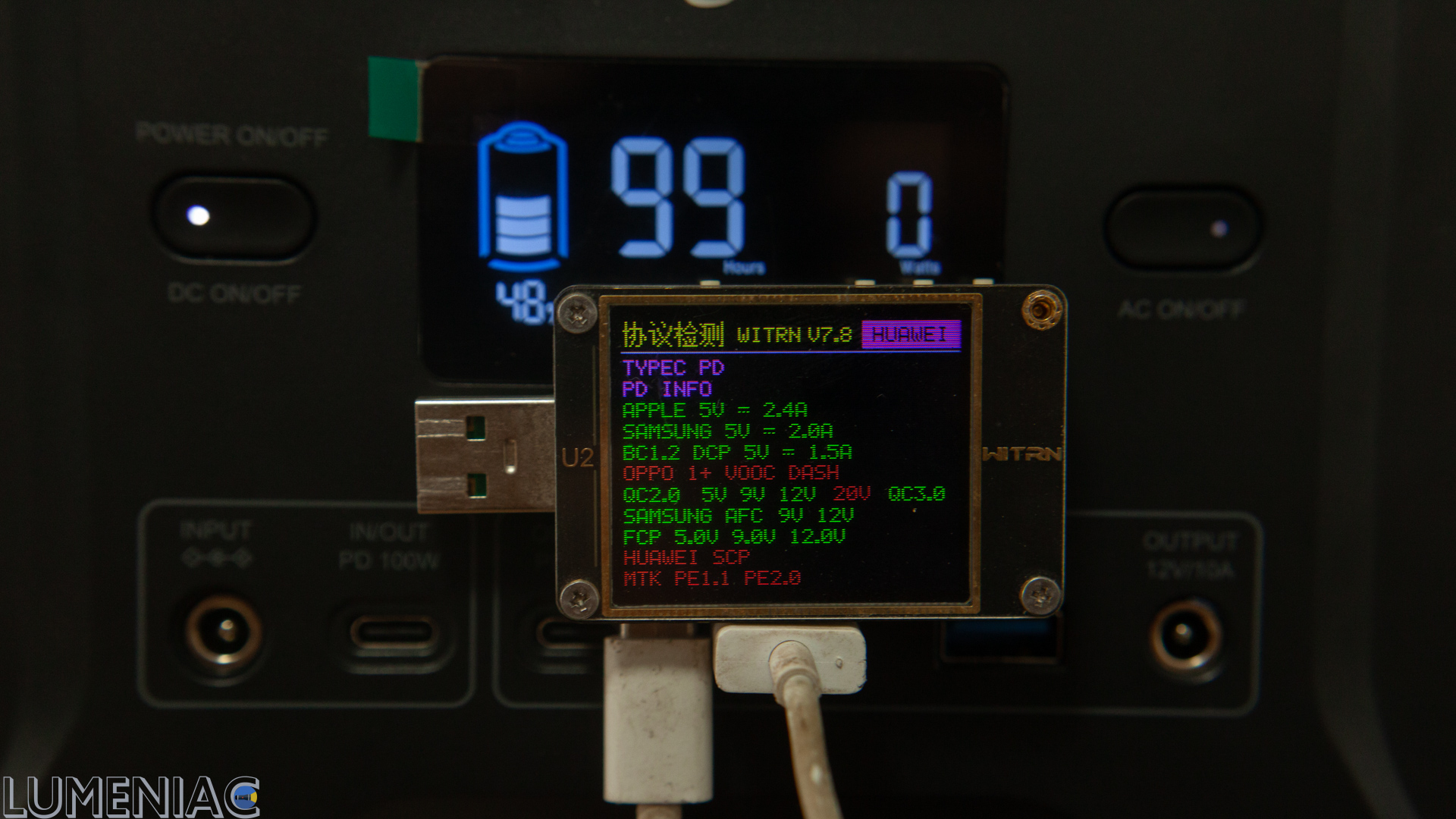

Energizer PPS320 really gives in and out 100 watts. And this pleasantly surprised me. More powerful and capacious Energizer PPS700 solar generator is for some reason limited to 60 watts. Not enough for my laptop, one video card of which consumes 130 watts, I have to turn on 220v AC.
Immediately, 100 watts through Type-C allow you to fully work in reduced performance mode. Although, sorry, what 100 watts? The tester showed that the Energizer PPS320 turned off at 114 watts at the declared 100 and at 70 at the declared 60 watts for the second Type-C connector. Excellent result!
Charge and Discharge

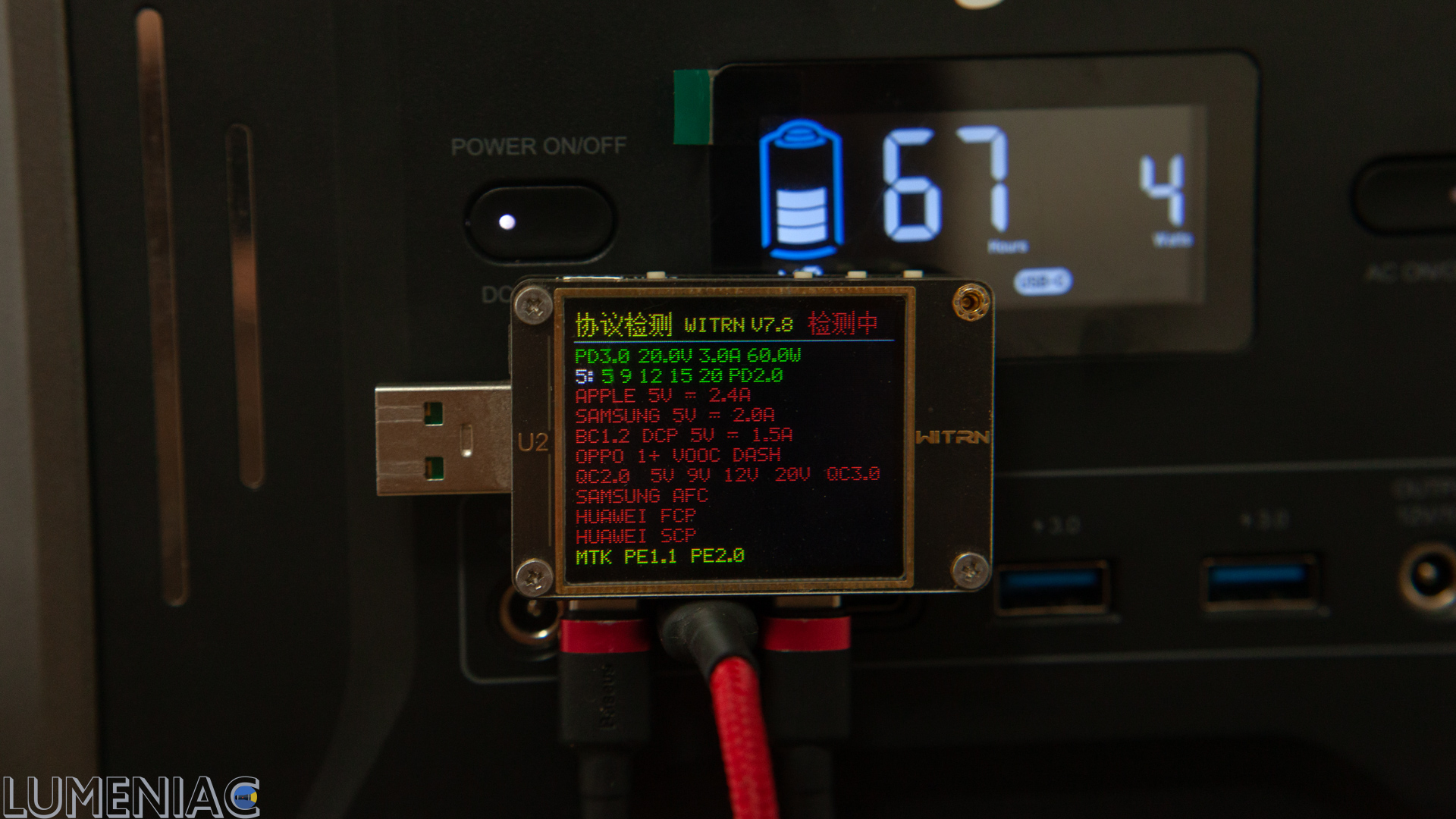

The power station when charging through the DC pin will not take more than 60 watts.

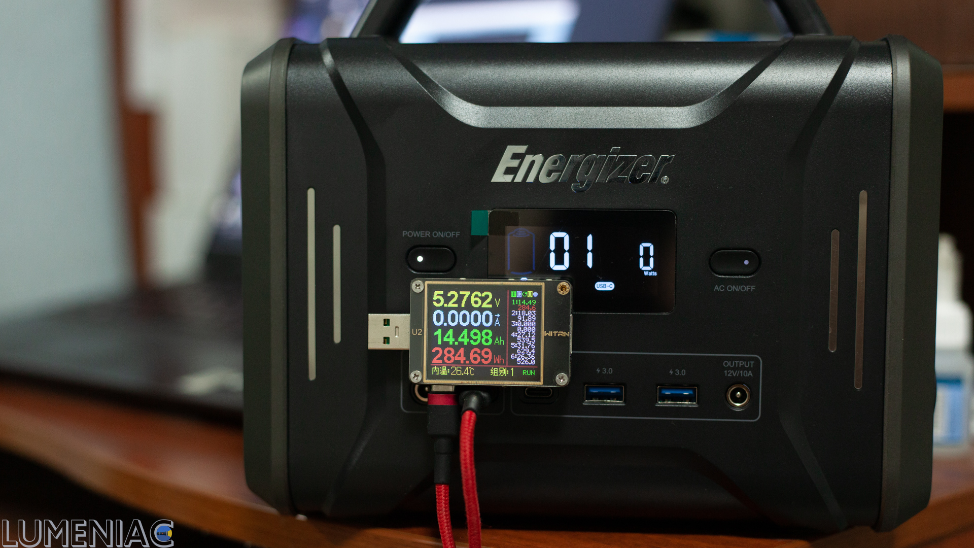

But with Type-C PD, the situation is better. I have already reviewed a powerful GaN charger for smartphones - Ugreen GaN 100w (review). Wit it Energizer PPS320 takes the declared 100 watts in
No matter how I tried, I could not run a 100 watt charge through the tester to show the charging time in this fastest mode on the graph. (it takes around 4 hours)
the rest results are perfect
The solar generator gives out 284 watts*hour vs declared 320w*h with 100w load, a good result. It would be interesting to see how much it gives in 220v mode, but a smart socket with a watt*meter is only on its way to me.

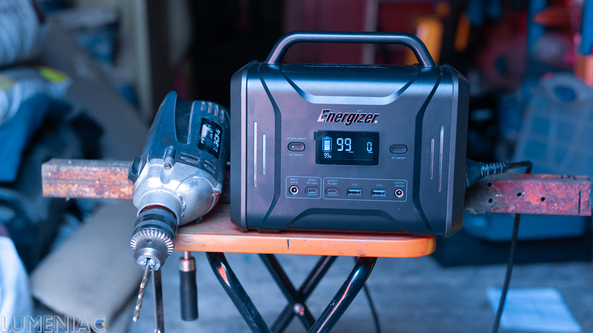

For example, a drill. 250 watts, it is quite possible to use it, in case of urgent need. The video has an example of work. Although, of course, who would buy such a beast power plant for the sake of being able to use a drill?

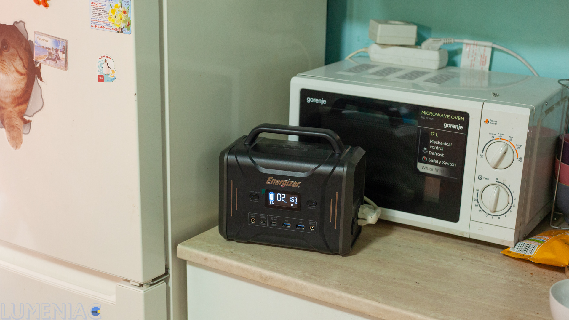

Something less powerful? As it turned out, the Energizer PPS320 is enought for my Indesit refrigerator in countryhose. Given the fact that it does not work constantly, refrigerator will work much longer than the time on the display. But the old Soviet refrigerator, the compressor of which periodically jumped above 400 watts input, worked unevenly.

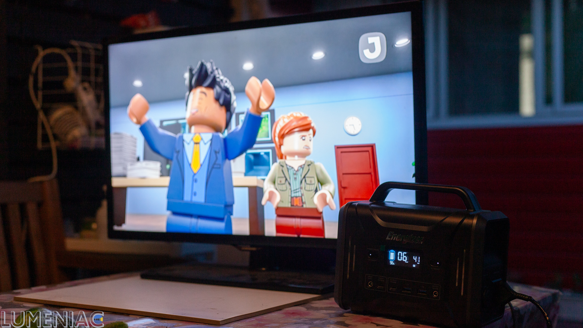

TV? Yes, it’s easy! 40 watts and 6 hours of operation from a full charge.

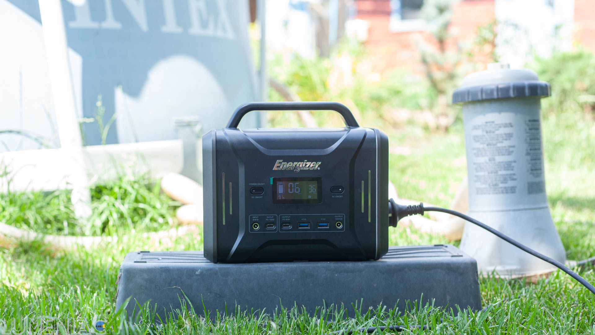

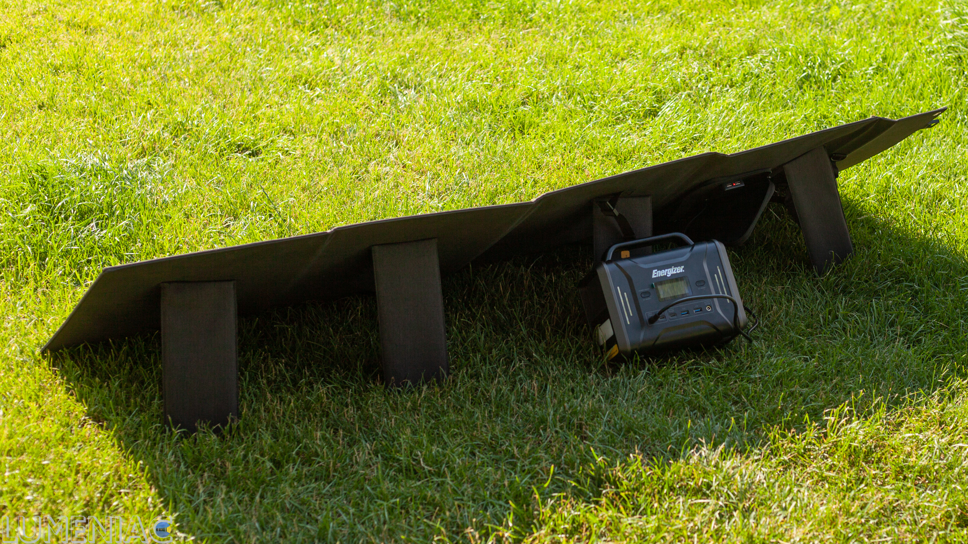

The pool filter consumes the same amount. There is a wonderful feature to mention. You can connect a solar panel to this portable power station and turn AC output on. If load is lower then input from solar panel, solar generator will not discharge. Really cool. You can use AC output, and charge solar power station at the same time.

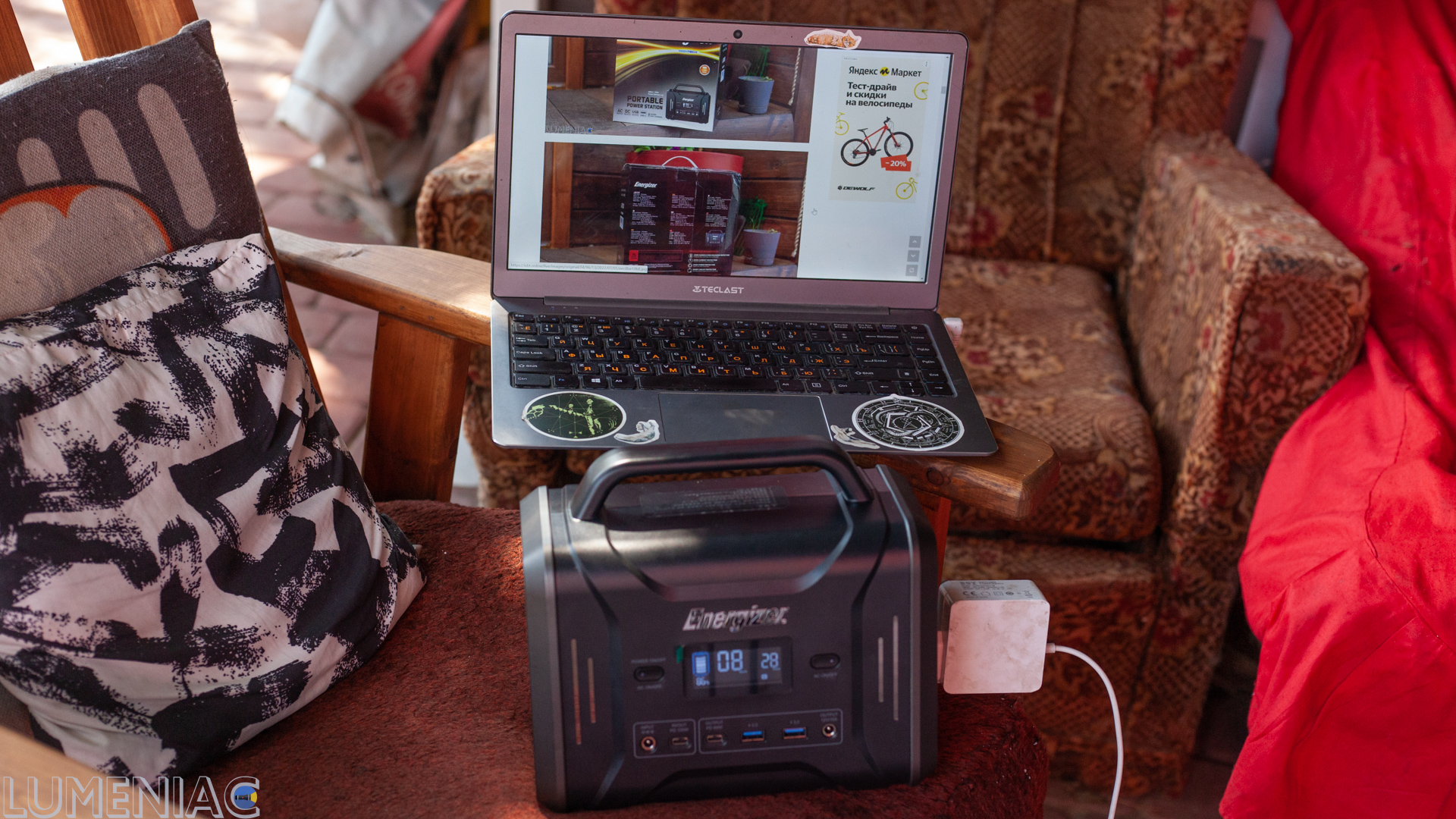

Notebook? No problem.

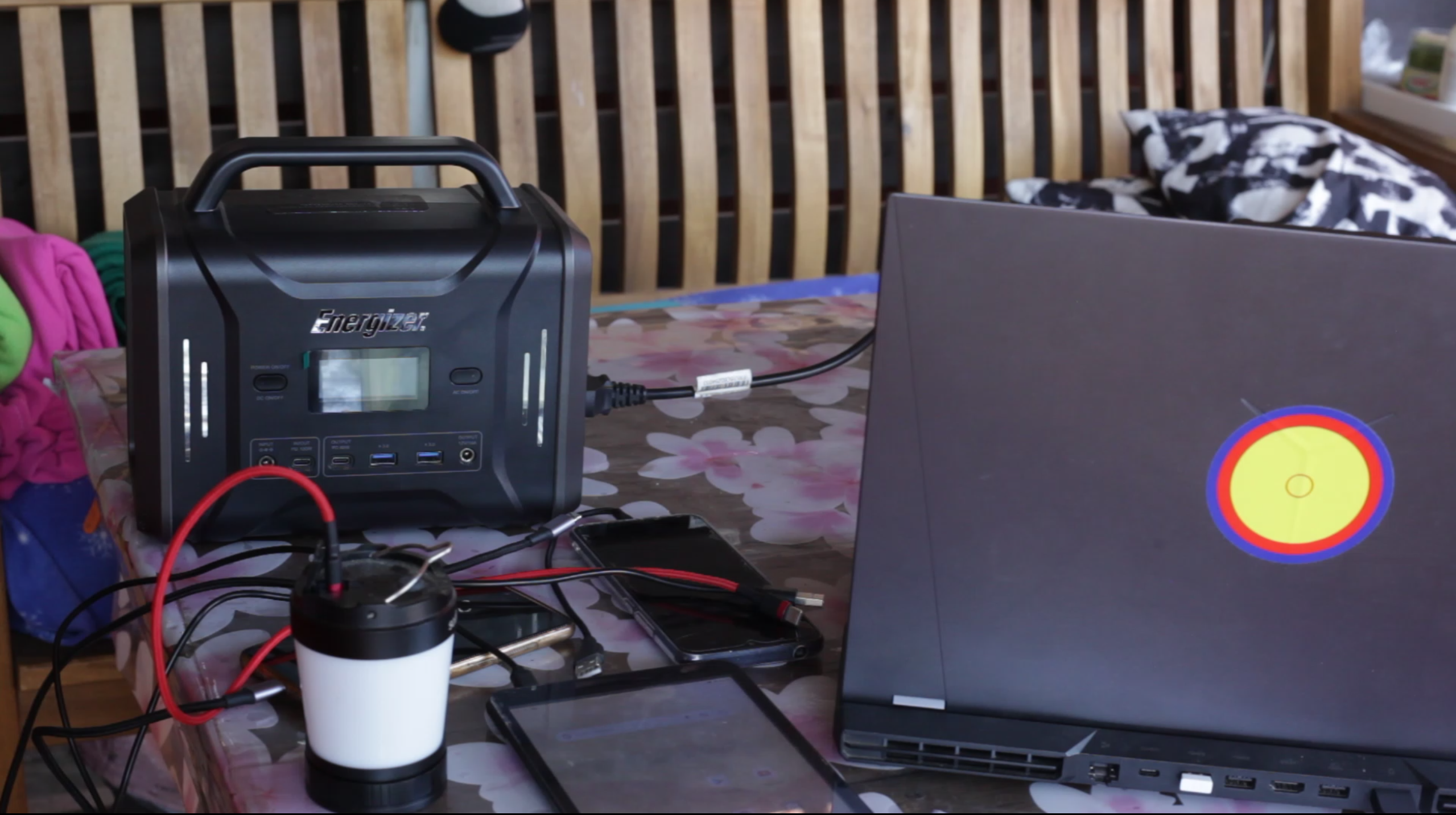

And here is a rare use case that I recently encountered. The electricity was down for several hours, but wife insisted that she needed wi-fi. It turned out that if i connected a router and “this box for optical fiber” to solar generator, then Internet appears. Consumption is frankly symbolic, like 13w.
And, of course, a bunch of all sorts of phones + laptop
