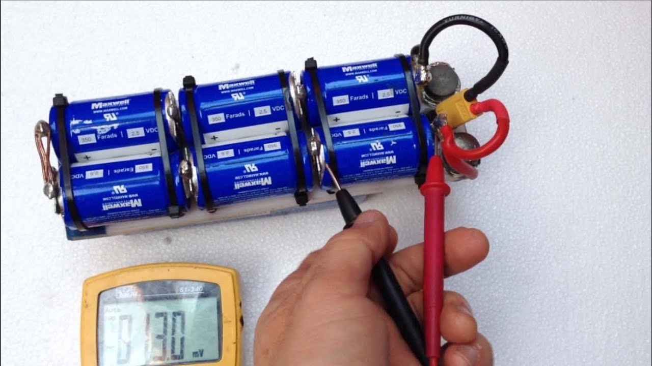

Why…2.1vdc (I could understand if they were 1000Vdc caps or something)
A guy ran a 400watt power inverter and drilled 6 holes in 3/4” plywood from 6 paralleled 35F capacitors (his are 350F)
Dude is doing some AMAZING things with these…and he was the first to start playing with the capacitor starter deal…he even came up with a novel balance circuit to ensure the caps stay fairly close in charge
Go to about 6:10
His Joule Ringer is utterly amazing!
