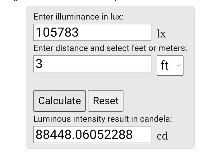

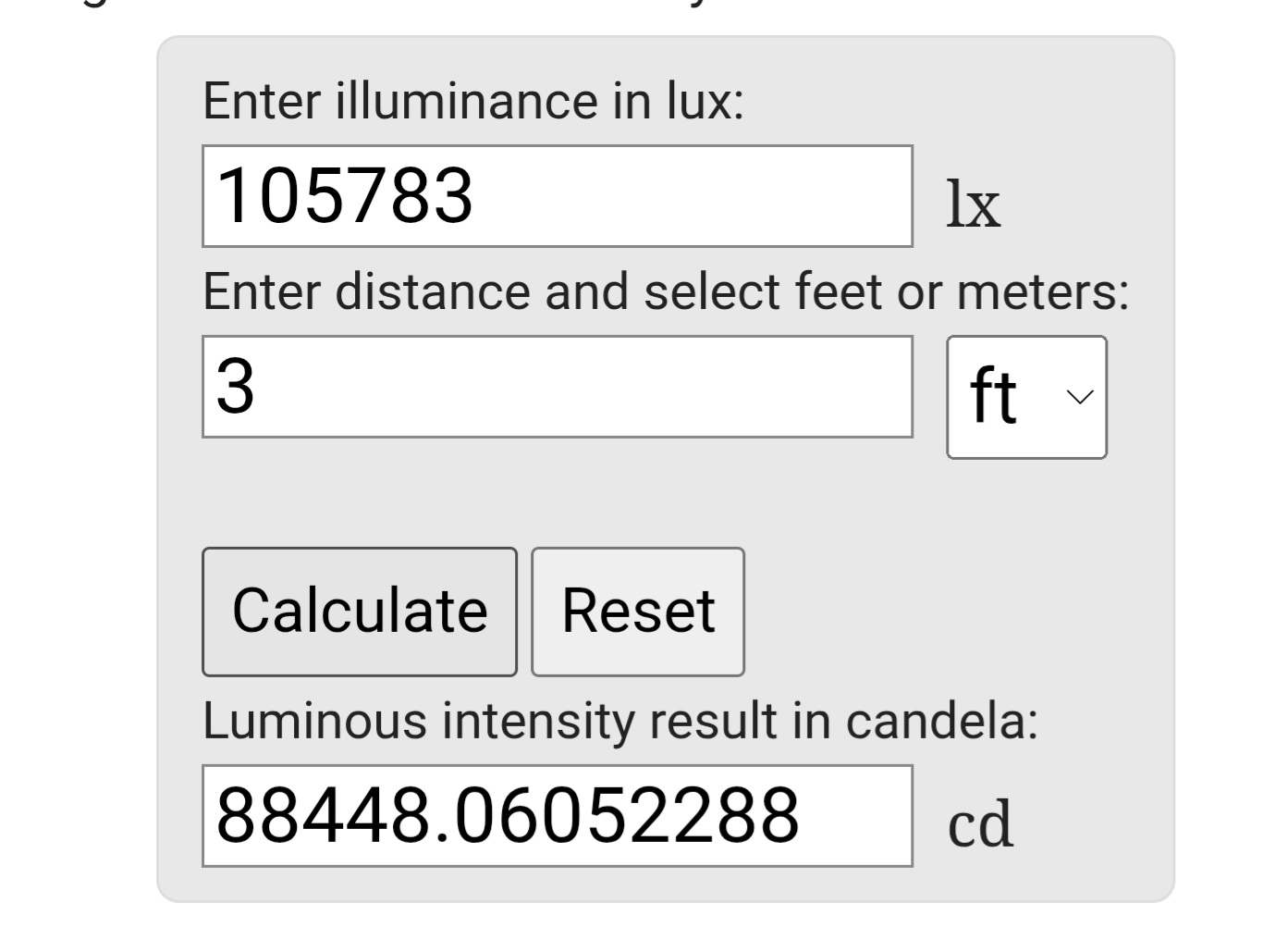

M21E has the same reflector as the C8, here is my LHP531 in 4000k @10A
Or 595 metres.
Thanks for doing the math, i just happen to have this screenshot from when i was curious about the candela for it about a month ago. It’s not too bad while still maintaining a good amount of useable spill.

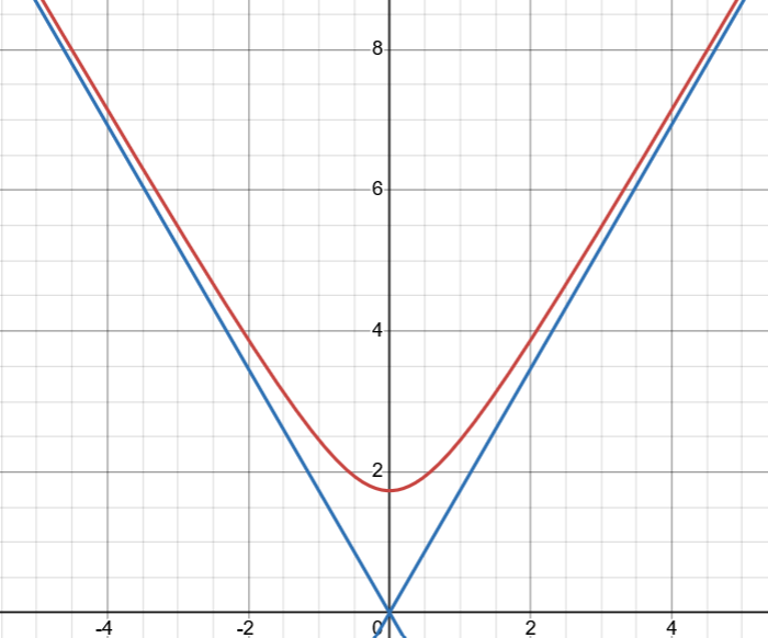

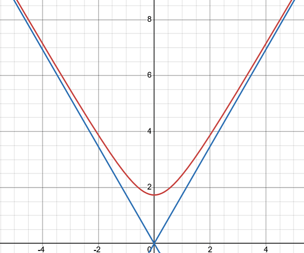

How did you measure the beam angle?
I’ve got a C8, which uses the same reflector as M21E, and got around 60 degrees, not 80. This is also consistent with the reflector’s sideways dimensions, being close to an equilateral triangle.
Interestingly, Convoy’s page for the reflector lists the reflector height as 31.5mm, which is incorrect. The true height is around 34-35mm, but I don’t enough enough measuring precision to determine the next few digits.
I just used ruler and measure the two lines that formed the border of the spill. I think someone asked me to measure it that way. Is that not correct?
I think the tricky thing is that the border of the spill is not a pair of lines, but a single hyperbola:
What you want to measure is the angle between the blue lines, but you only get to observe the red curve. If you measure the angle too close to the vertex of the red curve, as you can see the resulting measurement angle would be too wide.
I couldn’t think of a nice way to do this measurement, other than performing the measurement very far out, where the red curve becomes very close to the ideal pair of blue lines. Or deducing the beam angle from the reflector’s geometry.
