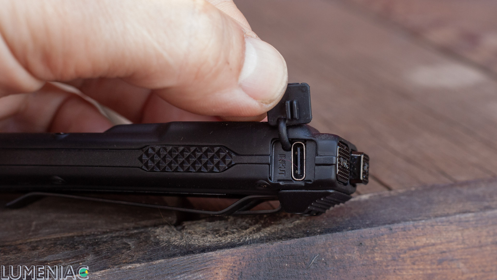

In addition to the flashlight itself, kit includes a manual and a type-c charging cable. Everything you need, actually

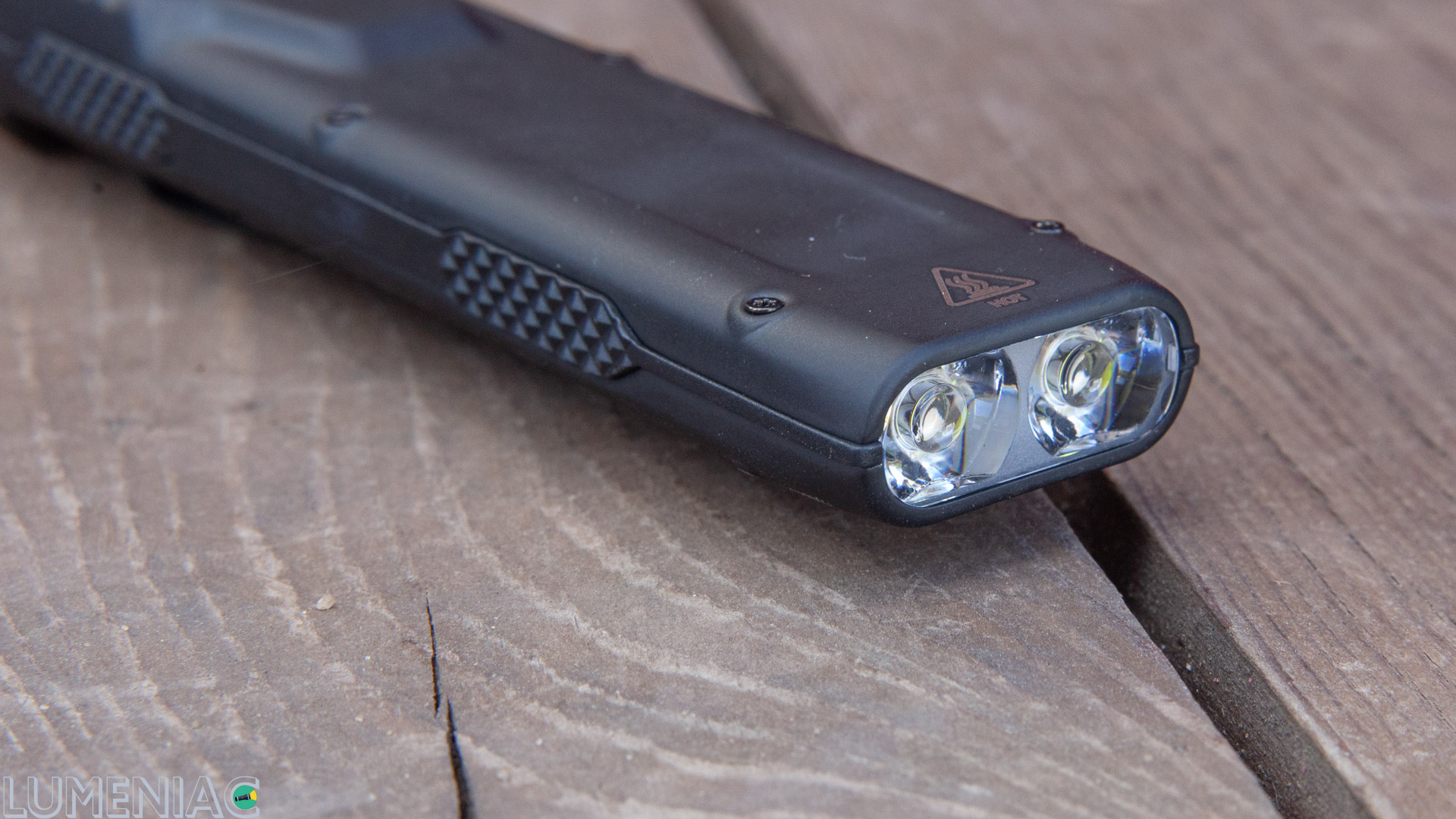

Yeah 13.5cm length may seem to be too long. Well, Nitecore EDC27 is longer that definitely not compact Sofirn SP35, a popular budget EDC flashlight with a 21700 battery. But! Things look very different when the Nitecore EDC27 is turned sideways. And here it is only 14.2 mm - for many, this flashlight will be convenient even in a pants pocket.
The design of the Nitecore EDC27 borrows a number of ready-made solutions. Something from Tini2, something from TIP, SE display from TUP.

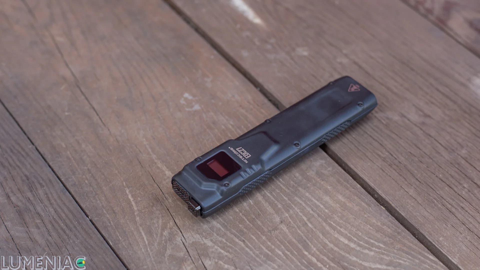

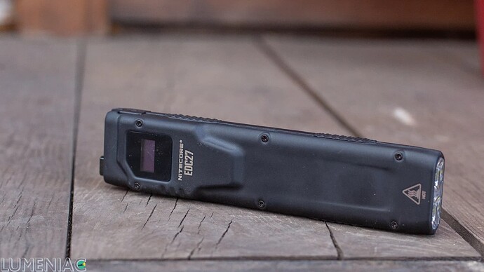

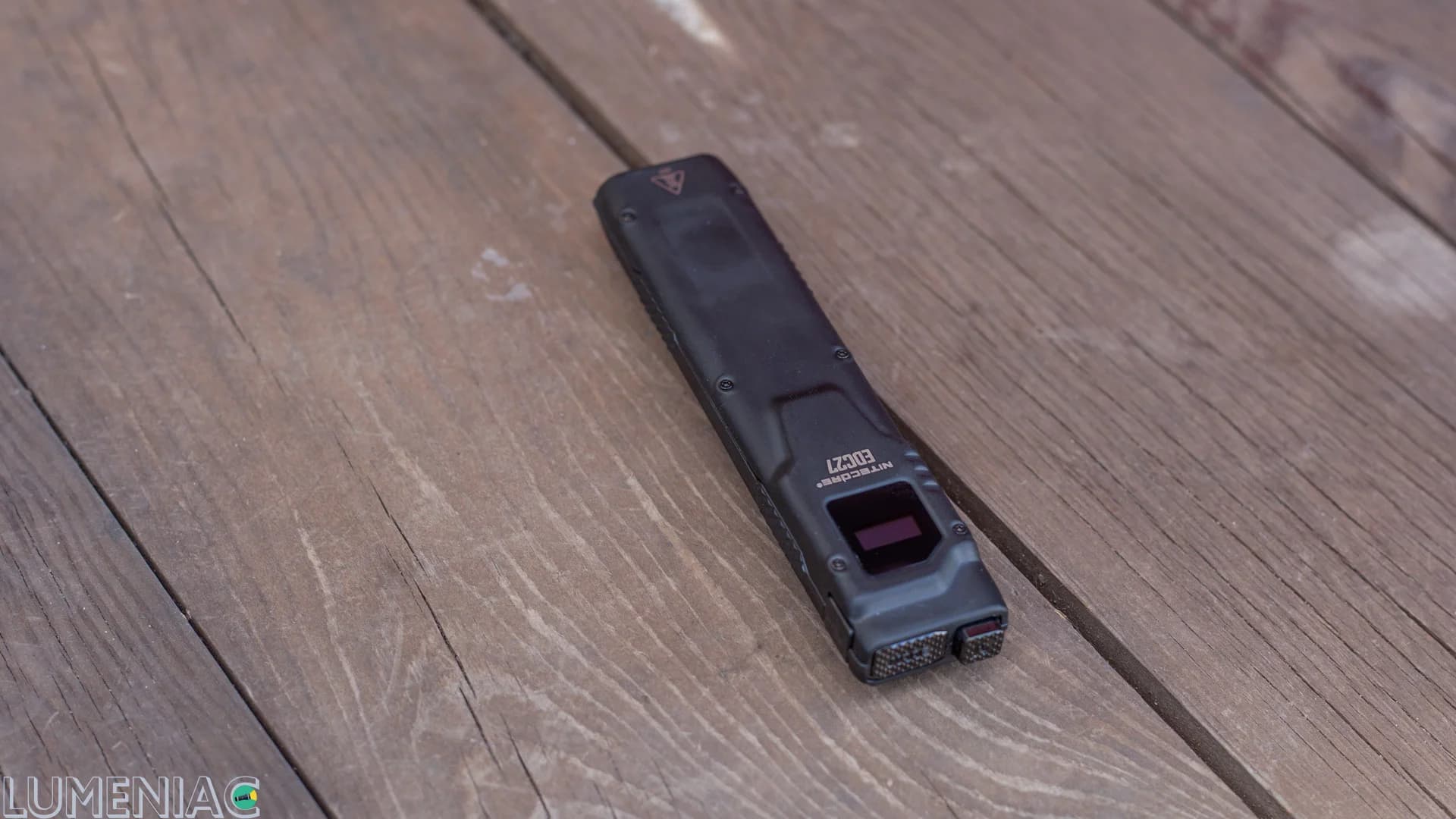

As a result, flashlight got a very pleasant and unusual look. A sort of limousine, stretched out of the usual runabout compact keylight. Rough anodizing, both good for an eye and in the hand. The body itself is swift and graceful. In short, I definitely like the result of design work.
Well, see for yourself, the part with the display neatly sticks out like a car cabin.

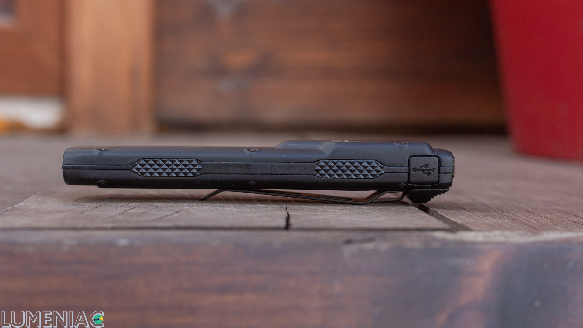

The flashlight actually sits comfortably in the hand. It is lightweight and has a secure grip. Easy access to both tail buttons.
Actually, the buttons, which are actually convenient and, coupled with the good interface used, provide quite flexible UI. It’s easy to screw up here, but Nitecore did it right. It is clear that I would have prefer Anduril 2 or a simplified version of Sofirn, but I would not hesitate to use this UI either, it is really good.
You can thread the lanyard through the clip. It can be removed, for which you will need to work a little with a screwdriver.

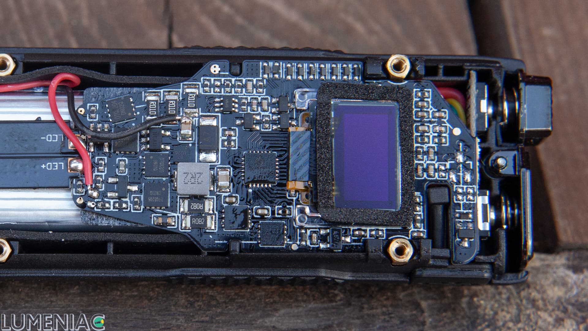

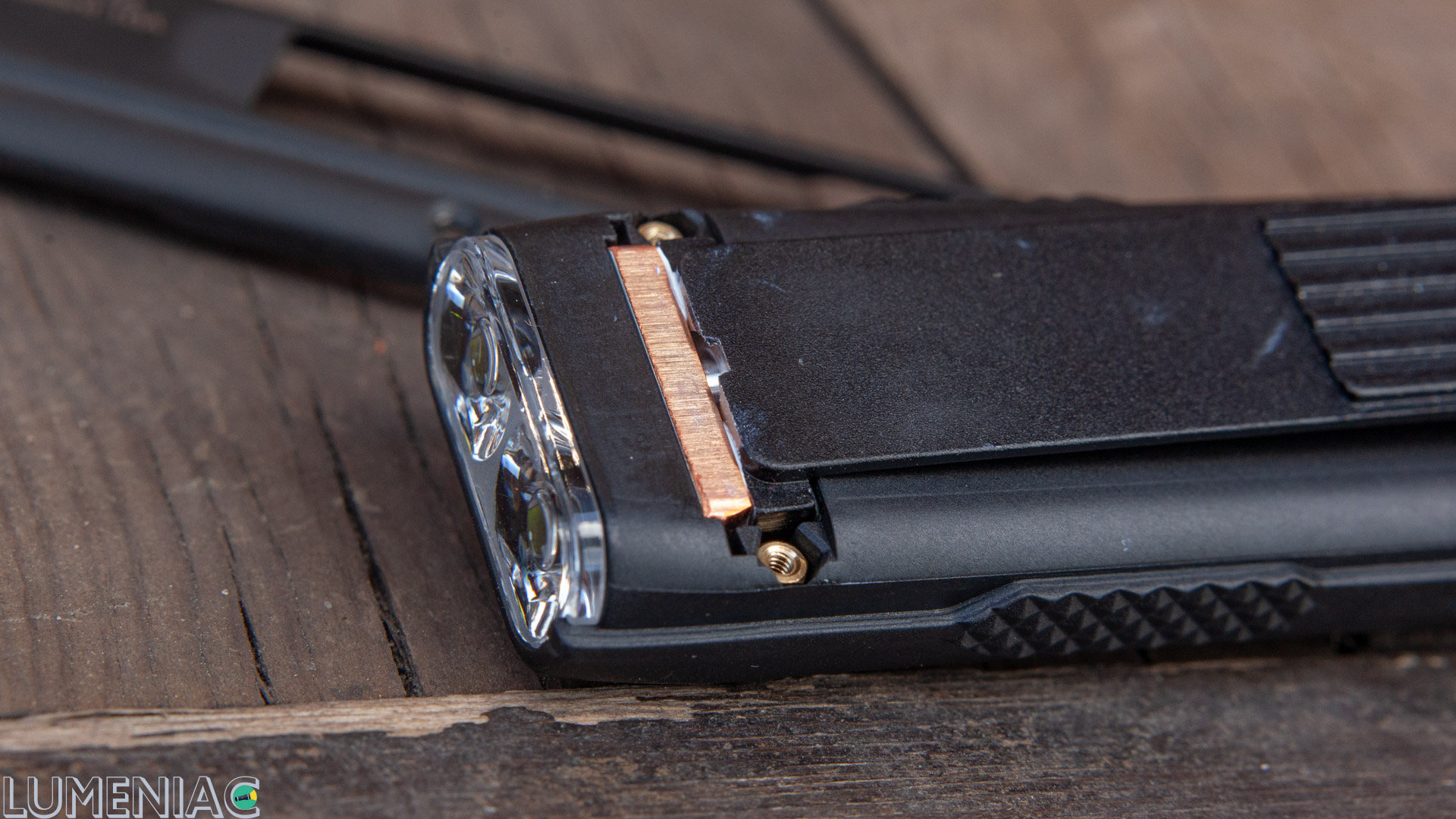

Well, if I mentioned a screwdriver, then with its help you can easily look at the rich inner world of a flashlight. It would be interesting to see everything from above, it is there that all the electronic stuffing is hidden.

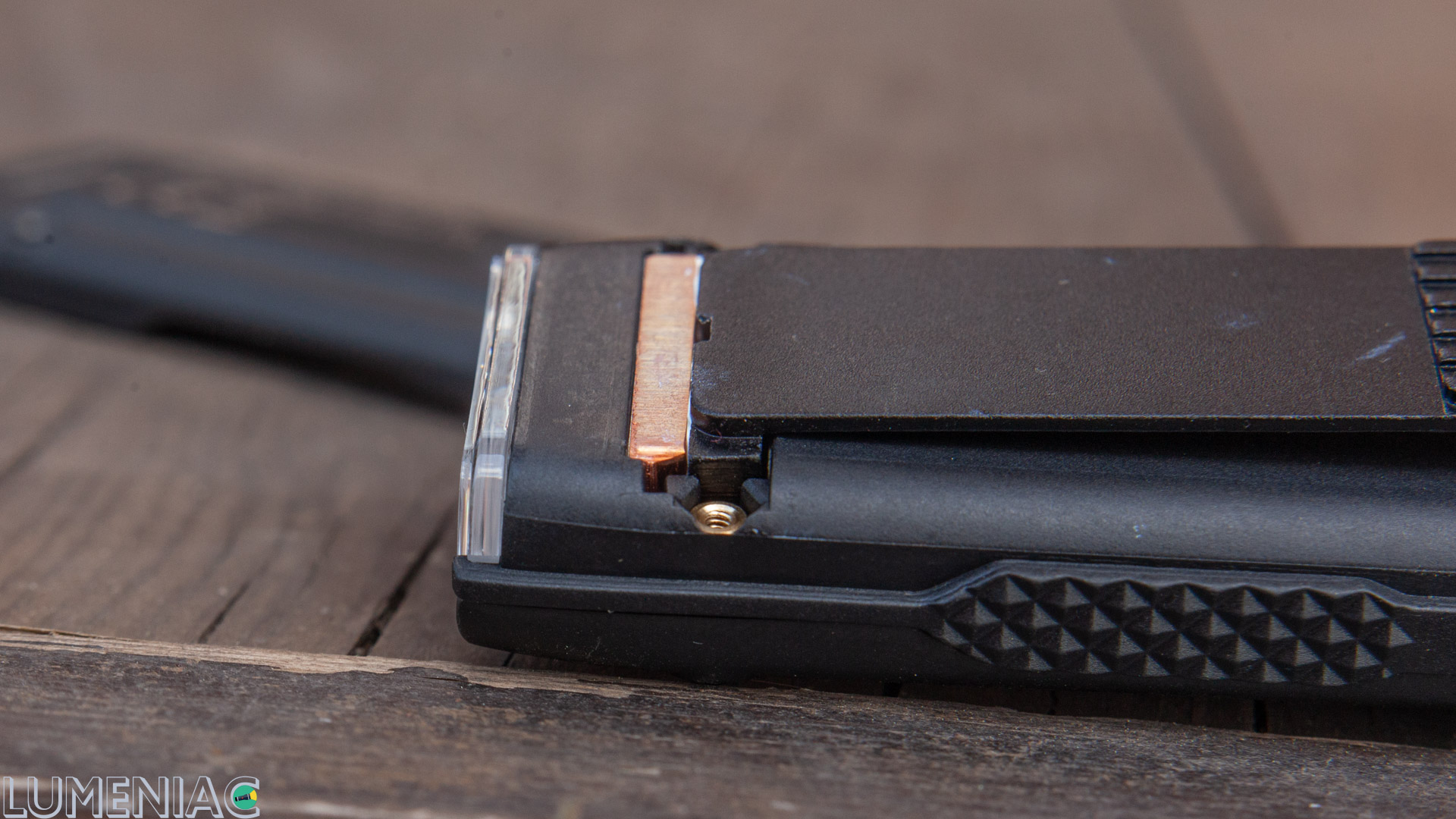

But … look carefully. The arrow points at the place where some plate adjoins copper MCPB under LEDs
And now we turn the flashlight back and open it. Look, this plate is a continuation of a longer L-shaped plate, which is used for heat transfer. Making a good heat sink in such compact flashlights with built-in battery is not an easy task. Manufacturers screwed up with this in lot of full-size models.

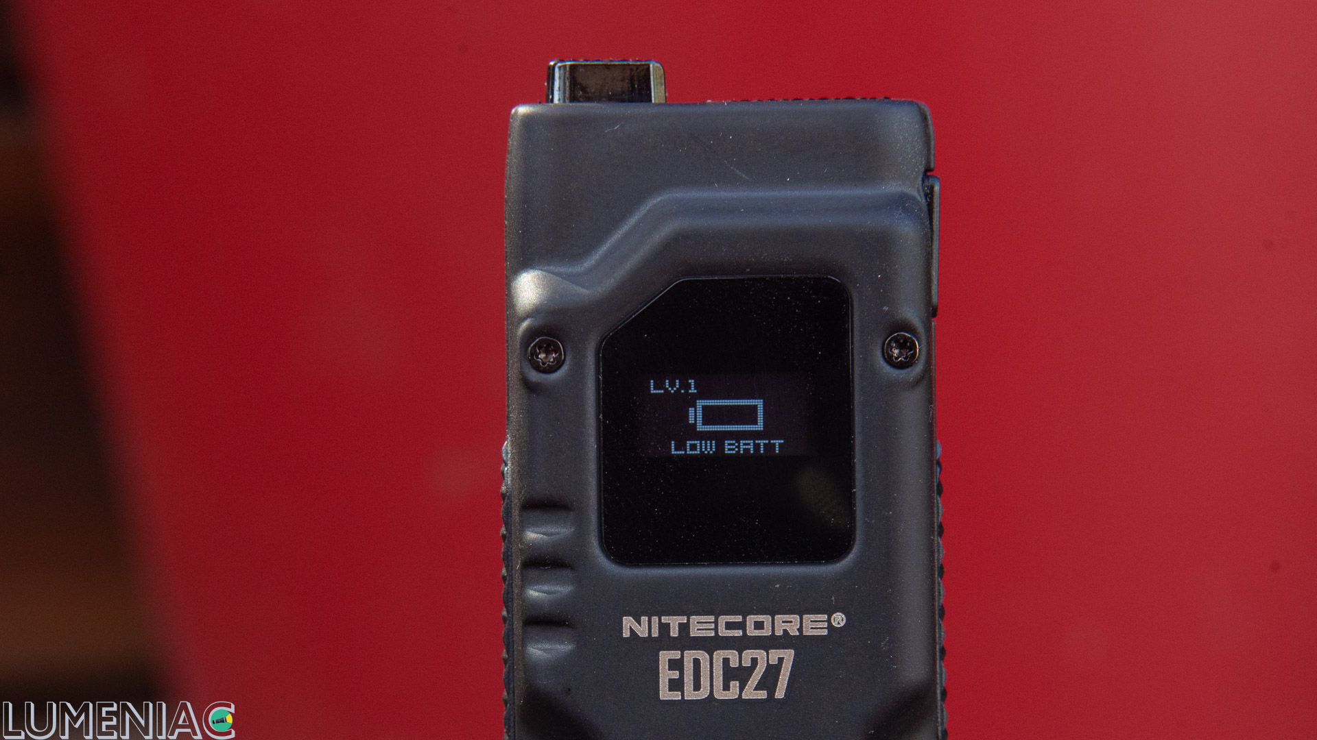

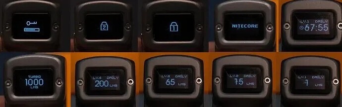

And display is no innovation at all, everything is the same as in other keylights by Nitecore. Brightness level, remaining time, voltage - it shows everything you need to know.

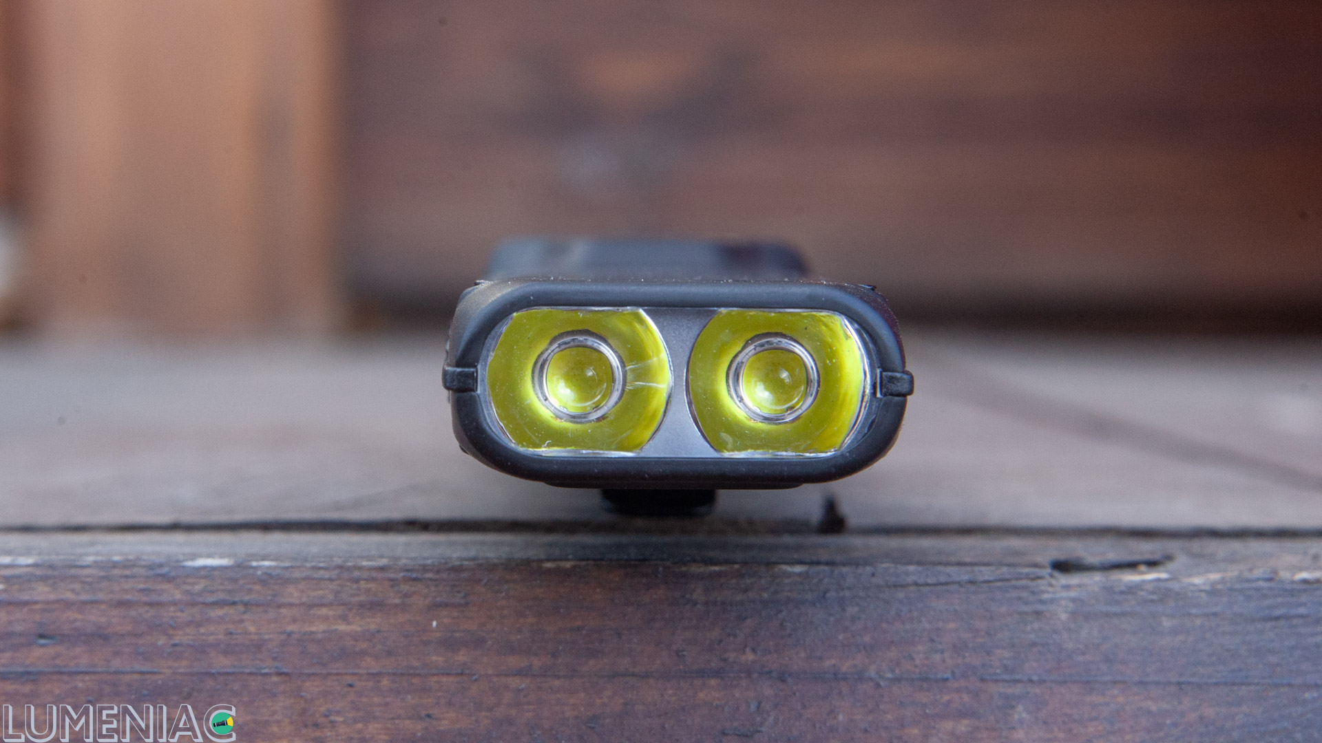

A TIR lens is used as optics, a pair of SST40 LEDs is behind.
By the way, it’s not visible here - but the inflammation sensor is also hidden there, which automatically drops brightness to 65 lumes from High, Turbo or strobe if some kind of obstable is ahead. Quite a reasonable move, in my opinion.

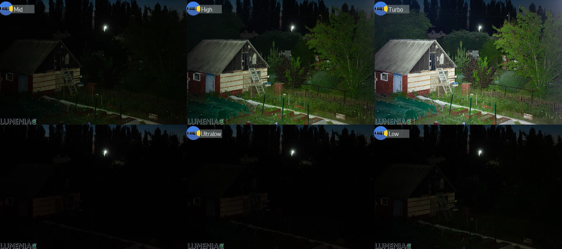

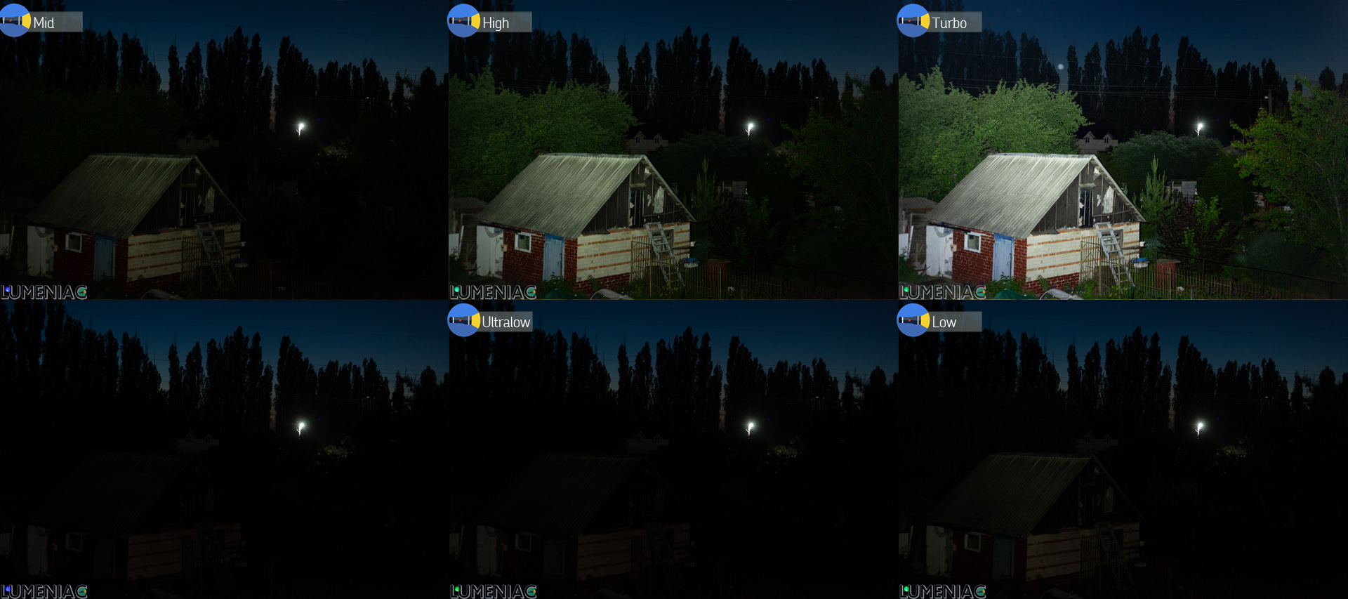

How Nitecore EDC27 illuminates
It is clear that you shouldnt expect hiCRI here, for me this is not crucial
I will attribute the difference in temperature measuring to the imperfection of Opple (although this was not the case with other flashlights). I checked with the manufacturer, Nitecore says.
Light has expected green tint. Not serious thoug. This shade will not be visible at all during summer walkaround with all the green grass and trees around.

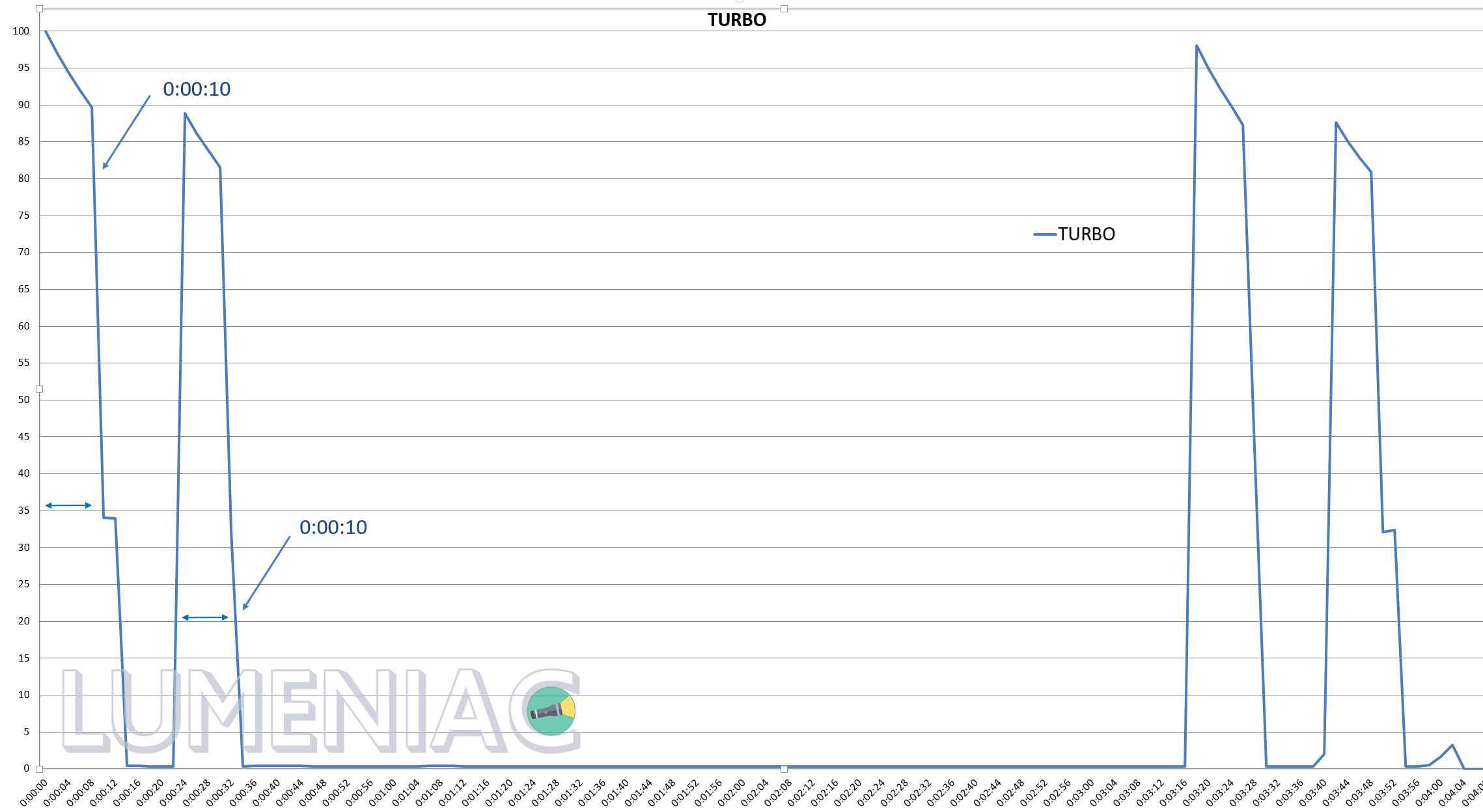

The dimensions of the flashlight are very compact, so the turbo runtime here matches them. 3000 lums last 10 seconds and cooling here can only affect in winter in Siberia. However, 10 seconds should be enough to quickly look around. Be that as it may, in this mode there is more marketing than any real benefit.

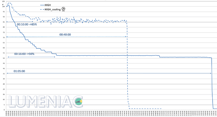

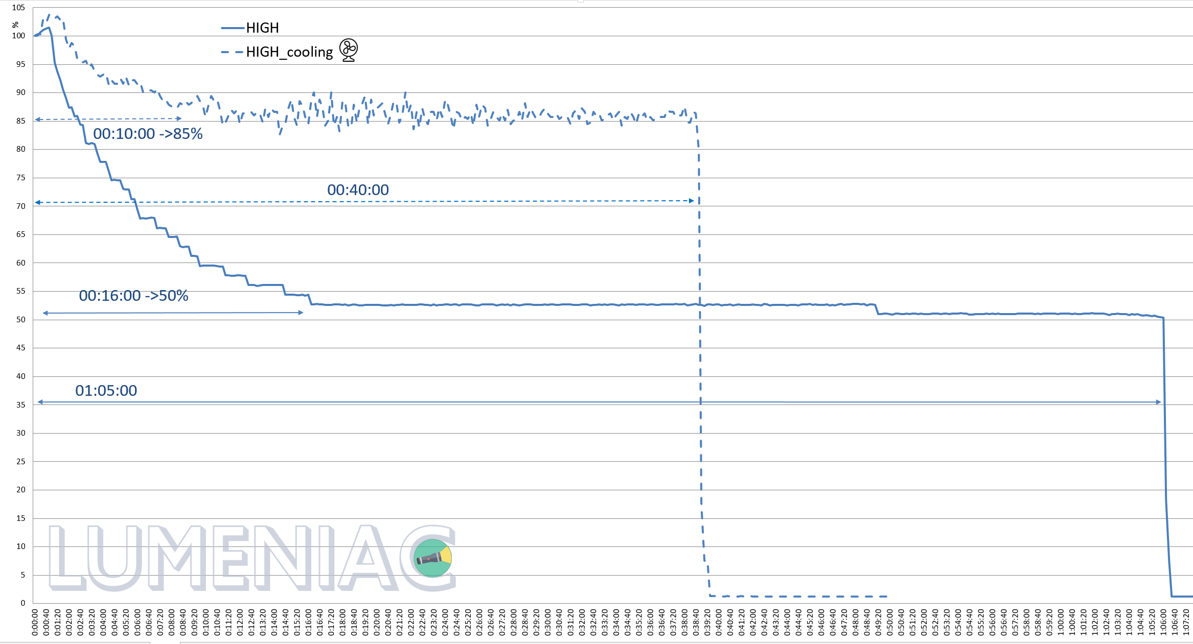

But the 1000 lum High mode impressed me. I did not expect the size of the flashlight to allow it to maintain this brightness even with cooling. But the same plate on the back of the flashlight worked out perfectly and the brightness sank when cooled after 10 minutes only by 15%. Without cooling, it will fall to the conditional 500 lum, which is also just great.
The most popular, in my opinion, mode - MID will last 4.5 hours and this is enough for the eyes for any evening walk.

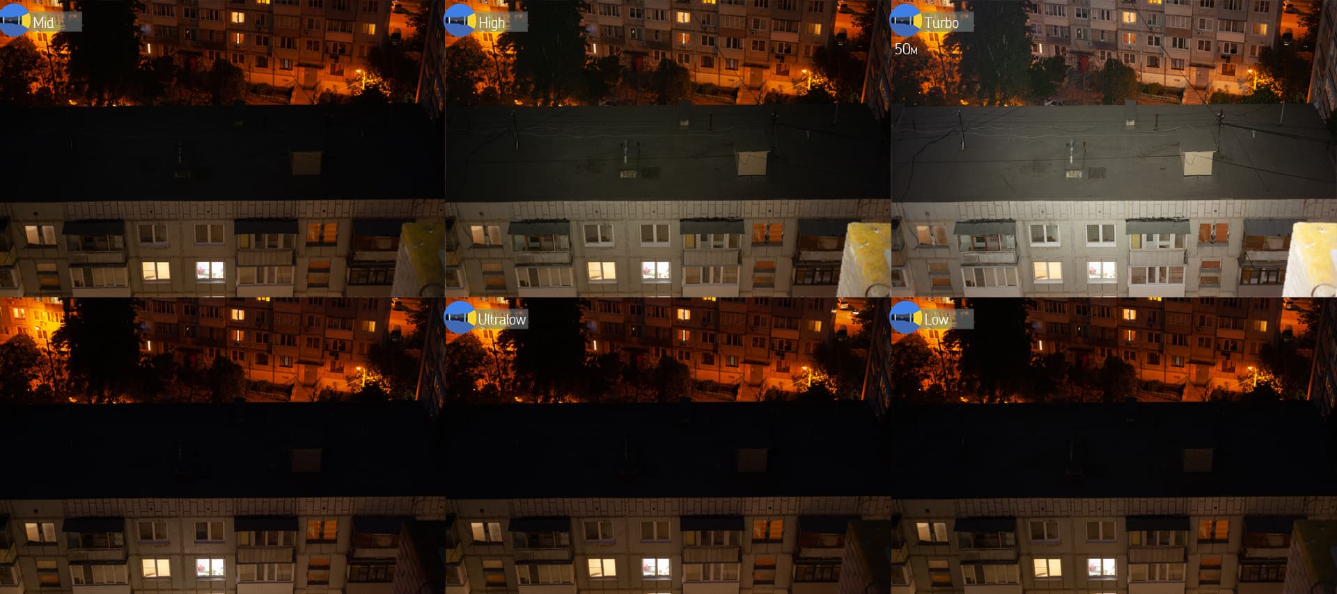

In terms of light, Nitecore EDC27 is pure EDC light with an emphasis on close up lighting. Due to the high turbo brightness, you can briefly illuminate something at an average distance or simply surprise others with a bright light that is unexpected for such a compact flashlight.
Ultralow-low-mid are good for indoor use. Perhaps Mid is even excessive on the scale of the room, but it is an excellent walking light. High is suitable for some fast movement or if you want to see a little further then 15-20m.

Turbo, I repeat, due to its short runtime, seems to me more like a marketing mode than something actually useful, comparing to normal turbo runtime that most of us are got used to.
Nevertheless, it`s 10 seconds are enough to see everything you need in most cases. So it’s better to have a short turbo than not to have a long lasting one. And, anyway, when you turn it on…wow…it is really bright!
