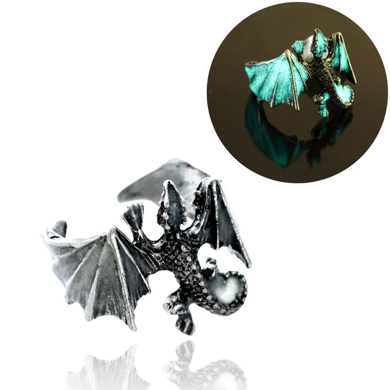

I ordered up these dragon rings but just now (while looking for a pic) found I could’ve ordered them without the glow

The “glow” coating on the rings was inconsistent from ring to ring and they kinda looked like they were covered in mucus. So i cleaned off the coating, i assume it was some kind of epoxy. The middle ring in this next pic is cleaned, the other two are not.
To hold the rings in place i dabbed spots of solder paste on the tube, slid the ring into place, repeat one by one, then used a q-tip to try and clean up any excess, finally i used a small blow torch to heat the tube from the inside and bonded the rings to the tube.
