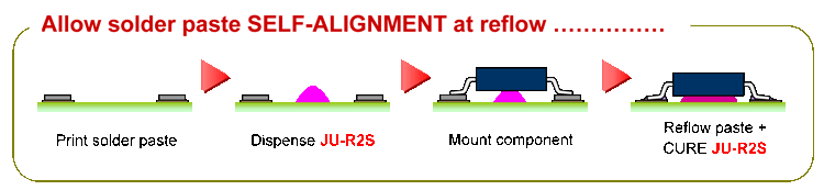

If the LED and driver is on one board the board gets a solder paste mask, then the parts get with some sticky glue placed in position
Or both glue and solder is applied with a printer
Then the LED gets in place, whole board gets into reflow oven
Now that is cool! Does the glue hold during the reflow? I have problems when the parts wiggle and suck down to the board, they sometimes shift.
