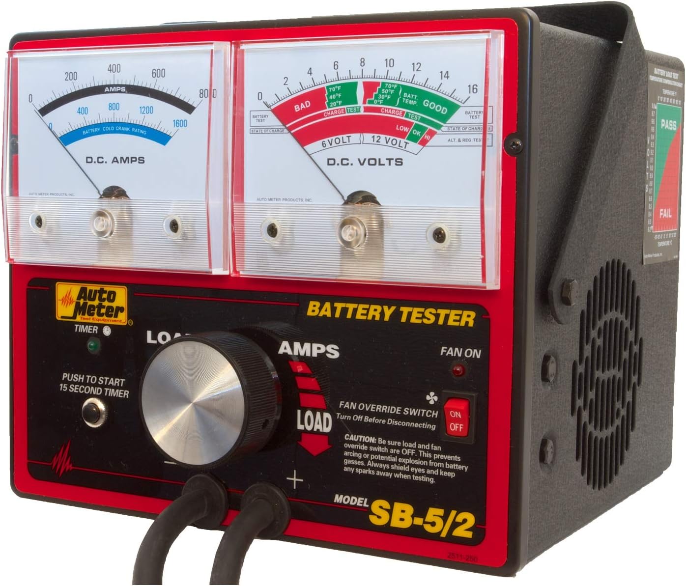

For anything solidly in the car battery department or larger, I will only fully trust this style of tester . Source: One of the biggest parts of my job for three years was testing car batteries, both for people wondering if theirs was still good, and for warranty purposes. Nothing but a massive carbon pile resistor that’s actually putting a heavy load on the battery will tell you the full story every time.
I’d say just take it somewhere that tests car batteries for free, but even most of those places use something like the first two testers now.
