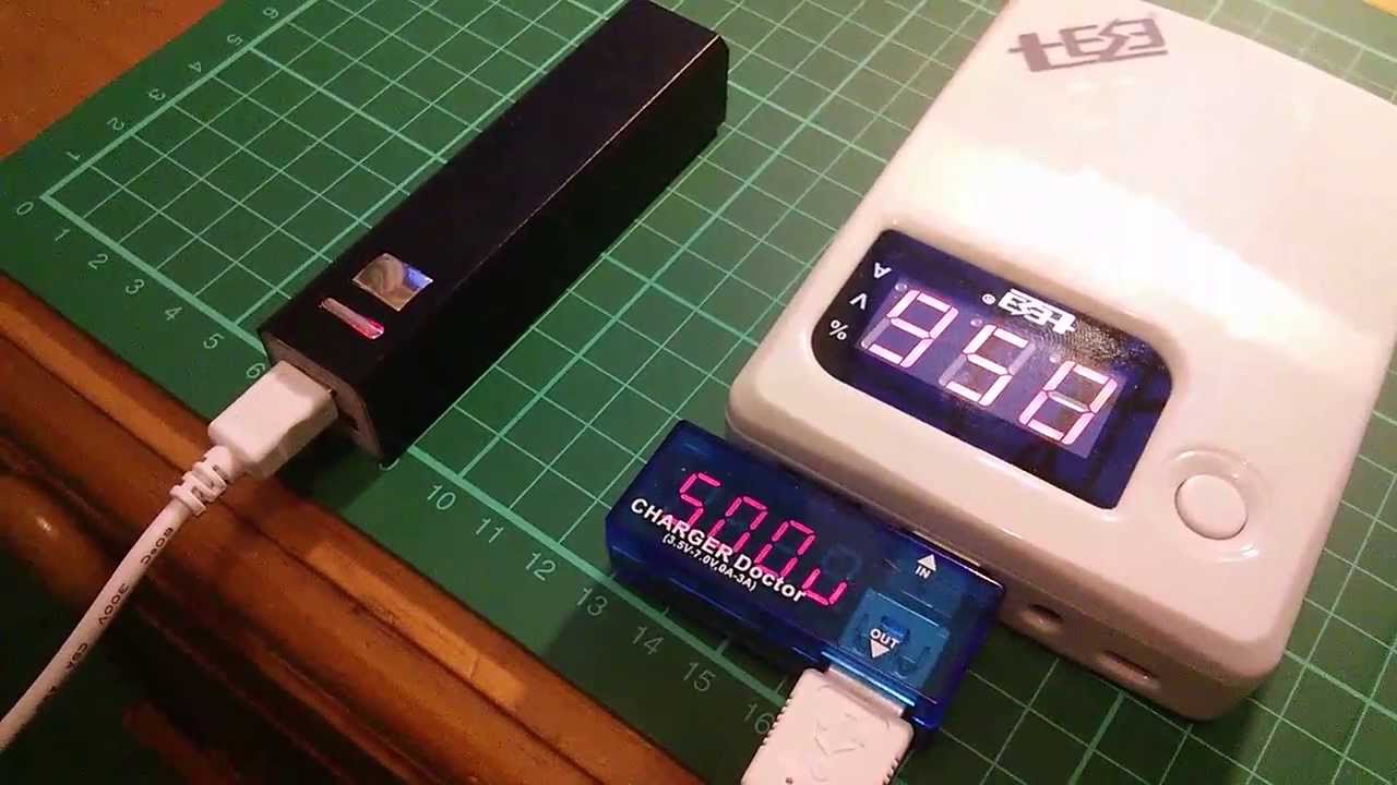

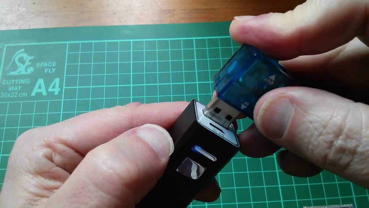

For what it’s worth, I finally finished my review/teardown of the $2.50 1x18650 USB power bank I mentioned.
NICE!
Great review by the way…wonder if HKJ has reviewed, or can review these
Not the best by far…but with your awesome mod might help alleviate some of the odd shutoffs and low power output syndrome…wonder if some of those multiple battery packs would do well with replacing those crappy springs w/ some 22ga emitter wire we use here (or at the very least spring bypass them)
Julian Ilett on youtube did a video review as well
W/ a followup/update
