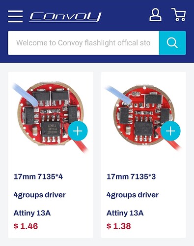

These are the 17mm drivers I was referring to(These Drivers use a ATTiny 13a and can be flashed with different firmware):
Link
Oh, thanks! I know those drivers, of course. Somehow I thought those 7135 drivers wouldn’t be compatible with the available emitters. That’s a constant current driver, right? So I’m guessing it will work with both 3V and 6V emitters?
Those drivers are only compatible with 3v emitters.
You’d need a boost driver for a 6v emitter.
Yeah, it’s confusing when some of the listings list specific emitters, like the SST40 for example.
Any 3v driver will power any 3v emitter, however the current may be too much for certain emitters.
For example you wouldn’t want to power a Nichia 219B with 5A or 6A, it would burn up.
