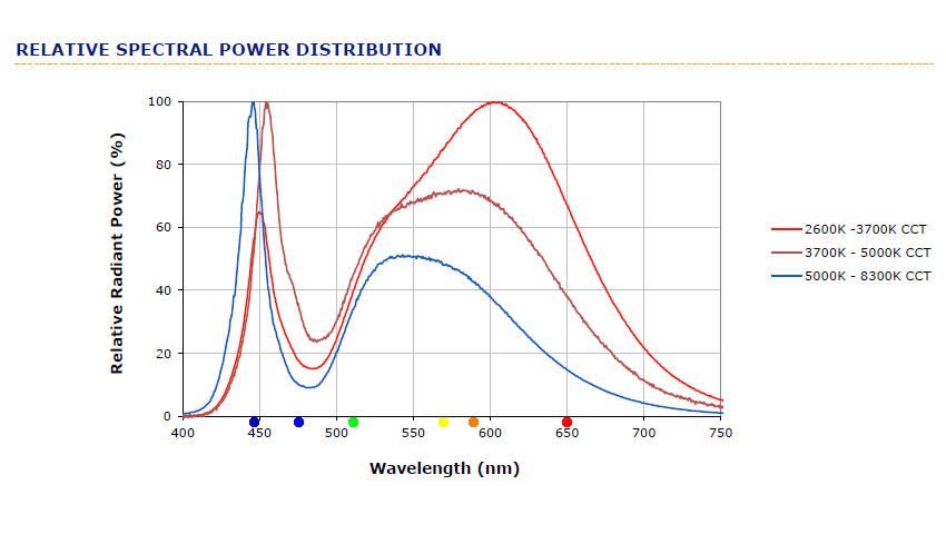

Has anyone compared a T6 4C to a T4 5B1? Is the 5B1 worth the sacrifice in lumens? Based on the color bin chart, they look like they would be quite close in tint, but the CRI difference is harder to visualize.
Some info I found. The T4 5B1 is an exception:
[Quote=CREE]Typical CRI for Cool White (5000 K – 8300 K CCT) is 65.
5000 K - 8300 K:
T5
T6
U2
Typical CRI for Neutral White (3700 K – 5000 K CCT) is 75.
3700 K - 5000 K:
T4
T5
Typical CRI for Warm White (2600 K – 3700 K CCT) is 80.
2600 K - 3700 K:
T2
T3
“In the human eye there are more than 6 million receptors called cones, which sense the color of the light reaching the eye. Based on the sensitivity range of their photopigments three different kinds of cones can be identified. Their names are Protos or L cone, (sensitive to the red colors: Long wavelengths) Deuteros or M cone (sensitive to the green colors: Medium wavelengths) and Tritos or S cone (sensitive to the blue colors: Short wavelengths). The figure below shows the sensitivity functions of these receptors.”
[/Quote]
