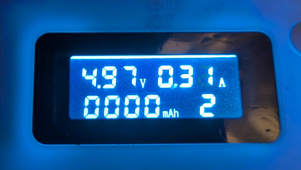

You will see in the pic below that the Ecoflow supports the Apple 5 volt 2.4 amp protocol. (12 watts max). It also supports the BC 1.2 spec which today is pretty much the baselline spec for charging.
Meter plugged into the 100watt port of my Ecoflow River 3 Plus 100watt port.
