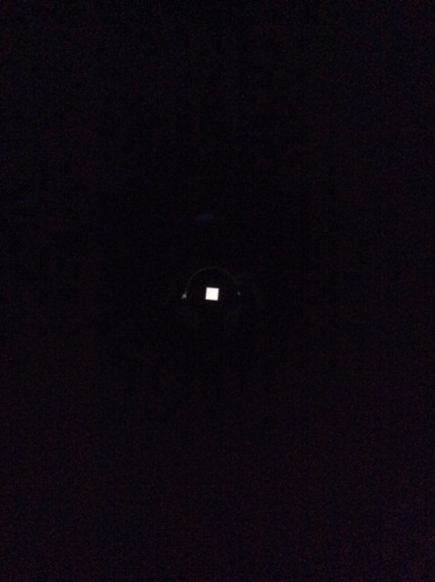

I recently purchased a X9L and quickly noticed the emitter being constantly on in an ultra low mode. Lower than you can select. It will only turn off when disconnected from the battery. I own 3 other models in the FW series and none of them do this. Is this normal for this model or should I send it back. Thanks.

This is with some ambient light.
No ambient light.
Looks like the switch is not doing its job cutting off the power.
It does it in both. I was finally able to post some pics.
100$ light… 5$ driver ;)) Its an electronic switch. Parasitic leak…. Maybe one of 7135 defected… maybe some dirt makes wrong contact… who knows… Write to support.
