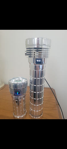

The X75 has better heat management with higher outputs sustained. When turbo steps down on that light, it maintains 17 to 20,000 lumens for several minutes.
I forget what the weight of the light is but it’s got to be 3 lb or more. But if you hold it near the top, which is the way to hold it when you want to switch modes, it’s not that bad.

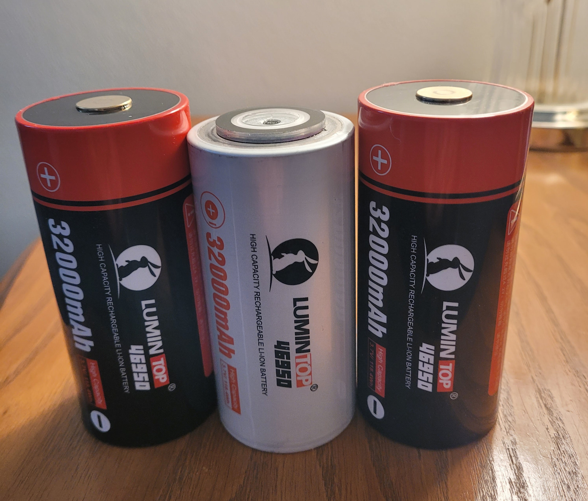

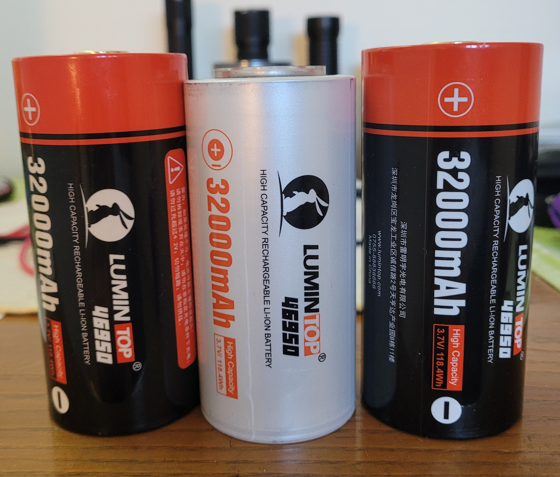

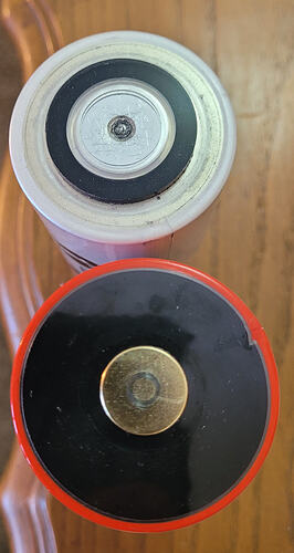

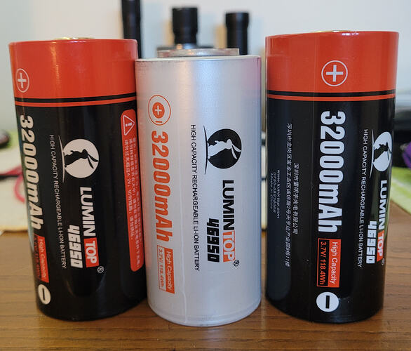

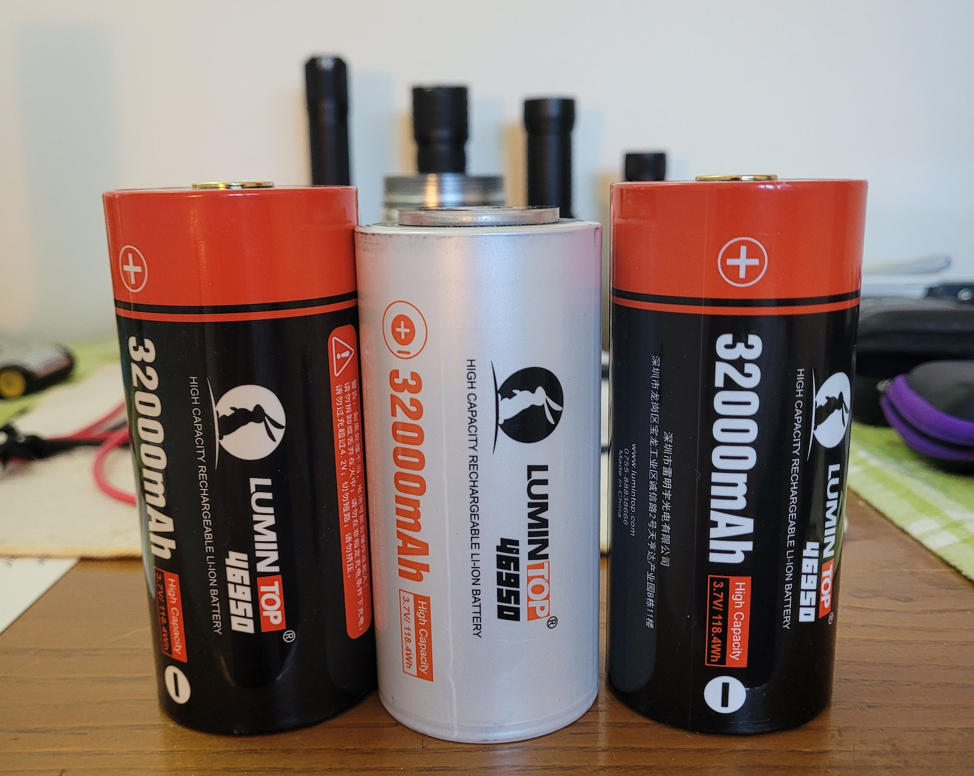

The batteries for this light compared to the Mach silver are different. As you’ll see in the pictures. They’re 5 mm taller and a little less than a millimeter wider. Not only that the batteries for this V 3.0 have a positive end on top and negative end on the bottom. The smaller Silver Mach has negative and positive on the top. In fact every 46950 Battery I’ve seen is like that except for this the V 3.0

Awesome. So far, nobody’s tested the Mach 3, which is a very unique light. However highly doubtful you get 50k Lumens out of it. Maybe closer to 30K, maybe 40K at turn on (corrected Lumens). I get about 85% of the 26K advertised for the 46950 Mach and 3x21700 Mach and neither have regulated drivers. I don’t think the Mach 3 does either. Still a good amount. For the extra like $50, the X75 is a far superior flashlight and in no way would I buy the Mach 3 unless it was offered for 50% off. Even the Imalent MR90 is a better deal.
As far as those batteries, they’re longer because they are in series and have protection boards so they are arranged electrically like regular batteries. I think the cell balancing is handled by the batteries themselves and the driver, which works, but isn’t ideal. Plus, you’d have to replace them i pairs if one ever went bad.

The two batteries are connected in series. That’s why their bottoms are exposed. This ensures that when they touch each other, the positive terminal of one is in contact with the negative terminal of the other. Regarding their length, they appear to be 46950 batteries with a protection circuit, unlike the other Lumintop 46950 models which lack this circuitry
Yes. Basically the same as a button top 18650, 21700 Etc with protection.
They are approximately 5 mm longer just under a millimeter wider. Out of curiosity, I tried putting one of them in my silver Mach and it wouldn’t fit. And when I put the silver Mach battery in the v3.0 it was too loose and rattled around. That’s just for fitment purposes you can never use the Silver Mach 49650 in the V3.0 because of the difference in polarity and how the cells are constructed.
