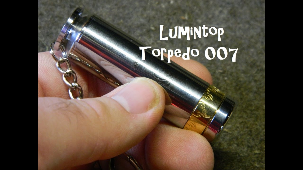

Construction:
Sorry for not removing my fingerprints. I didn’t think they would be so obvious in the pictures. As usual with Lumintop the light is built very well. It has really nice smooth threads, flawless stainless steel body, and a double AR glass lens. It comes with 2 extra o-rings and a keychain. There is also a tritium insert in the tailcap. I was unable to get a successful picture of it. It is very hard to see unless you are in a really dark room. In complete darkness you can easily see the tritium from 8-10 feet away. I was unable to get the bezel off, and didn’t want to use tools and scratch the finish before I was able to take pictures. The inside of the tube was clean and the light operates as expected. The tail switch does extend the slightest bit beyond the tail. The light is still able to tailstand, but it is wobbly. Not a big fan of that.

Conclusion:
This light is built very well. It’s a big heavy block of stainless steel with a copper insert for better heat dissipation. The runtimes were impressive and it is definitely competitive with lights like the Olight S1. The light also looks terrific. The stainless steel is flawless, and the “gold” fire insert also looks great. This flashlight complements a Parker Jotter pen perfectly. The beam is very pleasant to look at and I’m not seeing any sign of PWM at the lower modes (I’m not very sensitive to it however). The light suffers from 2 flaws. First is that it’s not easy to EDC this light. I feel like it’s too heavy for a keychain, but it really doesn’t have any means to comfortably pocket carry the light. I did put this in the 5th pocket of my jeans a few days, but it could be quite difficult removing it when your hands are even the slightest bit damp. It’s also too heavy to carry in a front shirt pocket, or even to wear as a zipper pull My second complaint is the user interface. I really really really want this light to have a reverse clicky.
So is this light a home run? Not in my opinion. It’s built well, it performs great, and it looks great. The two issues I have with the light may not be an issue for you at all, so don’t think of this as a deal breaker. This light will probably end up in my desk at work for EDC use there. It looks great, which is always a plus for any office EDC equipment, and it will be safe and not get dented, scratched or ruined there. Currently I have a thorfire TG06 in my desk with a energizer lithium battery. I think that Thorfire would make a better light to keep in the EDC rotation, and the Torpedo would make a better show piece at my desk. And let’s be honest, office EDC can get pretty competitive amongst guys, and I think this light will definitely turn some heads. And lets not forget that tritium insert will be nice if there ever is a power failure. Those interior office spaces with no windows get crazy dark without power, and that tritium is very noticeable in an entirely dark room.
This is definitely a light for a person who appreciates form over function. This is a show piece, but also performs as good as it looks. This is not a light to bring into your construction job, or to gut a deer, or even something to take backpacking. I hate to steal another person’s analogy, but there is another reviewer out there who compares flashlights to cars. And this flashlight is a foreign sports car. It looks great, it’s fast and sexy, but it’s not a car your going to bring to a old muddy dirt road with lots of potholes.
So the million dollar question… would I buy this light. I have to say no. Not because there is anything wrong with the light, in fact the performance is fantastic, but because I’m a hard use guy. It’s tough for me to accept that flashlights can be sexy and look good. I’m a guy who puts function way before form, and for me I strongly prefer a tough as nails Jeep Wrangler steel of flashlight. Lumintop does make great lights in that category. The Worm and Tool are both great lights and I carry them very frequently. But I do have to say… put a pocket clip on this light and a reverse clicky and I would buy this light in a heartbeat!
