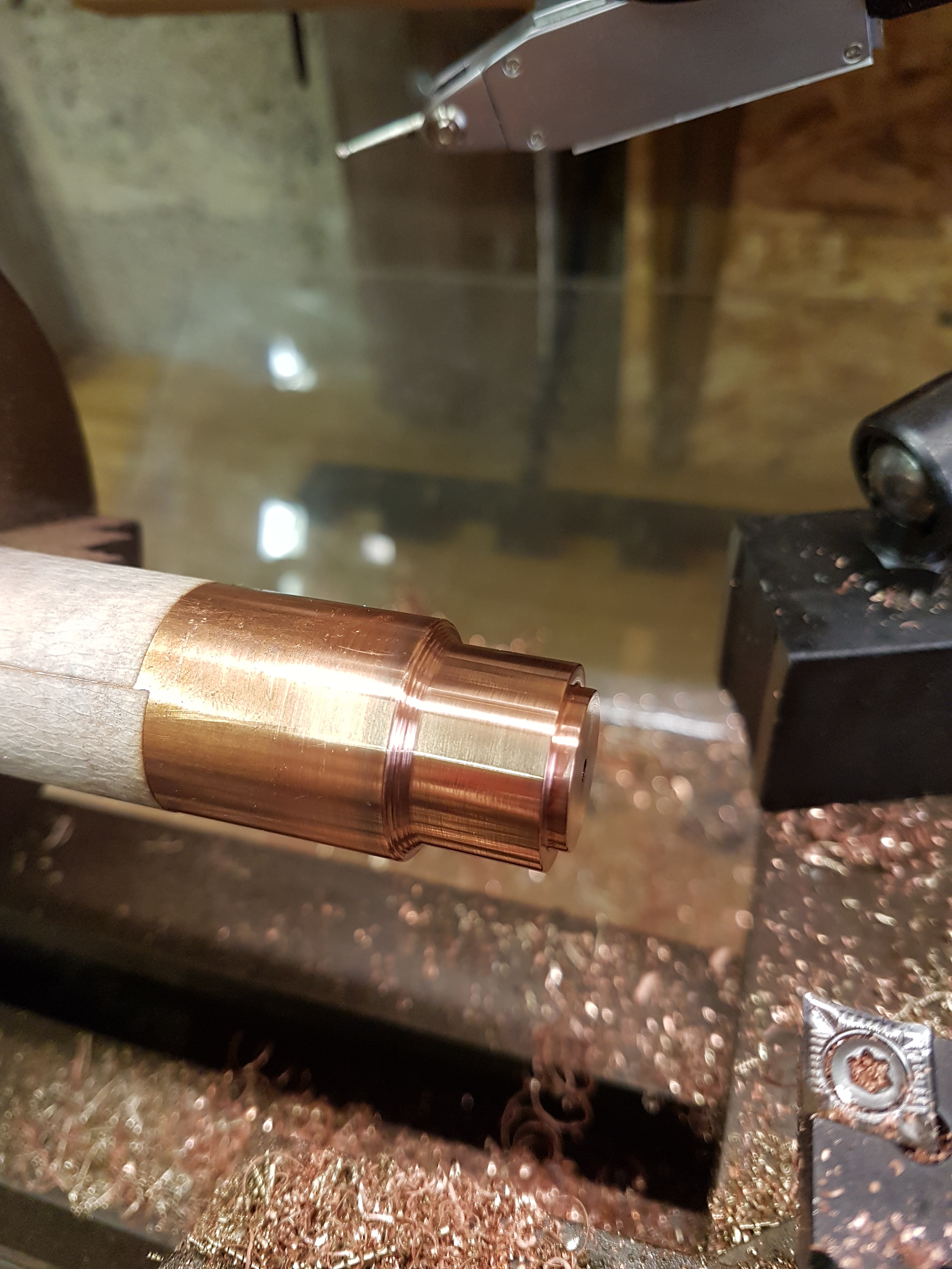

You may also want a copper ‘slug’ or pill to put in there, maybe kiribaru is the place to go for that - or there is a guy in the USA, but I can’t remember his name sadly. User ‘Hoop’ maybe?
Here’s a pill I made to fit - you will perhaps need something similar -

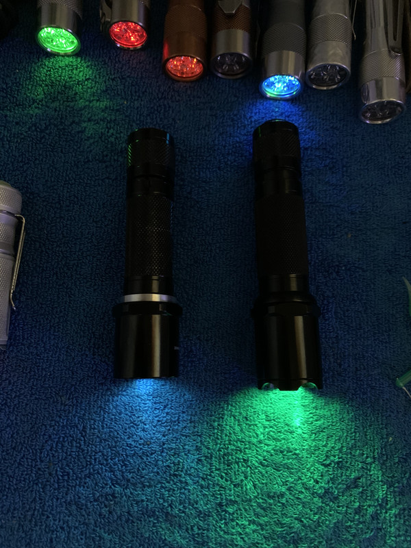

Here is the one using Lexel’s Triple Aux board… the driver wouldn’t light the board up in the Low mode only the High mode… Surefire 6P Defender…
The other 2 Surefire 6P’s using the Mtn. Triple board…
