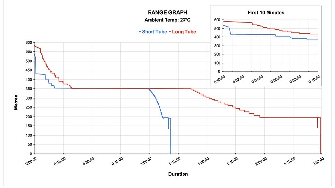

I would have liked more fins covering the entire neck too, makes it look a bit odd as is. This thing holds turbo before its sustained level for 20 minutes. Name one similar model from any brand that does that, I couldn’t find any. More mass is benefiting for cooler temps which didn’t exceed 57°C. Misunderstood your comment.

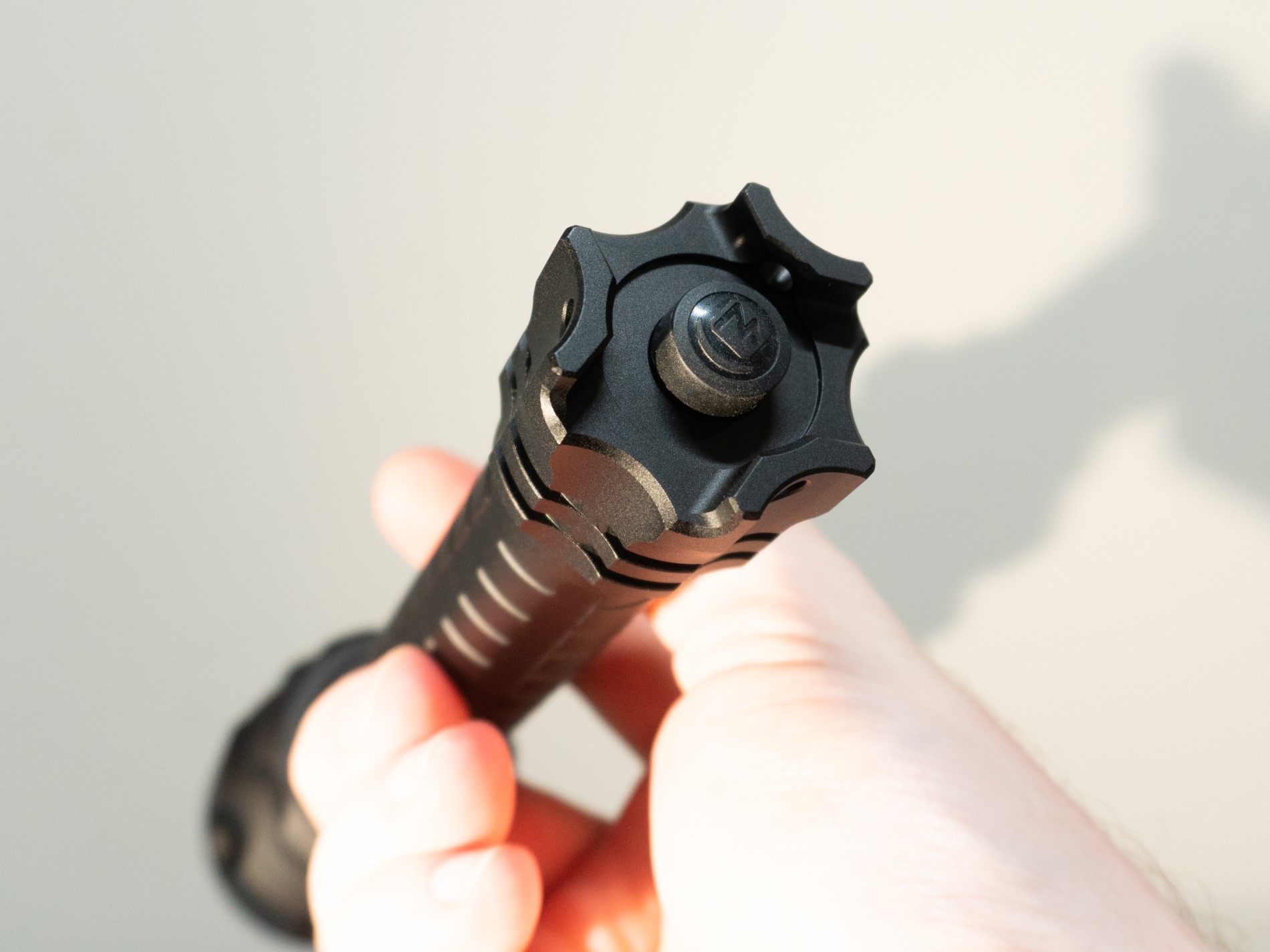

The button looks too small to me. Especially with this intended for SAR, a larger and even more prominent button would be superior especially if the user is wearing gloves of some sort. In such a situation while wearing gloves, you would want more surface area and tactility for activation. And even without gloves, a larger button still makes activation easier. That seems a glaring error in a light built for SAR.

That would require a side switch. I did suggest dual UI’s, but unfortunately they took no notice.
Still, more fins would be better. And for that price, I expect the maximum performance, which means maximum cooling possible at a certain form factor.
