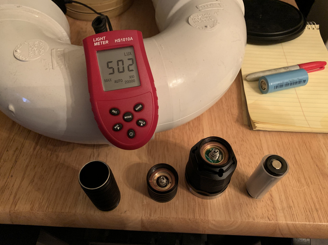

Here is what I measured with the Baby Blue LiitoKala (didn’t measure the voltage at the time) and I haven’t been really following this thread as of late… this is what I got…
1. 37lm
2. 505lm
3. 948lm
4. 1680lm
5. Dbl Tap - Turbo … (while in Turbo) Dbl Tap - Strobe
. It has memory so in lowest level, I double tap - Turbo - off, and repeated this Low- double tap Turbo off quite a few times and it never failed. I cycled thru the 4 modes many times, no hiccups. Got the light screaming hot, and repeated the above thinking maybe heat might make it wonky… never failed?

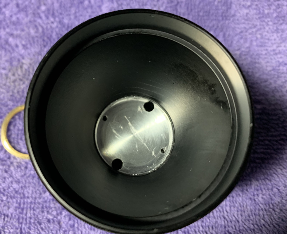

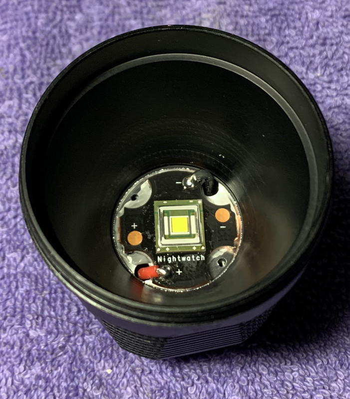

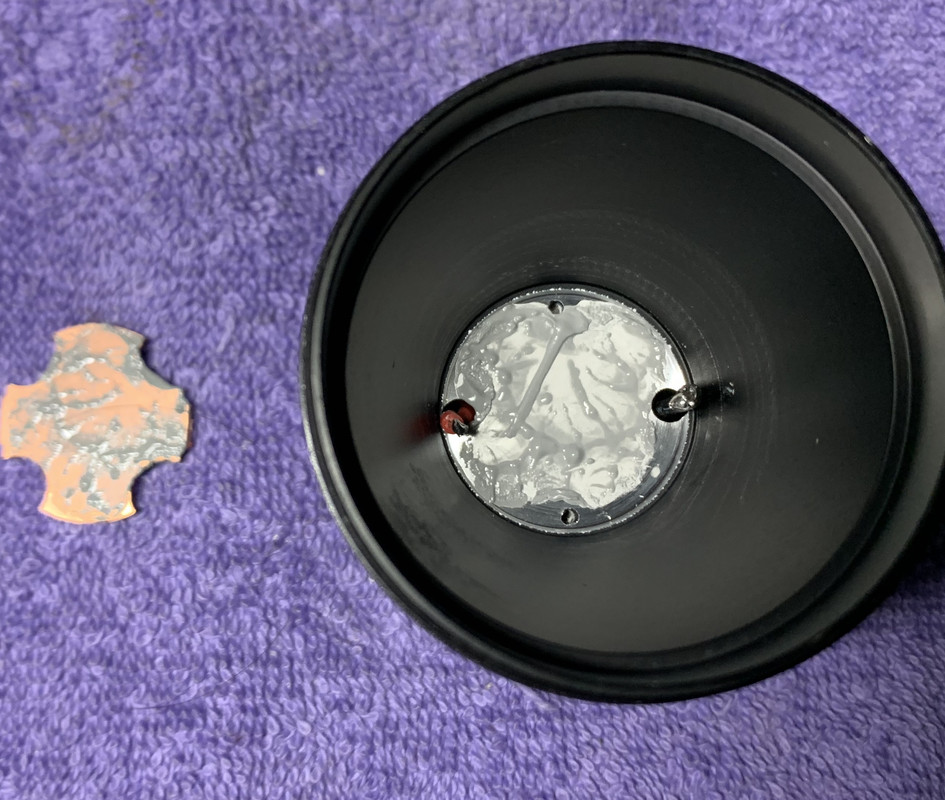

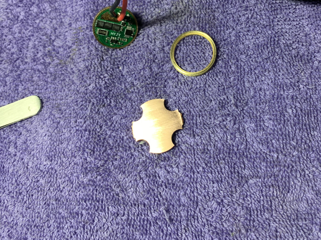

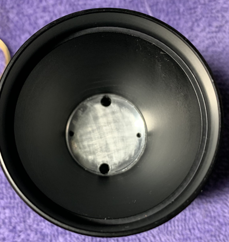

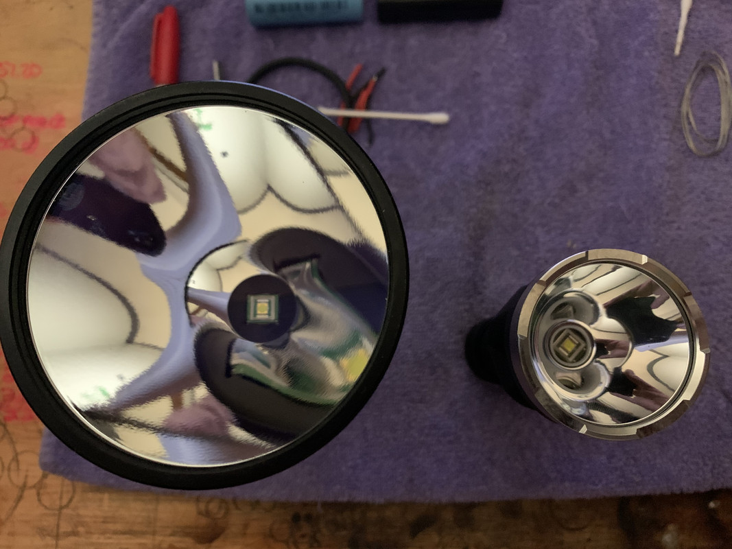

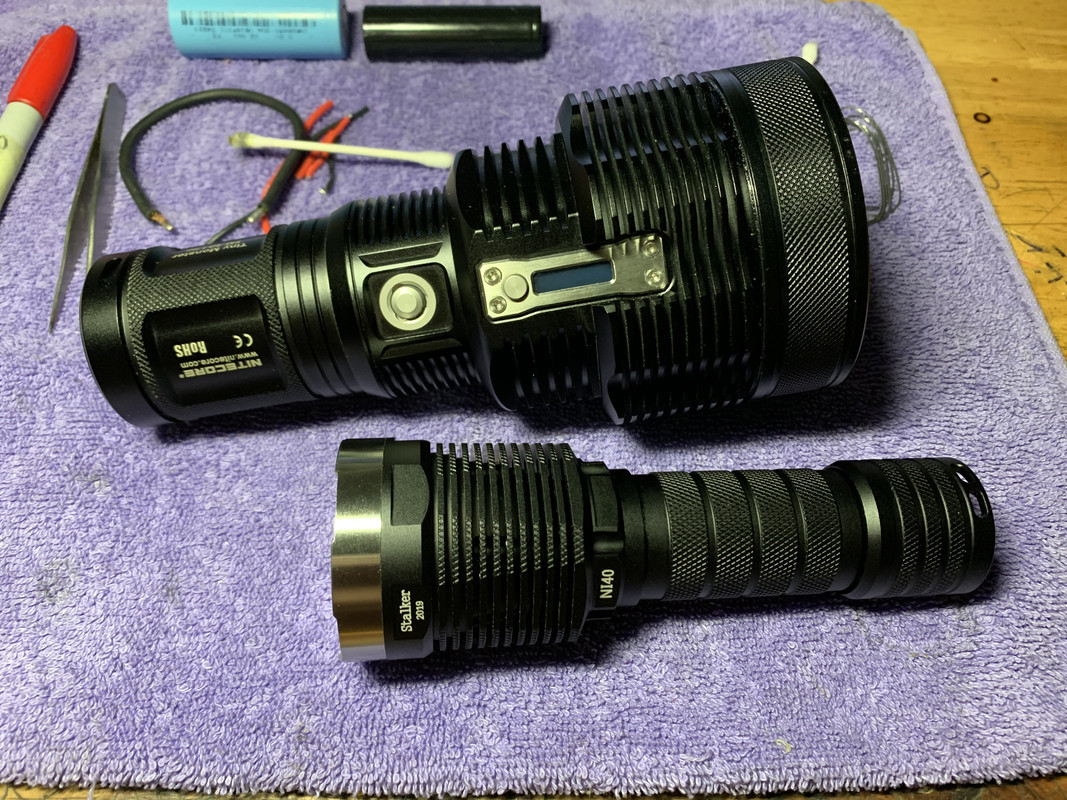

The inside’s…
Checked the shelf and board for flatness….a little stoning…… not too shabby… now what to do with all these pieces….

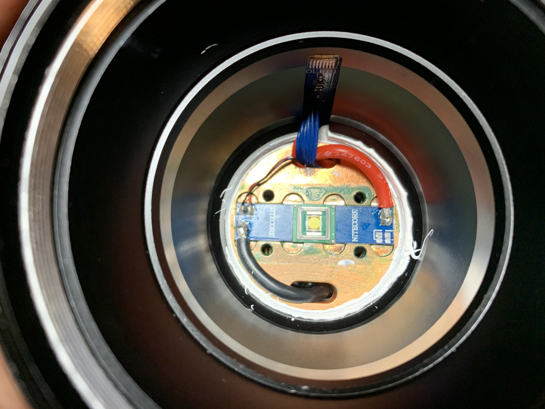

Just fyi, I finished the mod of a SBT90.2 in a 1504 zoomie, using a spare 1504 brass pill, 17 mm SIR800DP based driver, 22 AWG wires (small because of concerns with soldering in tight spaces). "Only" got about 21A max out of it but it does over 500 kcd measured at 5m, and not sure it's fully focused. Got some pics, hope can post soon.
