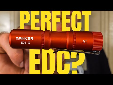

Manker EO52 perfect small EDC
Absolutely love this little EDC from Manker you guys definitely need to check it out and let me know what you think!
title: Manker EOS2
correctly: Manker E05 II
