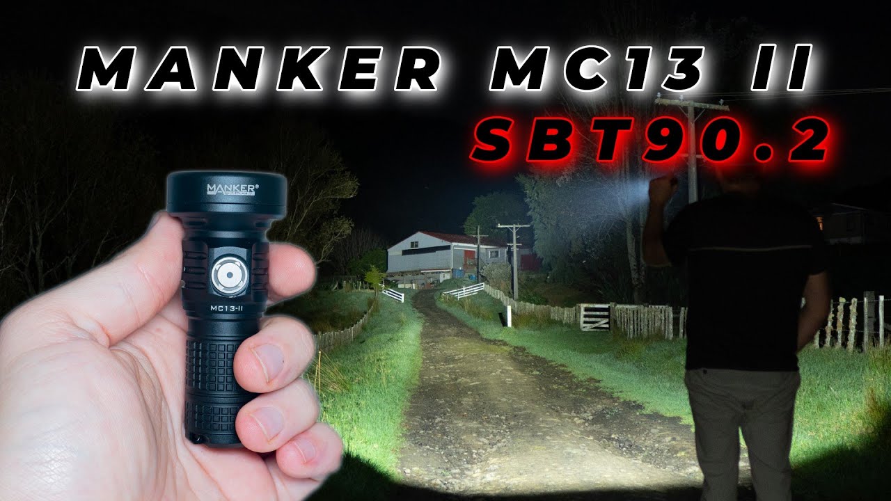

Manker MC13 II SBT90.2, 4,500 Lumens, Mini EDC Pocket Thrower, USB C (2023 New Release)
What a fun wee model. First light from Manker that I’ve played with. Falls short of its lumen claim for both an 18350 and 18650, but still fairly happy with it due to the size. Same sustainable output as the much larger Wurkkos TS30S Pro set at 55°C limit, shows just how bad that Wurkkos driver really is.

Hey Funtastic, thank you for the review. Need your input, I’m looking for a small pocketable 18650 SBT90.2 light with a sideswitch. I’ve narrowed down my choices between the Manker and the Emisar D1. Here’s my question, do you notice if the Manker has a donut hole in the hotspot ? I’ve seen a few comments that the Emisar with the SBT90.2 has one, so the hotspot isn’t as intense, and the beam is ringy outside the spill. When I examine your video, it appears the Manker beam is pretty clean outside the spill. Modder Vihn from Skylumen sells the Emisar D1 and adjusts the height of the LED pill to tune out the rings as much as possible. But it still seems the donut hole remains.
I have a Hank-made D1v2 SBT90 and it has a pretty nice beam, no donut hole that I’ve noticed. Maybe it was on older lights?
Yeah, the MC13 here does have that donut beam and also one ring inside and two outside the beam. Definitely could be improved. I did talk about everything, but I do understand not everyone has the time to listen.
