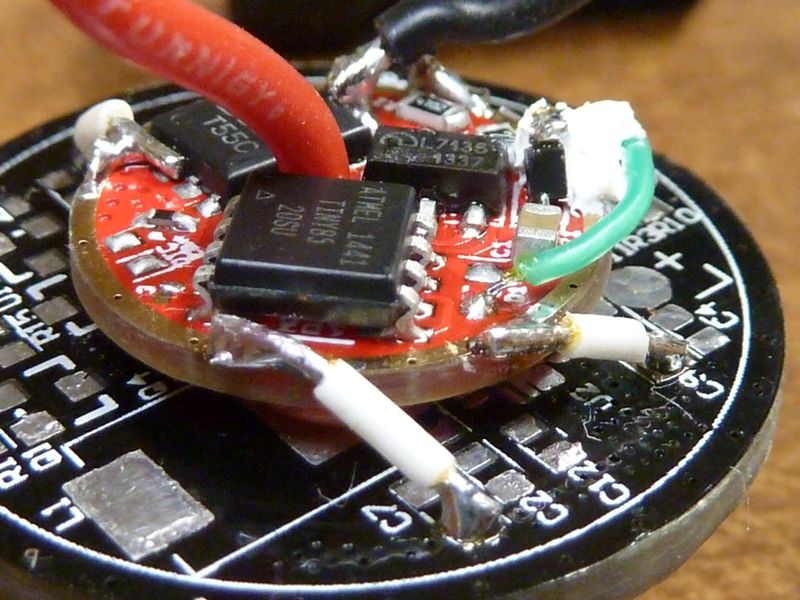

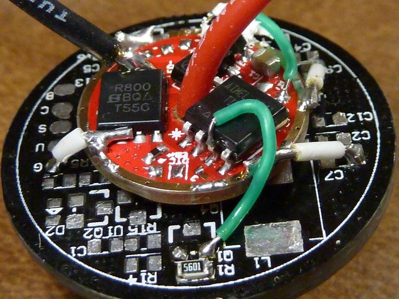

Not sure. I've done couple with full mods to Run NarsilM, FET+1, piggybacked:
