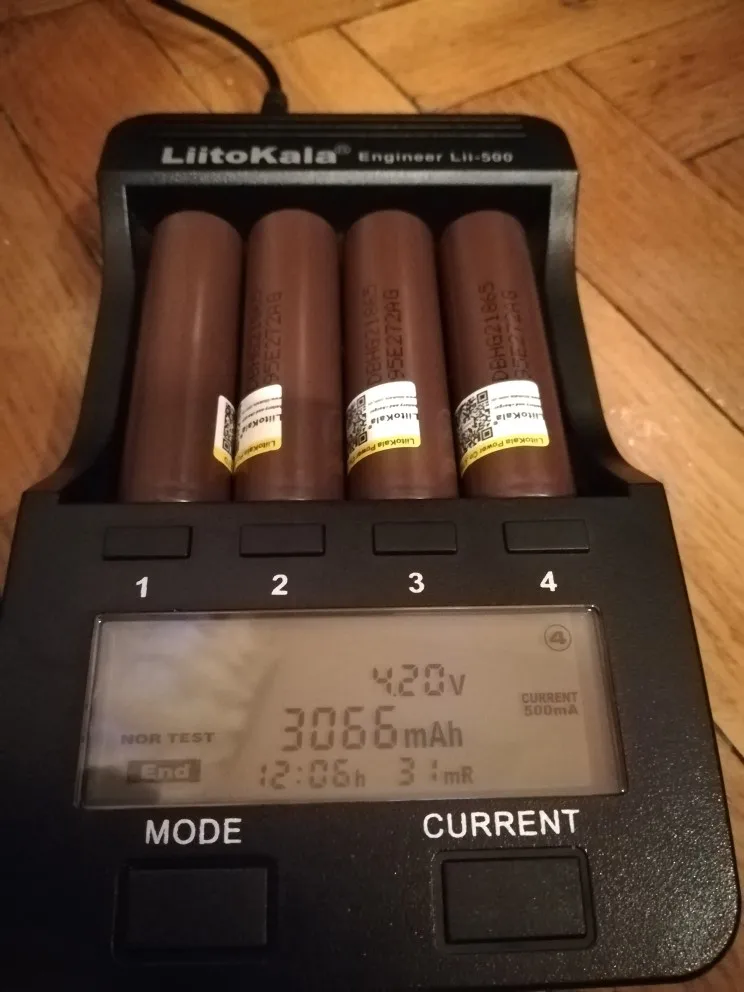

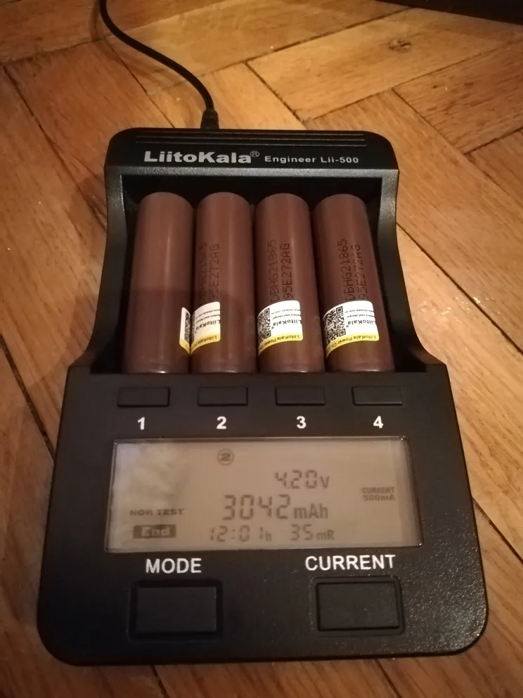

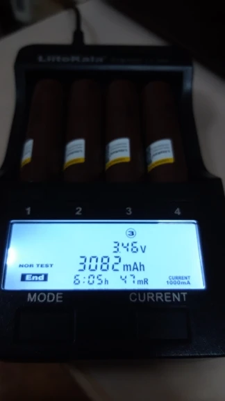

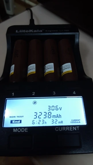

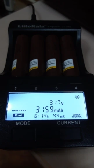

Uhmm just wondering, are these batteries trustworthy?
https://m.aliexpress.com/item/32793701336.html?trace=wwwdetail2mobilesitedetail&spider=y&productId=32793701336&productSubject=6pcs-lot-LiitoKala-LG-HG2-18650-18650-3000mah-electronic-cigarette-Rechargeable-batteries-power-high-discharge-30A
My friend said they are pretty legit cause he has used these type of batteries before for his e-cig so im wondering if i should keep them or refund them
I'll try to avoid being judgmental but, unfortunately, your friend knows jack shit. LiitoKala is known to be making business selling fake batteries, and those cells are 100% fake guaranteed. Check the reviews, but check them well: select “Sort by latest” and look for additional feedback (AliExpress' feedback system encourages quick, badly done reviews with inflated ratings).
I see complaints by recent customers. You can also see this:
Genuine LG HG2 cells will hardly deliver ≈2.9Ah down to 2.8V at 0.5A discharge rate, you can check reviews like this one.
Those cells being sold by LiitoKala as LG HG2s are some kind high capacity, lesser discharge performance cells (maybe own brand LG D2 or F1L cells).
There are trustworthy places to get batteries from if that is what you aim for. Like Aliya's, Lucky's or NKON.
