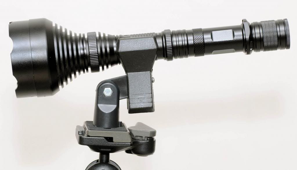

I actually put my lights on a chair, 5 meters from my front door.
I then take the light meter and use the """MAX mode """and move my meter through the hotspot on the door.and the MAX mode means it will measure the MAX lux..memorized that...that's the easiest method for me. That way I'm not moving the flashlight, which would probably result in higher numbers.
why would moving the light give higher numbers than moving the meter?
Because the meter touches the door, and you slide it on the door. Therefore distance won't change. Light stays on the chair..
When you are standing and holding the light, you will change the distance between the light and meter..because your hand and body will move..
Not a big difference, maybe just a few centimeters.. but my method will just be a little more precise..although not the most precise...if you have a special stand for both the meter and flashlight that would probably be even better.
Just sharing my ideas of doing these tests. We are here to learn from each other and share different ways of doing things, that way we are helping others.
If you have your method ,please share maybe someone can copy yours.
in theory there would be “better” ways, but i think your idea gives an optimal way to do that measurement in real world (by non scientific guys ;))
the only thing what comes in my mind ist that the light has to be positioned in a way thyt the beam hits the door in 90° angle
Both my flashlight and my light meter are locked in position. Therefore the distance (measured carefully) does not change.
