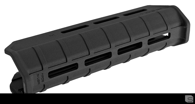

I’m looking for a flashlight that will be mounted to a 12 gauge shotgun forend via Magpul hardware. I broke down my requirements into “must have” and “nice to have” and went to work.

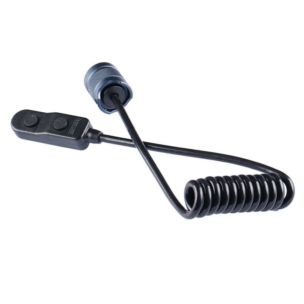

Remote switch for S2+
-Based on a Youtube video for a similar Convoy switch this gives me momentary on, normal on/off, and mode select.
