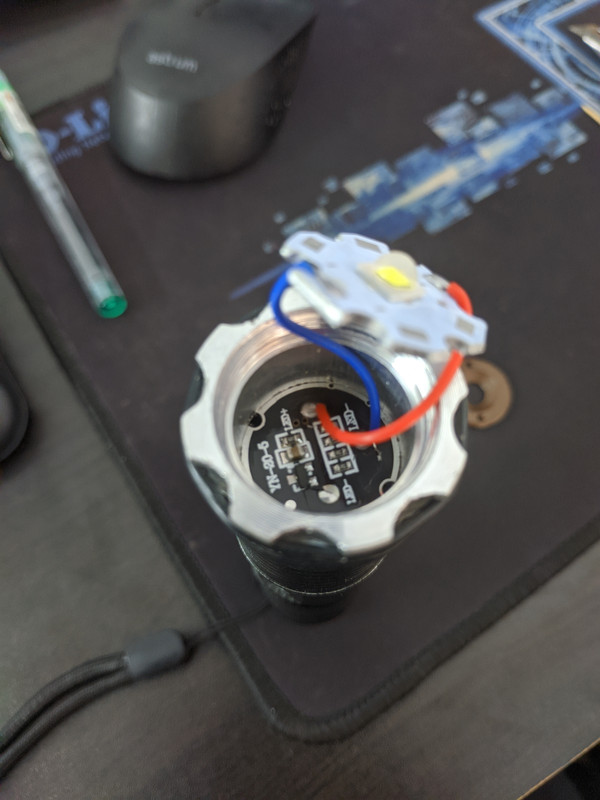

So my question is, which emitters will be compatible with the included driver in the zoomie. My preferences would be: XHP50.2, SST40 or the 219C. Or any other compatible emitter that can be driven by this driver. The driver inside is the YN-20-5 driver
I tried to measure the voltage and current provided by the driver but the pcb started smoking as soon as I touched the probes with the + and -ve terminals on the mcpcb.

The SFT40 is a direct swap as is the XHP50 3V, but the latter will probably give a terrible beam and little throw.
Measuring current directly is indeed not a good idea. The emitter is 3V, amperage likely low enough to allow any LED.
This driver, if I see it correctly, can deliver 500mA peak and 350mA continous.
You may need to change this driver to make use of a good LED.
Look for 17mm without electronic switch.
If the LED is really a XML-L2, you can just change the driver for a little stronger one, maximum 1.3A, to start and see how it turns out, but beware of the heat.
The host is not really capable of dissipating heat, because the outer head is separated from the main part by o-rings, which are needed to make it at least a bit dustproof and waterproof, so stay below 3A current to make the best use out of it, but need to chane the LED, too.

True, the XHP50.2 beam will look horrible in a zoomie. Since the SFT40 will be a direct swap, I’m guessing the SST40 will be a direct swap too. Looks like the best fit for the zoomie.

The driver looks exactly the same as the one I took out of my light.

Lets all not mention that the pill is hollow, so any attempt to drive this at a higher output with another driver/LED is a complete waste of time. Some of those have a solid pill and can be modded, but this one would cook the LED fairly quickly. If you were to just swap the LED and use the driver, it’s fine, but don’t even bother changing the driver. Throw it in the bin or gift it as is.

Ah, I see!
The design of this light now has a hollow pill. The old one I have has a separate non-hollow LED pill to screw into what now looks like not having an inner threads no more. So it has not been removed for the photo, like I first thought.
The driver seems to be still the same.
So the LED star in your light will be sitting on the little ridge and have only thermal contact at the circumference, which is not good, even with a copper star. You may try to press-fit a copper disc or better cut a tread and screw in a copper disc to underfill the LED star, but I really don’t think it’s worth the struggle.

I just modded one of these with a 6A driver and round die led. If you’re going to swap the led and driver, you must improve the heat sinking. Look for my thread on here Swapped
No worries, I should have provided more pictures for clarification. I didn’t even consider the heat issue before I searched through the forum. I dont have access to milling tools so improving the heat sink will be difficult for me.
Wow!! your mod looks great. I was targeting something similar. But now I think giving time and effort to this light will not be worth it. I just did the direct drive mod and I think I will try to use this as a mule light by removing the lens and head completely. The hollow pill screws on directly to the battery segment. I’ll try to give some pics later
