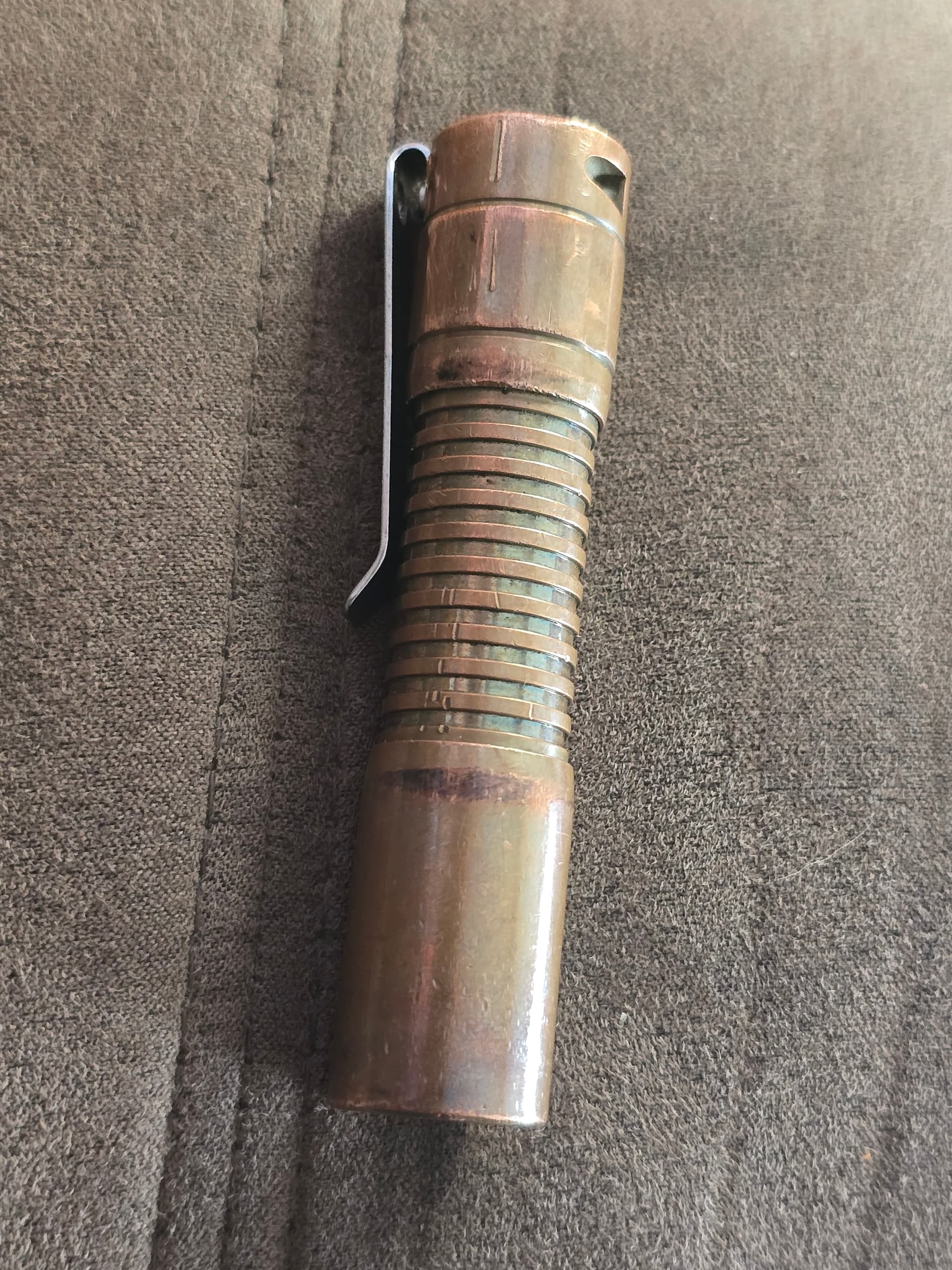

I have a Manker E05 Cu gen1 that I’ve been EDCing for the last 4 years. If they still made this flashlight, id order a handful more just to have as backups.
Recently, my flashlight started lighting up for about 3 seconds, then turning off. From what I can tell, the pads that make contact with the battery host are worn mostly off.
I’d like to modify this light with a new driver, perhaps one that has a moonlight mode, and possibly a new emitter if there are equally good thrower LEDs out there.
What I’m eyeing currently is a SFT-40, and a DrJones H17Fx
https://www.mtnelectronics.com/index.php?route=product/product&product_id=659
Would these be a good combination/ is this led a good thrower, or is there something else you’d recommend?
I ended up ordering a 5 amp driver and a sft25r both off of kaidomain. I’ll report back once modded.
did you get the 90cri sft25r?
No, couldn’t find any in stock
