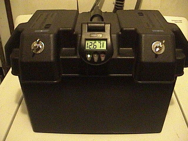

This is an early pic of my 12V Battery Backup Box. It's a standard deep-cycle marine battery box from X-mart. It still has the shown cigarette lighter outlet (in the pic is my voltage indicator for the setup). I have also added 2 sets of wire terminals for accessory hookup (think speaker connectors). The first set is fused 12V off the battery and the 2nd set is 9V using a 7809 Regulator. I have a scanner and several other radios that take 9V input, so this was a logical addition.
The battery is a 12V 26-AH SLA and the terminals on the front of the box are Stainless bolts/washers/etc. I did add a red cap to the positive terminal for easier identification.
I need to take an updated pic or two, but these are super simple to make and really do come in handy for field use, camping trips, and power outages.
I'm using a 30-watt Solar Panel and a 7-Amp charge controller to keep the battery topped off, but I do have a standard car battery charger if needed.
In the event that I would need 120-VAC, I simply connect the 400-Watt Inverter to the terminals using the Inverter's battery clamps. For lighter loads, a cigarette-lighter inverter works well too.
Not fancy, but a fully functional setup.
