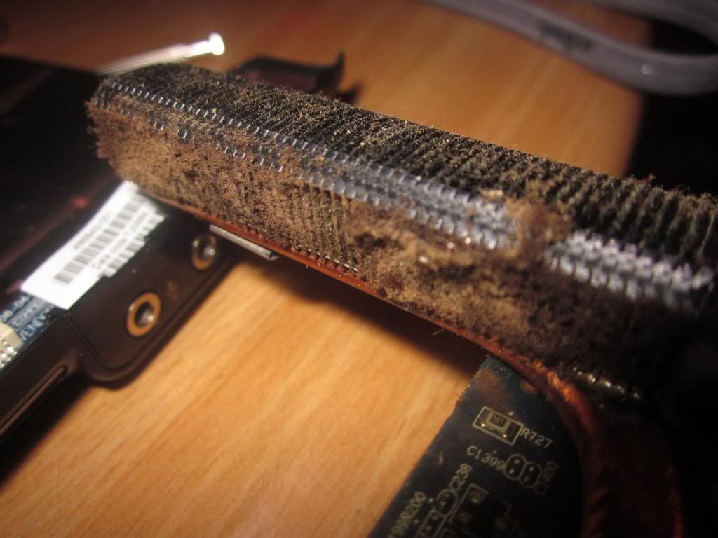

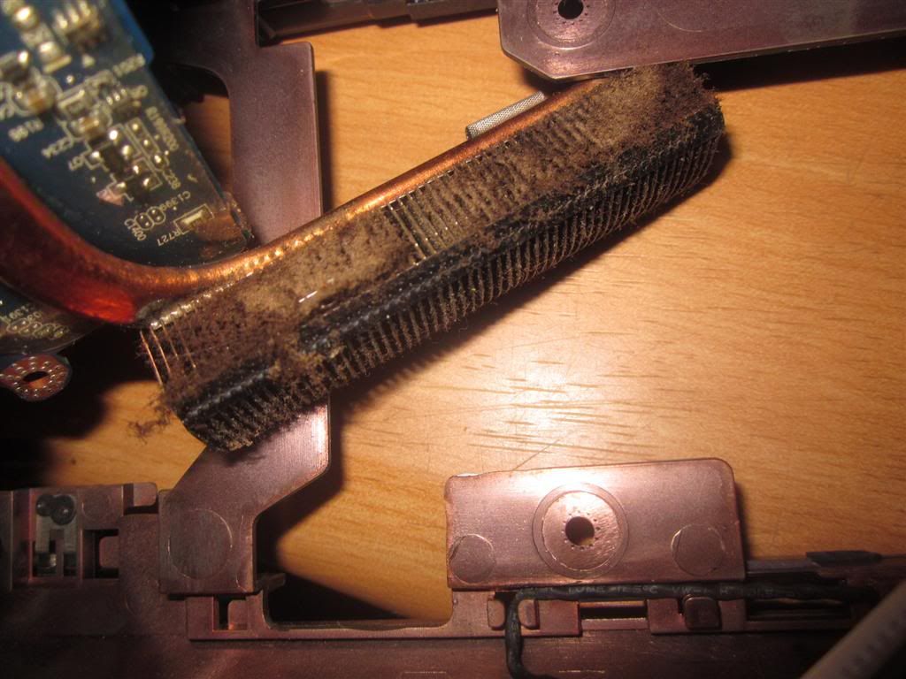

Do you smoke near your cpu fan?
Dust is one thing…tar soaked goo dust is another, blowing it out w/ cig smoke dust might not clean it…it actually took physically scrubbing with a toothbrush to knock alot of the goo loose from this one
WarHawk-AVG is right on the money, tar from tobacco smoke or other ‘smoking materials’ will really gum up cooling fins.

However: “physically scrubbing with a toothbrush” will often drive the goo into inaccessible cracks and corners where it really does NOT need to be. At some point, you have to be willing to bill the customer for new radiators, heat sinks, cooling fans and case plastics; in addition to whatever else died. Tip from experience: a credit card is useful to scrape the goo off an identifying label in order to order the right replacement part. If you must re-use these, and can remove them, Purple Power (or its equivalent) cuts the goo pretty well, even on electronics, providing you rinse and dry them completely before applying power again. I had a friend who, like Racer, worked at home & smoked heavily and constantly. His PCs failed quite regularly only he could never afford to replace them. Hence I figured out how to clean them…
