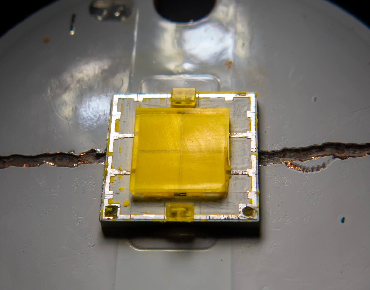

Lexel
(Lexel)
69
XHP70.2 next gen
unfortunately on one side a bit silicone broke off
