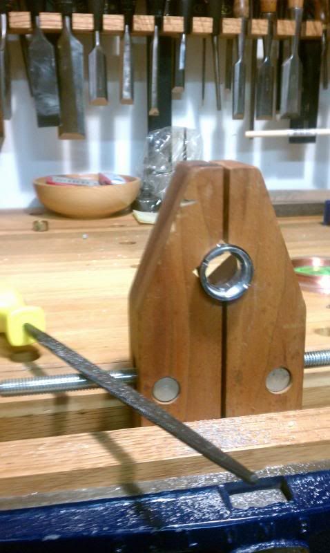

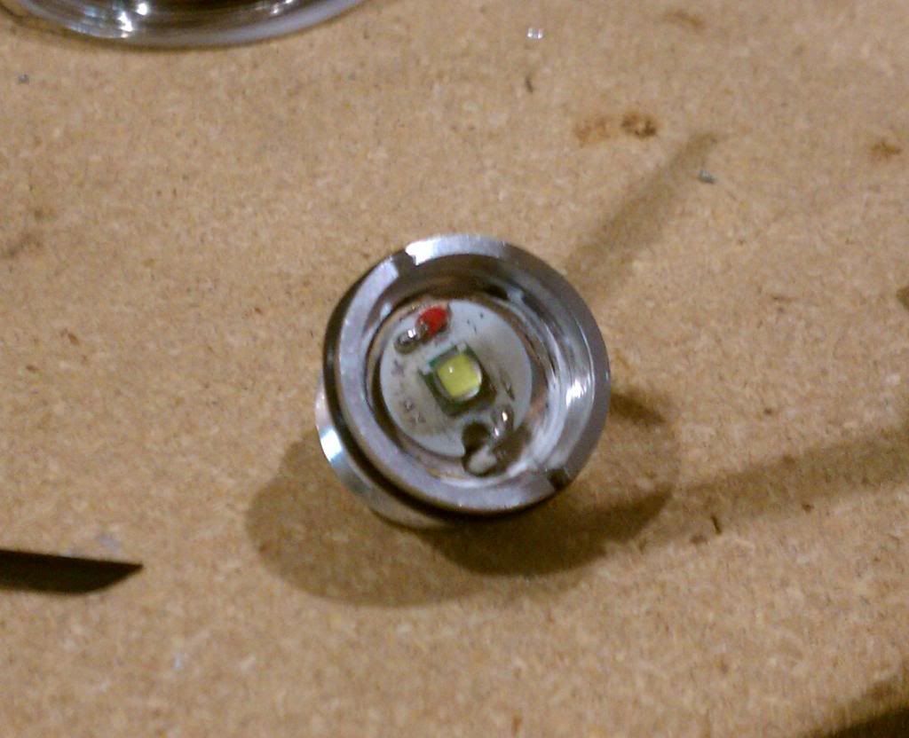

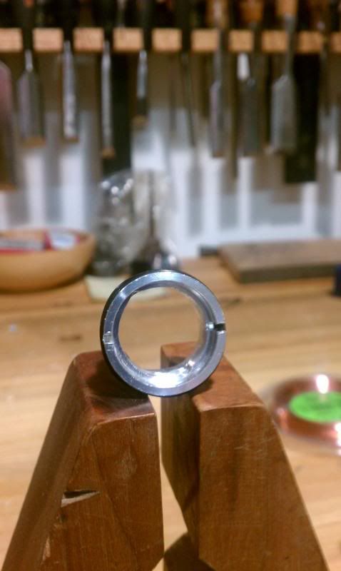

First, I pulled out the hollow pill…there is a lip that the emitter sits on which is easily filed off:

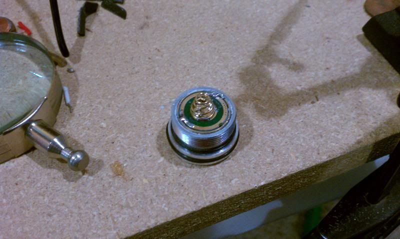

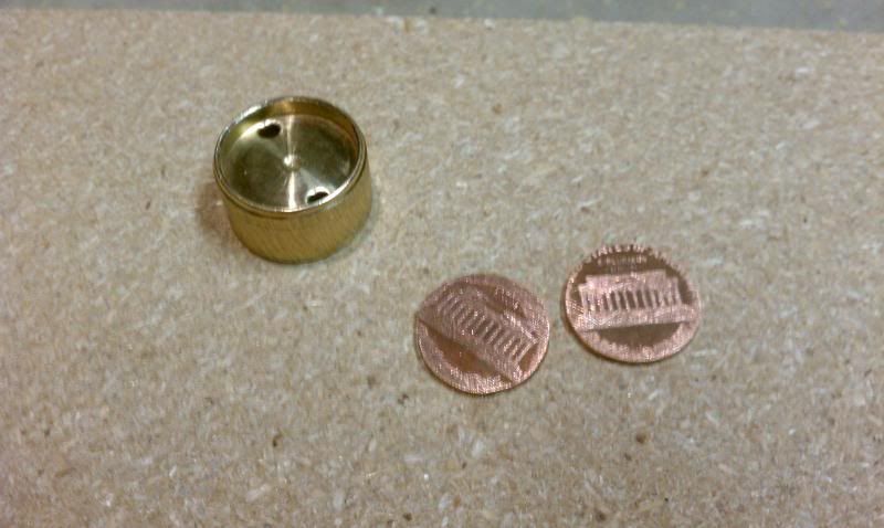

I then filed down a P60 brass pill as i did here :“Lanshi pill” Modding the Lethargic Lanshi LS-125 3xAA ***Beamshots added***

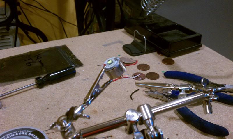

This time I soldered two copper US pennies to fill the pill and bring the surface level with the lip:
I used a Dremel sanding drum in a drill press to clean/square up the inside of the hollow pill, just enough so the brass pill can be forced inside:

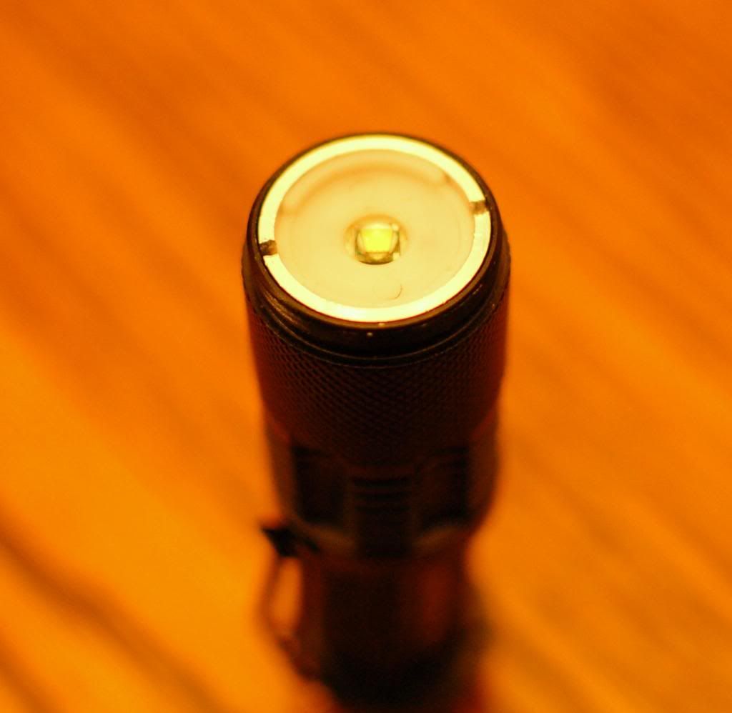

I then glued the brass pill into the hollow pill using Fujik paste…hybrid pill complete!
It’s drawing 1.94A on high and has a super wide flood. Zoomed out, it throws very well…I’ll try it against some of my throwers soon and will add beamshots if anyone is interested. Otherwise, that’s it…short and sweet!
